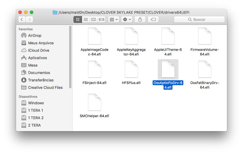

MaLd0n Posted March 15, 2017 Share Posted March 15, 2017 Check ur folder drivers64UEFI try with KernelPM too, many Clover version we need it Link to comment https://www.insanelymac.com/forum/topic/321885-boot-hanging-at-apple-logo/#findComment-2384865 Share on other sites More sharing options...
tarasis Posted March 15, 2017 Author Share Posted March 15, 2017 Tried updating from 39xx to 4035 (manually copying files from the Clover ISO to the EFI folder) but still hangs in the same way.I have been using OsxAptioFix2DrvNo change with KernelPM set. It's not something I've needed previously. (Running 10.12 ATM, Clover docs suggest this is for 10.8.5 and 10.9)Now trying Verbose and Safe Mode together is sometimes causing the computer to reboot.Text on boot: OsxAptioFix2Drv: Starting overrides for \System\Library\CoreServices\boot.efiUsing reloc block: no, hibernate wake: no++++++++++++++++++++++++++++++++++++++ Occasionally you'll see "p" or "pani" and a solid cursor block. So its panicing very early. One of thing of note. While it's sitting on the +'s the fan is getting faster & slower and occasionally I can hear the HD spinning (there are a mix of SSDs and HD's in the computer). -- Edit 1 Tried deleting the kext cache manually. but no change. 1 Link to comment https://www.insanelymac.com/forum/topic/321885-boot-hanging-at-apple-logo/#findComment-2384949 Share on other sites More sharing options...
