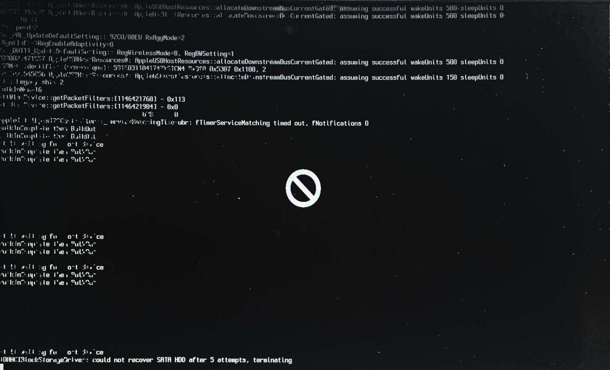

Shocking Posted March 11, 2017 Author Share Posted March 11, 2017 (edited) try it CLOVER.zip Don't working see screenshots attached, I getting the message "Still waiting for root device" I try remove your disable_nv=1 argument, but get the same error. the process that I done in EFI was: zip CLOVER folder and rename the zip to CLOVER.bak.zip; delete CLOVER folder; and lastly paste CLOVER folder that you send me. now I'll try to boot with my config but with disable_nv=1 argument, I'll notice here if it's work. EDIT #1 I notice that I was already booting with this argument, I try to remove the argument in clover menu, and the OSX boot normally, like when I'm using the nv_disable=1 and the graphics have the same behavior with the argument and without it. I'm assuming that the argument isn't giving any effect in OSX for some reason. Edited March 11, 2017 by wesleycguirra 1 Link to comment https://www.insanelymac.com/forum/topic/321722-hackintosh-acer-e5-574g/#findComment-2382557 Share on other sites More sharing options...

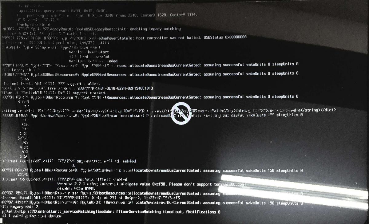

Shocking Posted March 11, 2017 Author Share Posted March 11, 2017 put my DSDT into ur folder Clover/Acpi/Patched test it i think the problem is video, i inject ig-platform-id, etc I tried it, but no success, see the screenshot; I think there's problem with the Intel HD520 graphics driver if you see in the screenshot, it's saying about dependencies after "AppleIntelSKLGraphics" Link to comment https://www.insanelymac.com/forum/topic/321722-hackintosh-acer-e5-574g/#findComment-2382579 Share on other sites More sharing options...
MaLd0n Posted March 11, 2017 Share Posted March 11, 2017 OFC DVMT problem, i think Have a patch for it Link to comment https://www.insanelymac.com/forum/topic/321722-hackintosh-acer-e5-574g/#findComment-2382591 Share on other sites More sharing options...

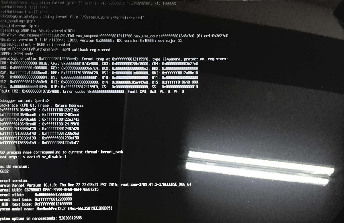

Shocking Posted March 12, 2017 Author Share Posted March 12, 2017 kernel panic again 1 Link to comment https://www.insanelymac.com/forum/topic/321722-hackintosh-acer-e5-574g/#findComment-2382975 Share on other sites More sharing options...

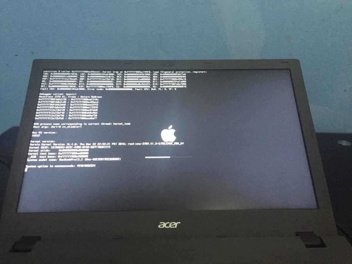

Shocking Posted March 13, 2017 Author Share Posted March 13, 2017 Sorry, I forgot to take a print this time. I try to do the fresh install and still getting this message "Still waiting for root device", after that I deleted the clover folder and put the old again, now graphics acceleration working, audio working, but the brightness still low. I'm not using DSDT, I put it on ACPI/patched, but it gives me a kernel panic. what is KP? 1 Link to comment https://www.insanelymac.com/forum/topic/321722-hackintosh-acer-e5-574g/#findComment-2383505 Share on other sites More sharing options...
MaLd0n Posted March 13, 2017 Share Posted March 13, 2017 kp = kernel panic i need see KP photo for check what patch cause problem 1 Link to comment https://www.insanelymac.com/forum/topic/321722-hackintosh-acer-e5-574g/#findComment-2383511 Share on other sites More sharing options...

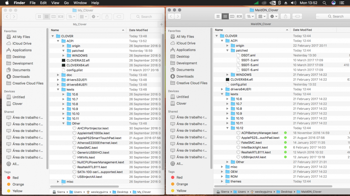

Shocking Posted March 13, 2017 Author Share Posted March 13, 2017 (edited) see the photos below... I also attached print screen of my clover folder and your clover folder. Using your clover folder: Using my clover folder: Enviado do meu iPhone usando Tapatalk Edited October 9 by Phaetherap Link to comment https://www.insanelymac.com/forum/topic/321722-hackintosh-acer-e5-574g/#findComment-2383520 Share on other sites More sharing options...

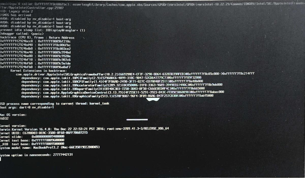

Shocking Posted March 16, 2017 Author Share Posted March 16, 2017 put files in Clover/Acpi/Patched and replace config.plist wesleycguirra.zip try it tried to put in my working clover folder get this error (KP) tried a fresh install and copy files to clover get this error Link to comment https://www.insanelymac.com/forum/topic/321722-hackintosh-acer-e5-574g/#findComment-2385491 Share on other sites More sharing options...
MaLd0n Posted March 16, 2017 Share Posted March 16, 2017 is a video problem, use ig-platform-id intelhd520 config.plist.zip run it Olarila.command.zip reboot 1 Link to comment https://www.insanelymac.com/forum/topic/321722-hackintosh-acer-e5-574g/#findComment-2385519 Share on other sites More sharing options...
