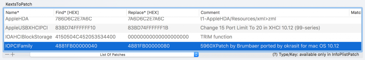

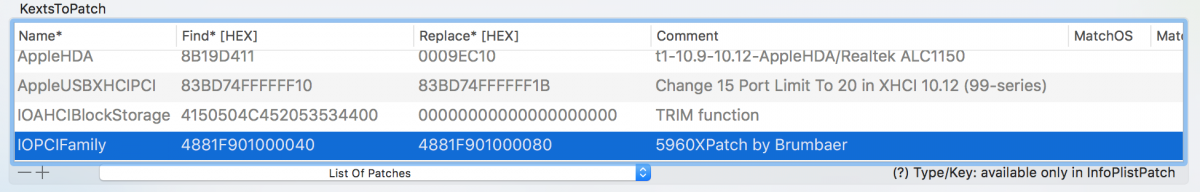

rafamundez Posted March 1, 2017 Share Posted March 1, 2017 Have you patched your iopcifamilykext? Hi @okrasit, are you talking about @Brumbaer's patch as seen below? Link to comment https://www.insanelymac.com/forum/topic/321407-x99-sierra-installation-problem/#findComment-2375868 Share on other sites More sharing options...
okrasit Posted March 1, 2017 Share Posted March 1, 2017 Hi @okrasit, are you talking about @Brumbaer's patch as seen below? Screen Shot 2017-03-01 at 12.15.51 PM.png Yes! That one is for ElCapitan. Is that what you're trying to get to boot? Link to comment https://www.insanelymac.com/forum/topic/321407-x99-sierra-installation-problem/#findComment-2375876 Share on other sites More sharing options...
rafamundez Posted March 1, 2017 Share Posted March 1, 2017 Yes! That one is for ElCapitan. Is that what you're trying to get to boot? Oh shoot, I've been trying to boot macOS Sierra . Is there an updated one for Sierra? Link to comment https://www.insanelymac.com/forum/topic/321407-x99-sierra-installation-problem/#findComment-2375877 Share on other sites More sharing options...
okrasit Posted March 1, 2017 Share Posted March 1, 2017 Oh shoot, I've been trying to boot macOS Sierra . Is there an updated one for Sierra? omg... can't u ppl read. #1 Link to comment https://www.insanelymac.com/forum/topic/321407-x99-sierra-installation-problem/#findComment-2375880 Share on other sites More sharing options...

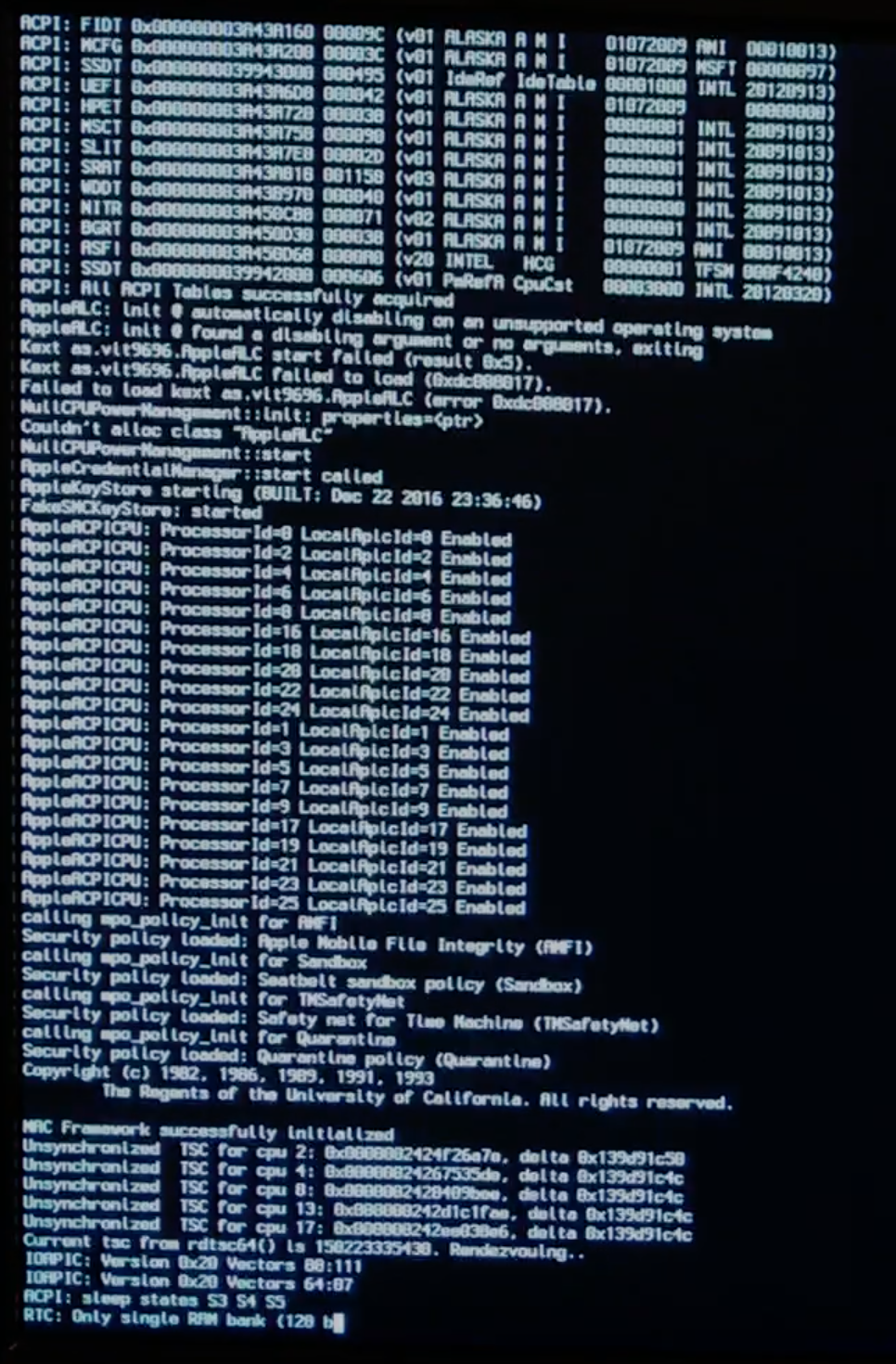

rafamundez Posted March 2, 2017 Share Posted March 2, 2017 Update: After patching the IOPCIFamily.kext, it makes it to: " RTC: Only single RAM bank (128 b " before hanging for a second then rebooting. Any ideas what to do from here on out? Screenshot below. Link to comment https://www.insanelymac.com/forum/topic/321407-x99-sierra-installation-problem/#findComment-2376080 Share on other sites More sharing options...
mfc88 Posted March 2, 2017 Share Posted March 2, 2017 Update: After patching the IOPCIFamily.kext, it makes it to: " RTC: Only single RAM bank (128 b " before hanging for a second then rebooting. Any ideas what to do from here on out? Screenshot below. Screen Shot 2017-03-01 at 8.55.41 PM.png I'm assuming you're using a Gigabyte board? If so, add AppleRTC patch in config.plist "KernelAndKextsToPatch" (it'll be right above the "KextsToPatch" column, just use the AppleRTC's checkbox) Also, I JUST switched to a 6950x and the only way I could get it to work (get past the PCI Configuration) was to use USBInjectAll.kext + X99-XHCI-Injector.kext. I also placed my installer usb into a 2.0 port. I had problems when I tried to use a 3.0 port (could be Clover issue). Link to comment https://www.insanelymac.com/forum/topic/321407-x99-sierra-installation-problem/#findComment-2376102 Share on other sites More sharing options...
rafamundez Posted March 2, 2017 Share Posted March 2, 2017 I'm assuming you're using a Gigabyte board? If so, add AppleRTC patch in config.plist "KernelAndKextsToPatch" (it'll be right above the "KextsToPatch" column, just use the AppleRTC's checkbox) Also, I JUST switched to a 6950x and the only way I could get it to work (get past the PCI Configuration) was to use USBInjectAll.kext + X99-XHCI-Injector.kext. I also placed my installer usb into a 2.0 port. I had problems when I tried to use a 3.0 port (could be Clover issue). I have an MSI X99A Gaming Pro Carbon motherboard but I do have the AppleRTC box checked so unfortunately that won't help, I will try it unchecked as well too. I will try the USBInjectAll.kext and the X99-XHCI-Injector.kext and I can report back tonight. But yeah, I've been using a USB 2.0 port almost always:) Link to comment https://www.insanelymac.com/forum/topic/321407-x99-sierra-installation-problem/#findComment-2376734 Share on other sites More sharing options...
