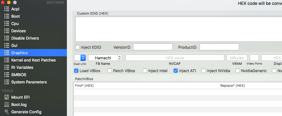

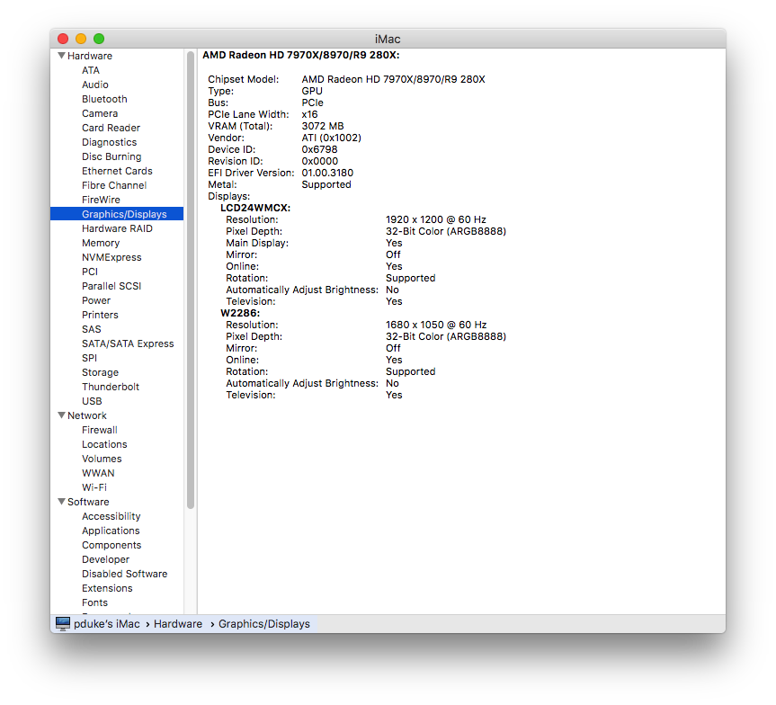

pduke Posted March 3, 2017 Author Share Posted March 3, 2017 and finally it is working!! it was under my nose all the time. it seems that the stock rom is incompatible but not all XFX roms. so after testing here is what is worked (for my card at least) - DD Black Edition https://www.techpowerup.com/vgabios/148939/xfx-r9280x-3072-131026(1080Mhz memory clock) - DD https://www.techpowerup.com/vgabios/147218/xfx-r9280x-3072-130926(1000Mhz memory clock) - Nearly every Asus, Sapphire and Gigabyte 280X rom from the same site (150Mhz memory clock!!!! > Ultra energy efficient (!!) but poor performance. Not bad though for simple everyday tasks) Clover : 1. FB Name = Hamachi 2. tick Load VBios 3. tick Inject ATI In EFI : download one of the above Roms, rename it to 1002_6798.rom and place it at CLOVER/ROM/1002_6798.rom. (I keep the ASUS Rom as backup) attaching screenshots. so only turbo boost for me to solve! and my Mac is kicking asses!!! Link to comment https://www.insanelymac.com/forum/topic/321342-xfx-280x-working-but-at-more-than-half-fps-no-power/#findComment-2376987 Share on other sites More sharing options...
