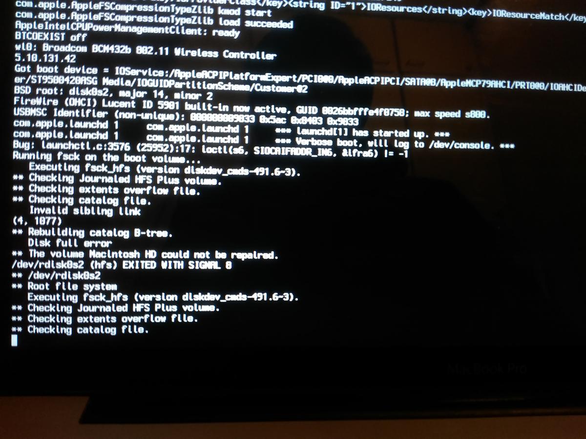

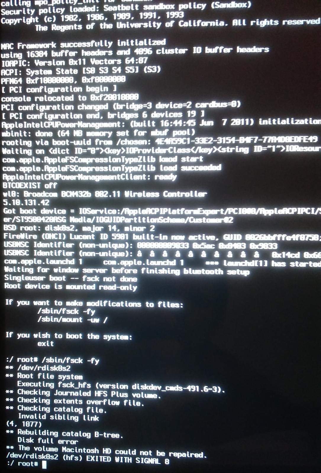

Pierre239 Posted February 16, 2017 Share Posted February 16, 2017 Hi there, After looking among a lot of forums, and topics and during several weeks, I cannot find a way to solve my issue with my MacBook Pro. I have a MacBook Pro pro from 2009, and as a student, I can't afford to bring it to an Apple shop. Plus I always love to learn how to fix stuffs by myself, so I definitely want to do this !! I will try to explain my issue as brief and accurately as possible. Description of the issue : Either I get a white screen and it is stuck or I get a loading bar, and it switch off when reaching 20 %. I ran the single user mode, and I can see “Invalid siblink link (4, 1877). I tried to repair my disk with the fsck command : it gives me «disk full error ». In attachement, I put some screen-shots of the command lines. What triggered the problem ? As my battery is dead, my charging cable removed itself 4 times in a row. When I tried to start my laptop the 5th times: it remains stuck on a white screen. Last but not least, my hard drive contains a partition with windows XP. When I boot on the windows partition (by pressing down the 'alt' key), the laptop works fine, everything is normal !! Please help me to solve this, I am running out of ideas !! Thank you so much in advance ! Cheers, Pierre Link to comment https://www.insanelymac.com/forum/topic/321225-white-screen-full-disk-error/ Share on other sites More sharing options...

MaLd0n Posted February 17, 2017 Share Posted February 17, 2017 mac have a repair, u can try in single user -s in hackintosh and command s in macintosh fsck_hfs -r /dev/disk0s2 ur disk and ur partition with mac os Link to comment https://www.insanelymac.com/forum/topic/321225-white-screen-full-disk-error/#findComment-2369175 Share on other sites More sharing options...
Pierre239 Posted February 17, 2017 Author Share Posted February 17, 2017 All right, thank you for your help. I'm out of home for the weekend, so I'll try this monday evening ! I'll let you know Link to comment https://www.insanelymac.com/forum/topic/321225-white-screen-full-disk-error/#findComment-2369240 Share on other sites More sharing options...
Pierre239 Posted February 21, 2017 Author Share Posted February 21, 2017 I have tried the command fsck_hfs -r /dev/disk0s2. But it doesn't work. I am trying to find another solution. Any other ideas ? Like another disk utility software that is for free ? 1 Link to comment https://www.insanelymac.com/forum/topic/321225-white-screen-full-disk-error/#findComment-2370737 Share on other sites More sharing options...

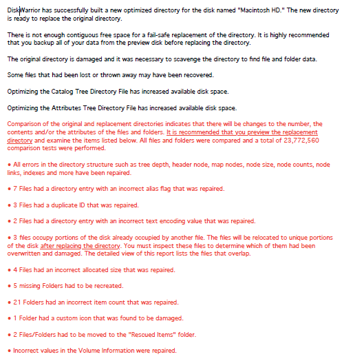

Pierre239 Posted April 11, 2017 Author Share Posted April 11, 2017 Hi there, I finally succeed to solve my issue. I will briefly explain how I did, it could help some users with the same issue. Using a MacBook with a CD-reader (another MacBook than mine), I created a disk image of the original installation CD of Mac OS provided with my MacBook (the grey CD). I copied this disk image on a bootable USB flash drive. I pluged an external hard drive to my MacBook, as well as the USB flash drive containing the copy of Mac OS. I then boot my laptop while pressing the 'alt' key. I choose to boot on the Mac OS image. Then, just follow the steps to instal the OS system on the external hard drive. Then, re-boot your laptop while pressing the 'alt' key. Choose to boot on the external hard drive. Then, you now have a working Mac OS environment. So, instal DiskWarrior on it (I found a version of DiskWarrior online). And now, you can use DiskWarrior to repair your internal hard drive. It took a long time to process. In attachment, you can see an example of the report from DiskWarrior. After that, I was able to reboot on my internal hard drive ! Everything works fine !! So thank you again for your help, MaLdOn ! The topic can be written as solved ! 1 Link to comment https://www.insanelymac.com/forum/topic/321225-white-screen-full-disk-error/#findComment-2402216 Share on other sites More sharing options...

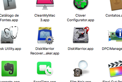

MaLd0n Posted April 11, 2017 Share Posted April 11, 2017 Ohhh, good! Have a DiskWarrior Recovery Maker.app, create a bootable USB stick, very fast! Work in Macs and Hacks. Save my life in many times! Enjoy! 1 Link to comment https://www.insanelymac.com/forum/topic/321225-white-screen-full-disk-error/#findComment-2402351 Share on other sites More sharing options...
