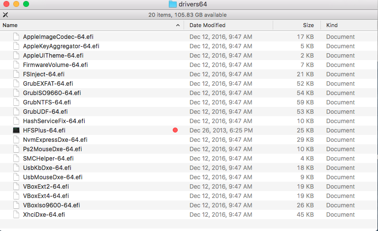

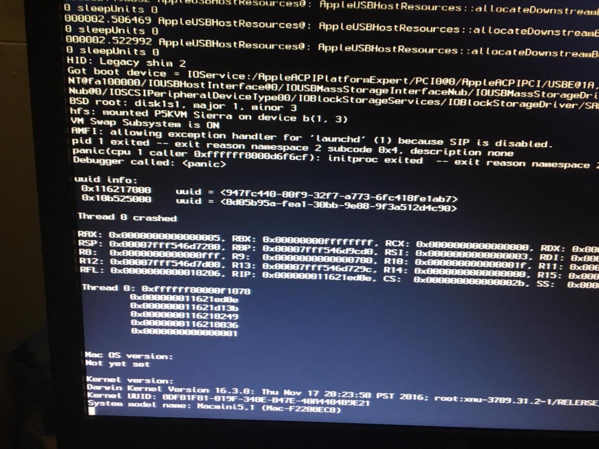

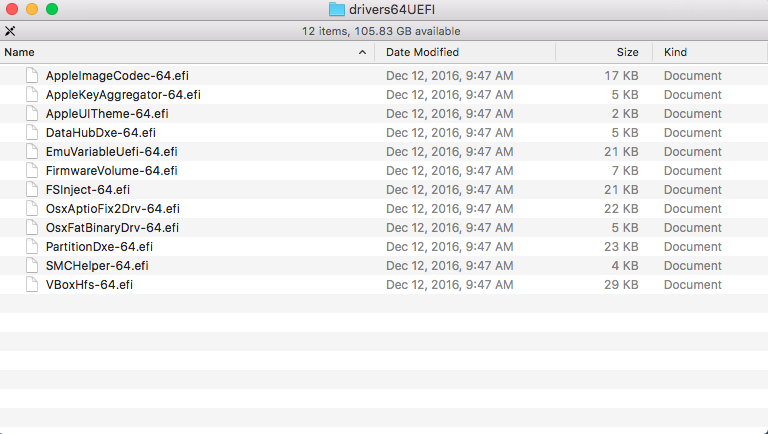

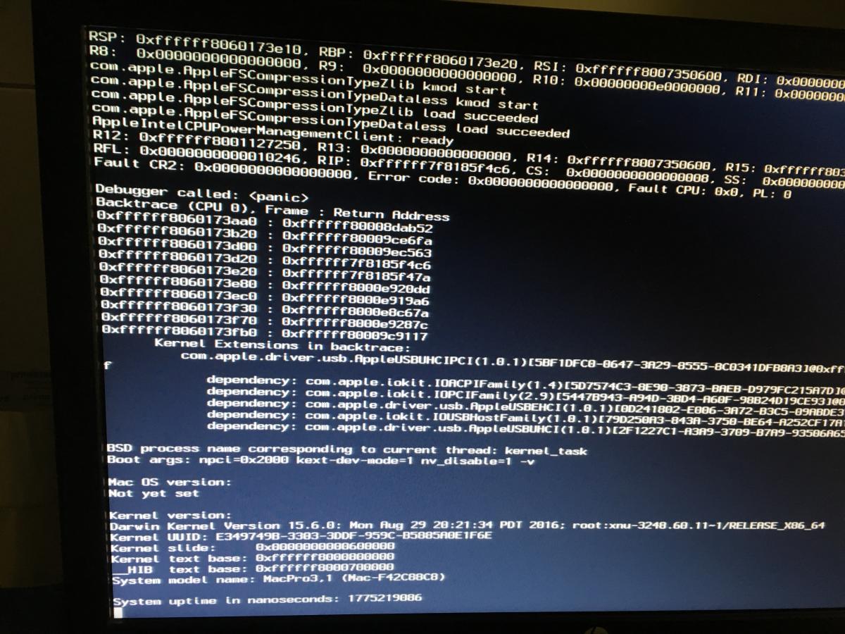

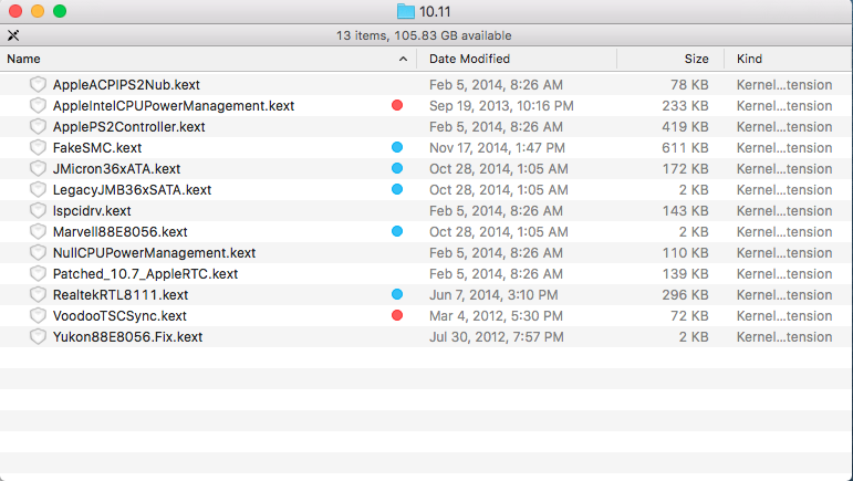

macattackjack Posted February 11, 2017 Share Posted February 11, 2017 (edited) I have a beloved P5k-VM that I am trying to get 10.12.2 to work on.I have a EVGA 520 video card, 2 gig of ram, a 1.8 core 2 duo. 120GB PNY XLR8 SSD I have a version of 1011.6 that works. I installed it UEFI on a Asus X79 Sabertooth, then used SuperDuper to copy another drive, and used Clover to do a Legacy install. Turning on all the drivers, it worked.I after doing the same procedure with 10.12.2, it has run into some issues.First it was freezing at the Clover ++++++++++++++++++++++++++ display.I turned KernalCPU to true, and that allowed the boot to continue, But then I got a kernel panic. I removed APPLEHPET.kext (which I needed to do for this motherboard since 10.6.4 to get USB to work properly) but then I get a UUID Kernal panic. I've looked at various places on the web on how to fix this for ichat and other things, but entering a new SystemUUID number in my config file doesn't solve the problemBelow are my screen captures, config file and images of the drivers I have installed.This first image is of the kernel panic when APPLEHPET was installed, the second when it was removed and I get the UUID kernel panic where I stand now. If you notice there are a number of USB errors. I suspect this might be a USB problem that is affecting the UUID, just because of other experiences I've had, but can't say for sure.Any Thoughts? Thanks in advance with true<?xml version="1.0" encoding="UTF-8"?> <!DOCTYPE plist PUBLIC "-//Apple//DTD PLIST 1.0//EN" "http://www.apple.com/DTDs/PropertyList-1.0.dtd"> <plist version="1.0"> <dict> <key>ACPI</key> <dict> <key>DSDT</key> <dict> <key>Debug</key> <false/> <key>DropOEM_DSM</key> <false/> <key>Fixes</key> <dict> <key>AddDTGP_0001</key> <true/> <key>AddHDMI_8000000</key> <true/> <key>AddIMEI_80000</key> <true/> <key>AddMCHC_0008</key> <true/> <key>AddPNLF_1000000</key> <true/> <key>DeleteUnused_400000</key> <true/> <key>FIX_ACST_4000000</key> <true/> <key>FIX_ADP1_800000</key> <true/> <key>FIX_INTELGFX_100000</key> <true/> <key>FIX_RTC_20000</key> <true/> <key>FIX_S3D_2000000</key> <true/> <key>FIX_TMR_40000</key> <true/> <key>FIX_WAK_200000</key> <true/> <key>FakeLPC_0020</key> <true/> <key>FixAirport_4000</key> <true/> <key>FixDarwin_0002</key> <true/> <key>FixDisplay_0100</key> <true/> <key>FixFirewire_0800</key> <true/> <key>FixHDA_8000</key> <true/> <key>FixHPET_0010</key> <true/> <key>FixIDE_0200</key> <true/> <key>FixIPIC_0040</key> <true/> <key>FixLAN_2000</key> <true/> <key>FixRegions_10000000</key> <true/> <key>FixSATA_0400</key> <true/> <key>FixSBUS_0080</key> <true/> <key>FixShutdown_0004</key> <true/> <key>FixUSB_1000</key> <true/> <key>NewWay_80000000</key> <true/> </dict> <key>Name</key> <string>DSDT.aml</string> <key>ReuseFFFF</key> <false/> </dict> <key>DropTables</key> <array> <dict> <key>Signature</key> <string>DMAR</string> </dict> <dict> <key>Signature</key> <string>SSDT</string> <key>TableId</key> <string>CpuPm</string> </dict> <dict> <key>Signature</key> <string>SSDT</string> <key>TableId</key> <string>Cpu0Ist</string> </dict> </array> <key>HaltEnabler</key> <true/> <key>SSDT</key> <dict> <key>DropOem</key> <false/> <key>Generate</key> <true/> </dict> </dict> <key>Boot</key> <dict> <key>Arguments</key> <string>-v nvda_drv=1 kext-dev-mode=1 rootless=0 GraphicsEnabler=Yes IPGEnabler=No</string> <key>Debug</key> <false/> <key>DefaultLoader</key> <string>boot.efi</string> <key>DefaultVolume</key> <string>Mac HDD</string> <key>Legacy</key> <string>PBR</string> <key>Secure</key> <false/> <key>Timeout</key> <integer>5</integer> <key>XMPDetection</key> <false/> </dict> <key>CPU</key> <dict> <key>UseARTFrequency</key> <false/> </dict> <key>Devices</key> <dict> <key>Audio</key> <dict> <key>Inject</key> <string>7</string> <key>ResetHDA</key> <true/> </dict> <key>USB</key> <dict> <key>AddClockID</key> <true/> <key>FixOwnership</key> <true/> <key>Inject</key> <true/> </dict> </dict> <key>GUI</key> <dict> <key>Hide</key> <array> <string>BOOTX64.EFI</string> <string>Windows</string> </array> <key>Language</key> <string>en:0</string> <key>Mouse</key> <dict> <key>DoubleClick</key> <integer>500</integer> <key>Enabled</key> <true/> <key>Mirror</key> <false/> <key>Speed</key> <integer>8</integer> </dict> <key>Scan</key> <dict> <key>Entries</key> <true/> <key>Legacy</key> <true/> <key>Linux</key> <false/> <key>Tool</key> <true/> </dict> <key>Theme</key> <string>embedded</string> </dict> <key>Graphics</key> <dict> <key>Inject</key> <dict> <key>ATI</key> <false/> <key>Intel</key> <false/> <key>NVidia</key> <true/> </dict> <key>NvidiaSingle</key> <false/> </dict> <key>KernelAndKextPatches</key> <dict> <key>AppleRTC</key> <true/> <key>AsusAICPUPM</key> <false/> <key>Debug</key> <false/> <key>DellSMBIOSPatch</key> <false/> <key>KernelCpu</key> <true/> <key>KernelHaswellE</key> <false/> <key>KernelLapic</key> <false/> <key>KernelPm</key> <false/> <key>KextsToPatch</key> <array> <dict> <key>Comment</key> <string>Expect 4 matches</string> <key>Disabled</key> <false/> <key>Find</key> <data> hAjsEA== </data> <key>Name</key> <string>AppleHDA</string> <key>Replace</key> <data> AAAAAA== </data> </dict> <dict> <key>Comment</key> <string>Expect 4 matches</string> <key>Disabled</key> <false/> <key>Find</key> <data> hQjsEA== </data> <key>Name</key> <string>AppleHDA</string> <key>Replace</key> <data> gwjsEA== </data> </dict> </array> </dict> <key>RtVariables</key> <dict> <key>BooterConfig</key> <string>0x28</string> <key>CsrActiveConfig</key> <string>0x67</string> <key>MLB</key> <string>C02032109R5DC771H</string> <key>ROM</key> <string>UseMacAddr0</string> </dict> <key>SMBIOS</key> <dict> <key>BiosReleaseDate</key> <string>07/02/07</string> <key>BiosVendor</key> <string>Apple Inc.</string> <key>BiosVersion</key> <string>MP21.88Z.007F.B06.0707021348</string> <key>Board-ID</key> <string>Mac-F4208DC8</string> <key>BoardManufacturer</key> <string>Apple Inc.</string> <key>BoardSerialNumber</key> <string>G8815052XYL1375A</string> <key>BoardType</key> <integer>11</integer> <key>ChassisAssetTag</key> <string>Pro-Enclosure</string> <key>ChassisManufacturer</key> <string>Apple Inc.</string> <key>ChassisType</key> <string>0x06</string> <key>Family</key> <string>Mac Pro</string> <key>LocationInChassis</key> <string>Part Component</string> <key>Manufacturer</key> <string>Apple Inc.</string> <key>ProductName</key> <string>MacPro2,1</string> <key>SerialNumber</key> <string>G8815052XYL</string> <key>SmUUID</key> <string>14575229-B561-41AA-894A-E56A128C0433</string> <key>Trust</key> <false/> <key>Version</key> <string>1.0</string> </dict> <key>SystemParameters</key> <dict> <key>InjectKexts</key> <string>Yes</string> <key>InjectSystemID</key> <true/> </dict> </dict> </plist> Edited February 11, 2017 by Allan Spoiler code added Link to comment https://www.insanelymac.com/forum/topic/321072-systemid-uuid-issues/ Share on other sites More sharing options...
