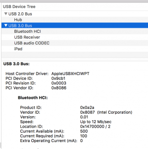

xrnc Posted January 25, 2017 Share Posted January 25, 2017 I have an Intel NUC i7 RYH running as a Macbook Pro 12,1 via clover. Originally installed El Cap, and everything worked fine except the unsupported wifi/bluetooth embedded in the NUC's mobo, which was fine, whatever. But on the first release of Sierra Apple mistakenly threw us a bone! The included bluetooth worked, but not the wifi which is still unsupported. I happily used the integral bluetooth until the first update to Sierra came along, and bluetooth mysteriously disappeared. I just updated to 10.12.3 and it's still gone from the settings menu. I made a Ubuntu bootstick to verify that it wasn't a hardware problem, and all of my devices do in fact sync up just fine under Ubuntu. Here's the output of the console in regard to blued. http://pastebin.com/LG5MEuKB And my USB device list showing the identified bluetooth controller is attached. As of these last two updates I get "no information found" in the bluetooth system report and the bluetooth menu item is greyed out, showing "not available". Anyone got any ideas? Link to comment https://www.insanelymac.com/forum/topic/320546-lost-bluetooth-from-sierra-1-to-2-and-3/ Share on other sites More sharing options...
JahStories Posted January 25, 2017 Share Posted January 25, 2017 This intel b/t needs fw injected to work, you can use a virtual machine with ubuntu to inject it, then it will work on macOS too... but you have to do this every time you reboot Link to comment https://www.insanelymac.com/forum/topic/320546-lost-bluetooth-from-sierra-1-to-2-and-3/#findComment-2357082 Share on other sites More sharing options...
xrnc Posted January 25, 2017 Author Share Posted January 25, 2017 That doesn't explain why it worked OOB with the upgrade from El Cap to Sierra, though... And then suddenly stopped. This might, though. https://www.virtualbox.org/ticket/15081 I am doing a fresh install of Sierra and will install the virtual box version from that thread that is reported to have no Bluetooth issues, will report back. Link to comment https://www.insanelymac.com/forum/topic/320546-lost-bluetooth-from-sierra-1-to-2-and-3/#findComment-2357165 Share on other sites More sharing options...
