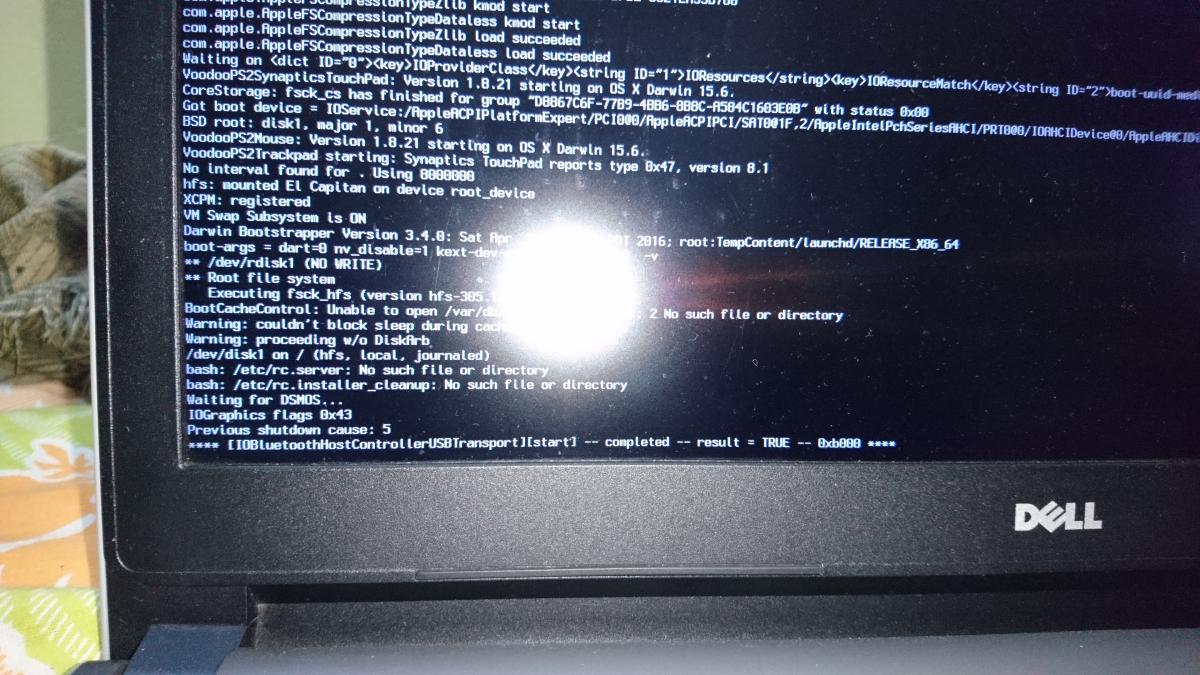

piratefrank Posted January 23, 2017 Share Posted January 23, 2017 System Specs:Model: Dell Inspiron 5558CPU: Core i7 5500URAM: 16GBGraphics: nVidia 920M (which is disabled by nv_disable=1 boot argument) / Intel HD5500Problem:I was able to install El Capitan on my system using Rehabman's config.plist for HD5500. I had to disable inject intel in order to get the installer up and running. I know I can't get full qe/ci support without proper ig-platform-id (which is defined in the plist provided by Rehabman's). But when I inject ig-platform-id the system keeps rebooting right after the following message: Waiting for DSMOS... IOGraphics flags 0x43 Previous shutdown cause: 5 **** [IOBluetoothHostControllerUSBTransport][start] -- completed -- result = TRUE -- 0xb000 *** (Screenshot attached) Link to comment https://www.insanelymac.com/forum/topic/320426-el-capitan-intel-hd5500-graphics-not-working-in-dell-inspiron-5558-core-i7-5500u/ Share on other sites More sharing options...
piratefrank Posted January 23, 2017 Author Share Posted January 23, 2017 With Broadwell graphics, you need to adjust DVMT for video memory. This can be done by patching the BDW framebuffer or modding your BIOS. Thanks for the quick reply. I don't know how to mod BIOS and I'm also afraid that it'll affect my warranty. Trying BDW framebuffer patch and will update you soon. UPDATE: @Hervé Thanks a lot, patching BDW framebuffer worked for me. The following patch was already available in the Rehabman's config.plist. Name=AppleIntelBDWGraphicsFramebuffer, Find=4139C4763E, Replace=4139C4EB3E I enabled it and it worked like a charm. Once again many many thanks. Link to comment https://www.insanelymac.com/forum/topic/320426-el-capitan-intel-hd5500-graphics-not-working-in-dell-inspiron-5558-core-i7-5500u/#findComment-2355158 Share on other sites More sharing options...
