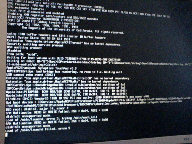

JustAnotherIdiot Posted November 3, 2006 Share Posted November 3, 2006 ok I am sorry if I sound very stupid but i've searched the forum and coudn't find anything related to my problem well I've download the JaS 10.4.6 and have somewhere around 22 GB of unallocated space in my hard drive when I insert the dvd inside to boot the system boots and then takes me to the gray screen with the apple logo and loading animation then nothing else it gets stuck there I tried it again but this time with F8 to check what is going on the screen goes around with lots of checks and then gets stuck with something saying SA Multimedia: Read or Write failed, ASC = 0X64, ASCQ =0X00 disk1s3: unsupported mode. Load of /sbin/launchd failed, errno 5 I can assume its talking about my DVD drive (can only assume) but what seems to be the solution :S as m completely new to OS so hv no clue whats so ever :S i'll really appreciate the help from anyone here TIA Link to comment https://www.insanelymac.com/forum/topic/32012-disk1s3-unsupported-mode/ Share on other sites More sharing options...

JustAnotherIdiot Posted November 3, 2006 Author Share Posted November 3, 2006 here is the screenshot Thanks on the track to reburn at 2x will let u guys know the outcome Link to comment https://www.insanelymac.com/forum/topic/32012-disk1s3-unsupported-mode/#findComment-224163 Share on other sites More sharing options...
JustAnotherIdiot Posted November 3, 2006 Author Share Posted November 3, 2006 Reburning the CD with less speed worked well still installing installer wouldnt show me the disk drive but i made my own partitions with Utilities>>Disk Utility checkin the DVD at the moment will let u know abt more Link to comment https://www.insanelymac.com/forum/topic/32012-disk1s3-unsupported-mode/#findComment-224185 Share on other sites More sharing options...
