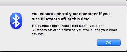

iceage2609 Posted January 8, 2017 Share Posted January 8, 2017 It was the first time since my first Hackinotsh installation in 10.5.8 with chameleon that i used a different bootloader and after 2-3 times and some errors i managed to boot with Clover in my new Samsung SSD disk. Trim enabled with sudo trimforce enable I did some fixes in the config.plist and the NVDSstartup kext for my GTX 285 Nvidia to work, toleda audio injection for the audio and MLB guide for imessages.Wifi - bluetooth - RAM etc all work just fine.I used my old DSDT.aml from the chameleon Yosemite installation. Another issue was the time from b1f:init 5 etc till the boot selection screen shows,that it was about 20 or more seconds.Installing Clover with BiosBlockIO option greatly reduced the time to 2 seconds!! Airdrop works as well but handoff no.In general tab handoff is enabled but i can't make it work with my iphone :-( I don't know why... (Bluetooth Low Energy Supported: Yes --- Handoff Supported: Yes ) Does anyone have a clue about that ? Another issue that come up is that i can't turn off my bluetooth. Does anyone face this very same error ? Link to comment https://www.insanelymac.com/forum/topic/320021-sucess-installation-sierra-in-ga-ex58-ud3r-rev10/ Share on other sites More sharing options...

iceage2609 Posted January 17, 2017 Author Share Posted January 17, 2017 Just as a feedback,the last 2 issues i mentioned were fixed. The Handoff not working had to do with my wifi card. It was ON but not connected to the right DNS. The bluetooth issue is really strange.I have been reading the past few days some reports from sierra users that they can not turn the bluetooth off and the solution that worked as it did for me is to connect a usb keyboard or mouse. So i bought a cheap usb mouse connected it and that's it. I can now turn off and on the bluetooth switch. Link to comment https://www.insanelymac.com/forum/topic/320021-sucess-installation-sierra-in-ga-ex58-ud3r-rev10/#findComment-2351555 Share on other sites More sharing options...
