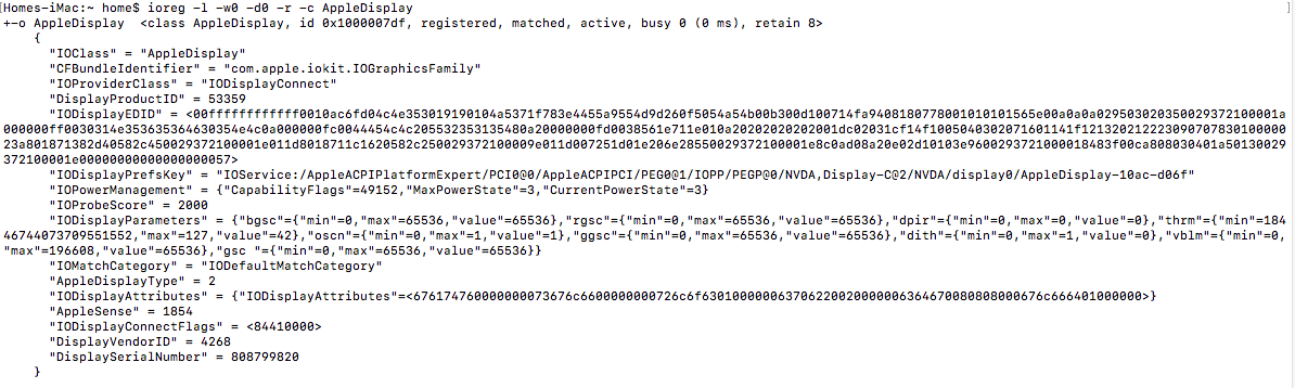

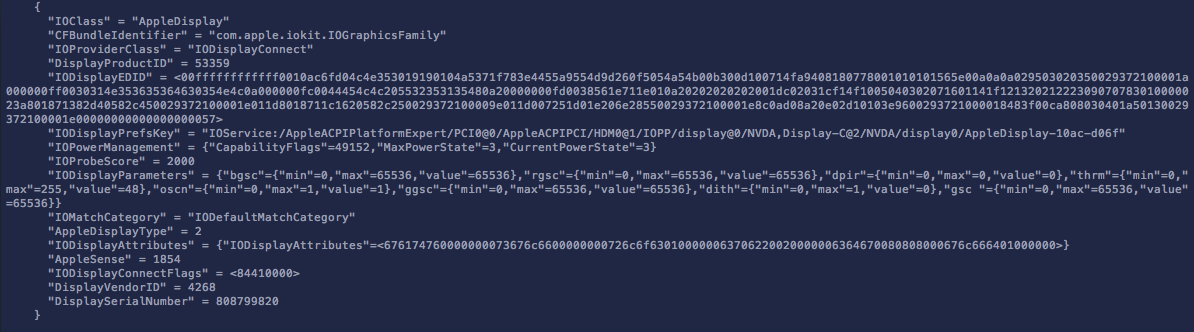

newcomer11 Posted January 4, 2017 Author Share Posted January 4, 2017 I still have issue with screen blink, I notice that my Display EDID is right but sometime it is PEG0 instead of HDM0 in Sirerra ioreg result: On Yosemite it is : Update: this do not relate to the issue. I tried re choose mDP input in the Screen Setting, maybe it help Link to comment https://www.insanelymac.com/forum/topic/319482-slow-boot-after-clover/page/2/#findComment-2343881 Share on other sites More sharing options...
