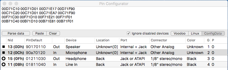

I’m using the next pin config:

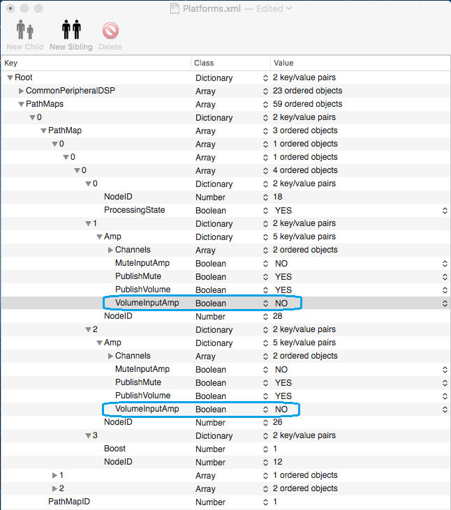

And the path maps:
MIC:                18 > 28 > 26 > 12
Line In:           19 > 29 > 27 > 11
Speaker:         13 > 17
Headphone:    15 > 16

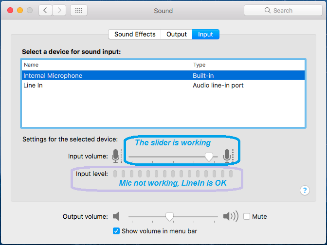

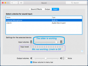

Speaker and Headphone are OK but Mic and LineIn was giving the status "The selected device has no input controls".
After modifying the “VolumeInputAmp” value to “No” in the Pathmap, the above message disappeared and the Input Volume slider becomes available and movable and the LineIn works well but the Mic is not working.

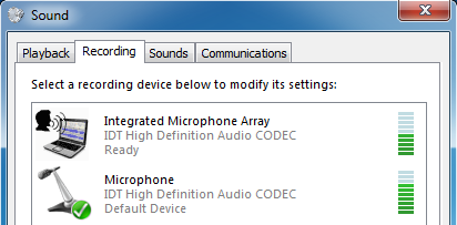

And another problem, although the LineIn is working well (if I connected it to some device LineOut audio source), but it’s not working as External Mic (I’ve tested it as Mic with Windows 7 and it works well).
