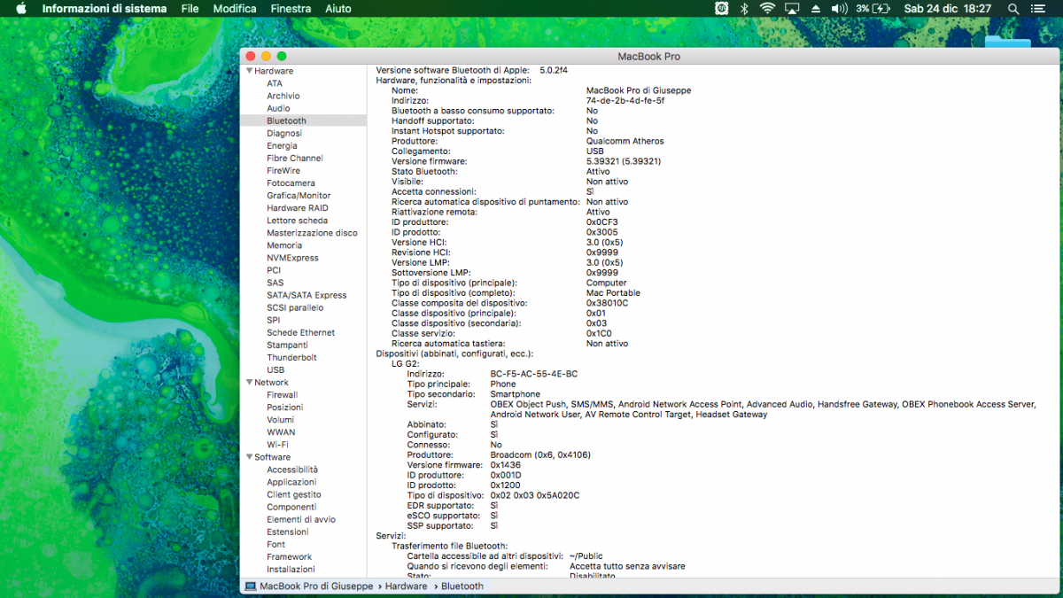

Jolly Posted December 23, 2016 Share Posted December 23, 2016 Puoi postare product e vendor id del bluetooth. Anche un immagine di informazioni di sistema Bluetooth va bene 1 Link to comment https://www.insanelymac.com/forum/topic/319407-ar5b195-e-sierra-il-bluetooth-spesso-non-va/#findComment-2338695 Share on other sites More sharing options...
DS-1 Posted December 24, 2016 Author Share Posted December 24, 2016 Ecco lo screenshot di uno dei riavvi in cui il bluetooth va! Link to comment https://www.insanelymac.com/forum/topic/319407-ar5b195-e-sierra-il-bluetooth-spesso-non-va/#findComment-2339138 Share on other sites More sharing options...
