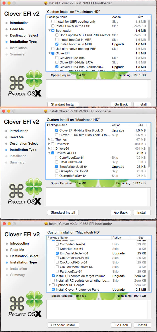

Whosondephone Posted November 26, 2016 Share Posted November 26, 2016 Just wanted to share my Dell Optiplex 360 setup. On a real mac I downloaded Install Yosemite from the app store. Created a USB installer then Installed Clover. I did it so many times I can't remember exactly what I did. I may have followed other guides on this sight that extracted bass system.dmg I may have had to added FakeSMC or other kexts in the installer folders or simply add them to the kext injection folders under Clover. Sound, network, QE works! Just change your graphics setup. I find that if you're using ATI/AMD cards do not use graphics injection. If you're using Nvidia, use graphics injection in clover. The options for for installing clover on the USB are a little different. I Installed clover on the computer with these options: It might work with 10.12. Just move the kext in the EFI folder from 10.10 to 10.12. Thanks go to to TheKing for Slow SATA DSDT fix, Rehabman for FakeSMC and Hardware sensors, Adlan and Nawcom for the Network, InsanelyMacaholic for sound, Clover team, and many more! I hope I got the names correct. I have not gotten the app store working, and do not intend to. Edit: I attached a new edited Clover config.plist I removed some information specific to my machine. And corrected some settings. Unfortunately I can not confirm that this will work. The version of clover that I used was r3949. Clover & Kexts.zip config.plist.zip 1 Link to comment https://www.insanelymac.com/forum/topic/318356-dell-optiplex-360/ Share on other sites More sharing options...

Whosondephone Posted May 19, 2017 Author Share Posted May 19, 2017 Try installing bootaf in the MBR also what version of clover are you using. I have trouble newer versions of clover booting Yosemite. I'm using r3949. Link to comment https://www.insanelymac.com/forum/topic/318356-dell-optiplex-360/#findComment-2426877 Share on other sites More sharing options...
thesaz123 Posted May 22, 2017 Share Posted May 22, 2017 Bootaf in MBR would be when installing clover on the drive, correct? I assume not the USB Stick. And I was using Clover 2.4 r4061. Maybe I should reinstall and try an older version. Link to comment https://www.insanelymac.com/forum/topic/318356-dell-optiplex-360/#findComment-2429436 Share on other sites More sharing options...
Whosondephone Posted May 27, 2017 Author Share Posted May 27, 2017 They way I'm interpreting the wiki is: boot0af: flags the previously selected partition as active. boot0ss: simply boots an HFS partition and sets no flag. Boot0ss is useful if dual booting windows. Either should work whether on the USB install disk or "Macintosh HD". Is is important that you DO NOT install for UEFI Booting Only, and DO NOT install in the ESP. If your still stuck you may want to try that other bios block option. I'm not sure what that is. Of course make sure your set to boot of hard disk in the BIOS. I wouldn't recommend copying the folders over. I would recommend you copy over the config.plist, dsdt.aml, and the kexts into the appropriate places in your EFI folder. I would recommend moving the kexts from 10.10 folder to the “other” folder. You most likely know to install the SLE kexts with kext utility or other method. I must confess that there is a chance that my config.plist may be wrong. I was not aware that the cashe was allowing the system to boot... I was removing patches and boot flags and successfully rebooting and assuming they were not necessary. I did try to make sure it was correct before posting here but the possibility remains something could be off. Another possible Issue is clover and clover configurator has gone through extensive updates since I have done this. I'm noticing that the screen shot is r3763. Clover versions ranging from should work r3763-r3949. My Intel DH55TC failed to boot Yosemite after updating clover at one point. However it did boot clover itself not the OS X. I'll get back you you on the sound but i believe the kext was compiled for Yosemite and may not work with El Capitan. It was my understanding that clover does a wonderful job of disabling SIP. I haven't even had to think about it in my 10.12.5 instillation. I know SIP really sucks. Link to comment https://www.insanelymac.com/forum/topic/318356-dell-optiplex-360/#findComment-2431574 Share on other sites More sharing options...
