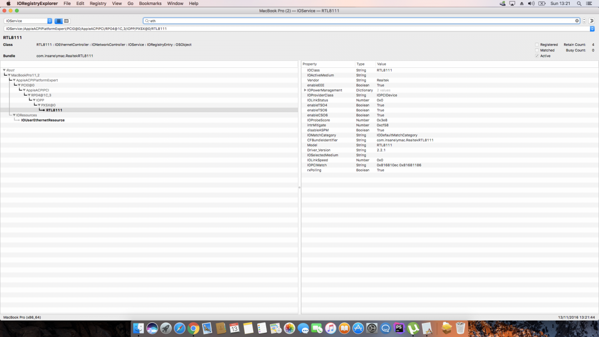

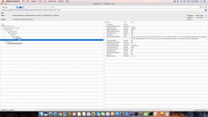

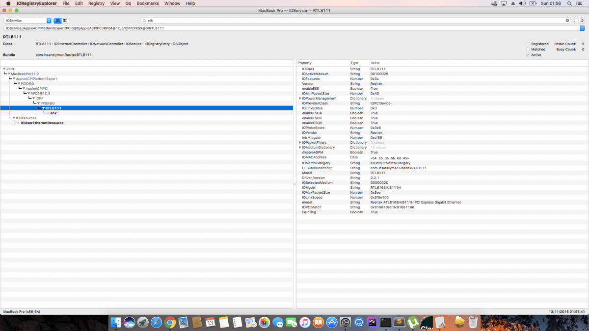

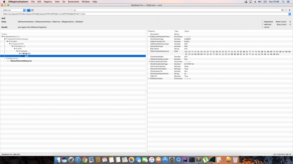

Henzigo Posted November 13, 2016 Share Posted November 13, 2016 Hi i have problem with my ethernet connection on Sierra. I tried many kext drivers. Last one i used Realtek8111.kext version 2.2.1 and it one time without any changes worked and showed my ethernet card in "System Report", but after restart again i didnt have any ethernet cards in "System Report". There are my IOReg screens when ethernet worked: and there is IOReg screen normally: I tried maybe every guide on this forum but without any success. In verbose mode last message from realtek kext is "Region #2 not an MMIO resource, aborting." Ty for reply. Link to comment https://www.insanelymac.com/forum/topic/317933-realtek-8168-doesnt-work/ Share on other sites More sharing options...
