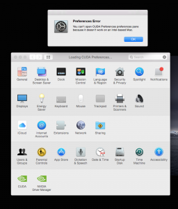

jstancil Posted October 24, 2016 Share Posted October 24, 2016 I have a hack up and running, installed 10.10.5 following RampageDev's clover installation...for the most part. Everything is working except sound, which I get around by using USB. I installed the NVIDIA drivers from here, used 10.10.5 V1. Here is the hardware list ASUS Sabertooth X79 i7 - 4930k GeForce GTX 770 I go to download the CUDA drivers in the link from the same guide, get them installed. Now every time the machine boots up or I try and go to the CUDA panel in system preferences I get this error, "You can't open CUDA Preferences preferences pane because it doesn't work on an intel-based Mac." Not sure what gives. Any ideas? I boot with nvda_drv=1 and everything else seems to function fine, just can't get CUDA rolling. It's a problem because I use DaVinci Resolve. Any help is greatly appreciated. Let me know if I left out any pertinent info. Thanks! Link to comment Share on other sites More sharing options...

imsobored Posted December 6, 2016 Share Posted December 6, 2016 I am having the same issue on Yosemite. You can’t open CUDA Preferences preferences pane because it doesn’t work on an Intel-based Mac. Weird that I never had this issue before. It's new...maybe try an older cuda? Edit: Tried an older cuda install file from 2014...works. Try it out. For yosemite, try CUDA Driver Version: 7.5.30. This is the latest one I am on and its working now. Link to comment Share on other sites More sharing options...
jstancil Posted December 7, 2016 Author Share Posted December 7, 2016 Awesome, thanks for the tip! I'll give that a try tomorrow. Link to comment Share on other sites More sharing options...
