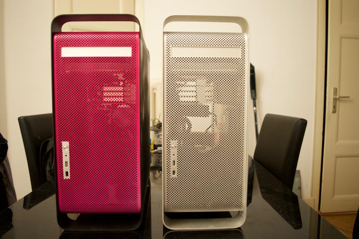

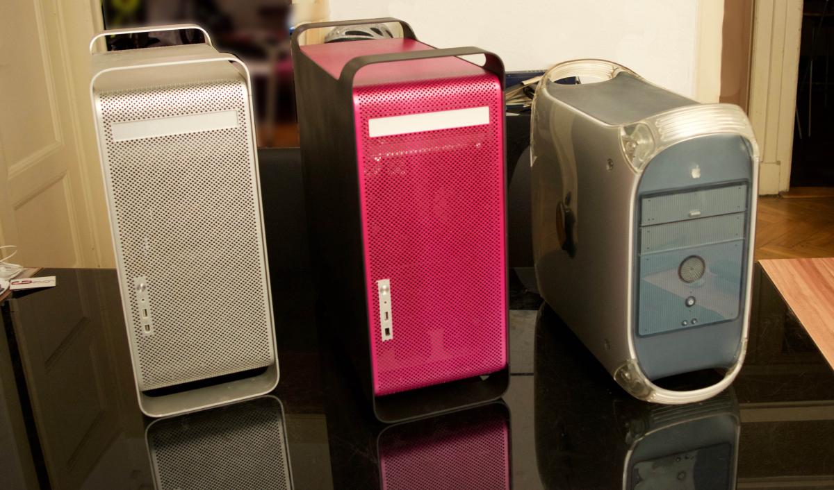

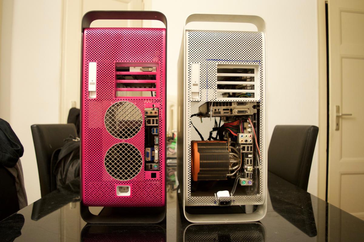

the 3 hackintoshs i'm working on...

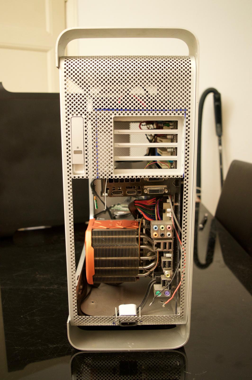

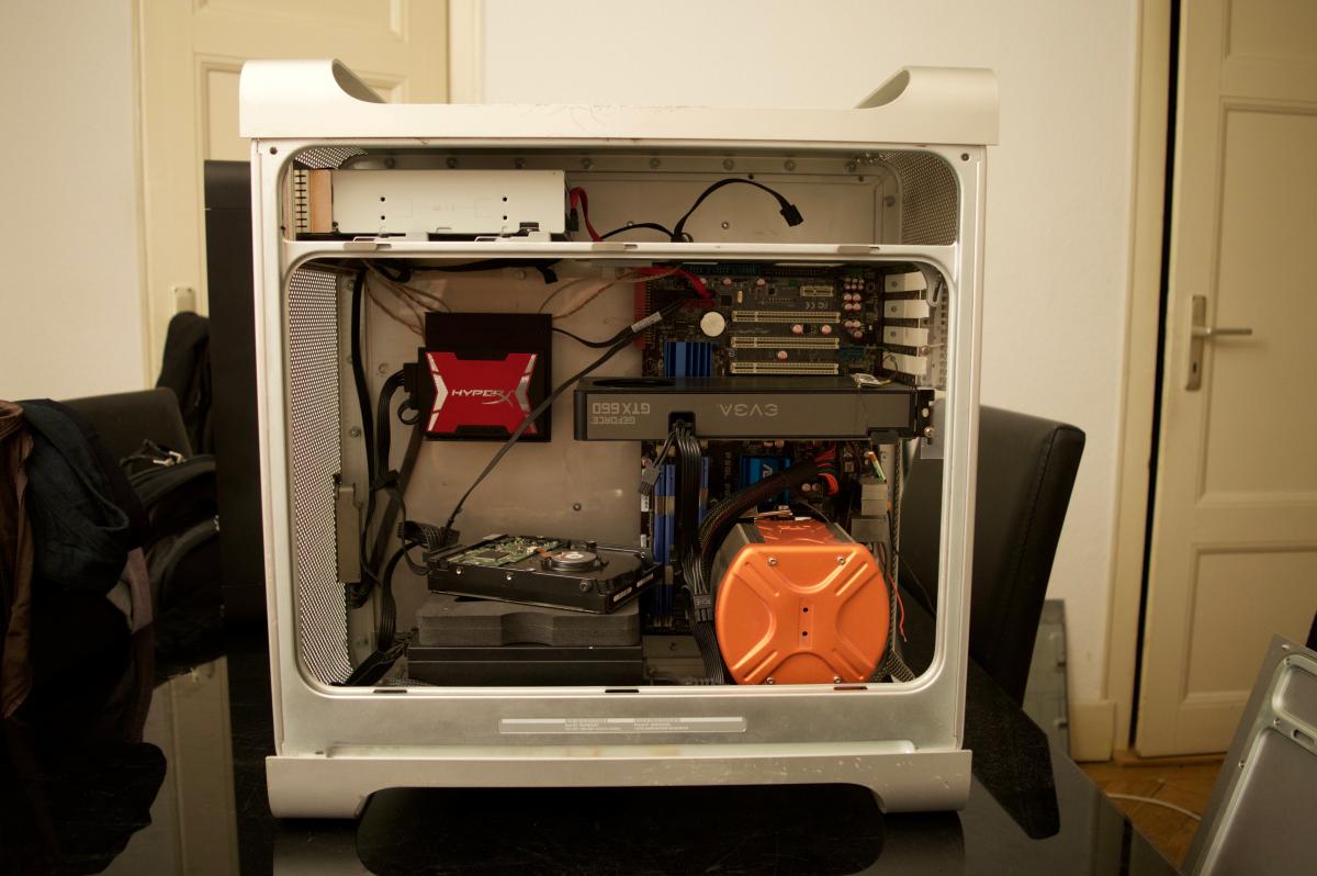

The silver G5, was started for my son and still have some work to do on...

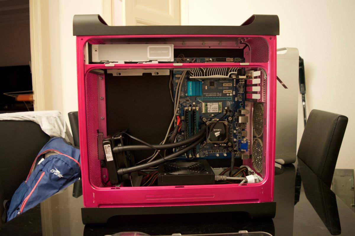

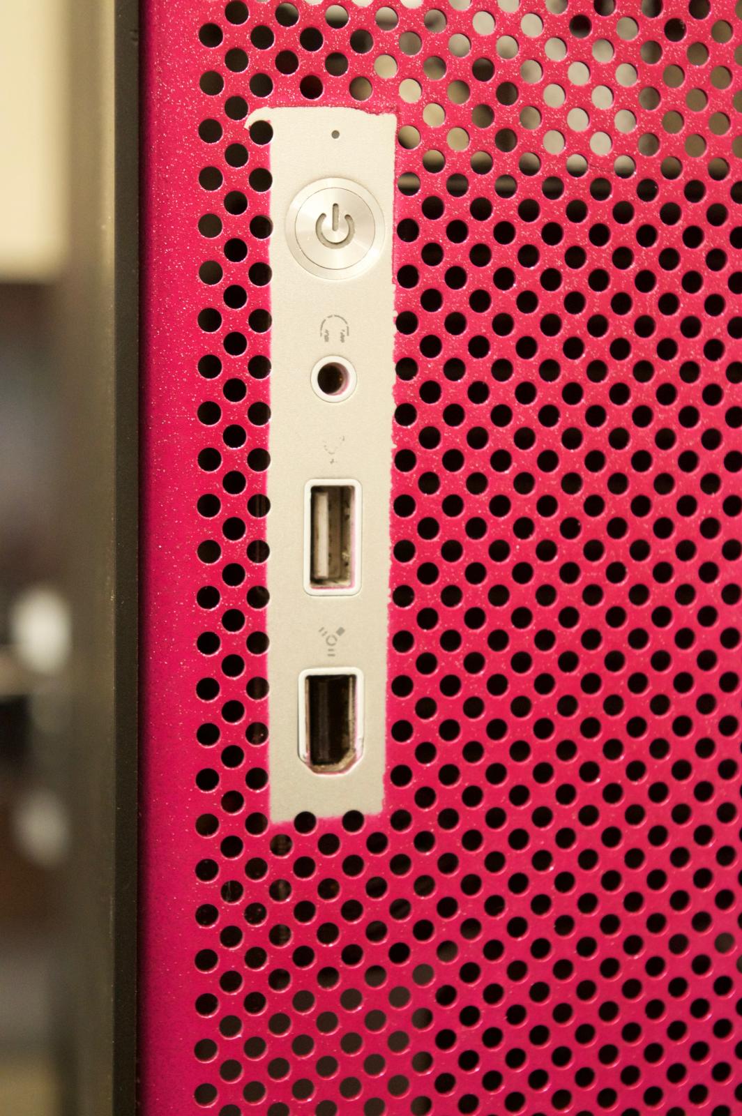

The mat black and pink G5 is the last one i started for me... (with some luck i found this case at the trash)

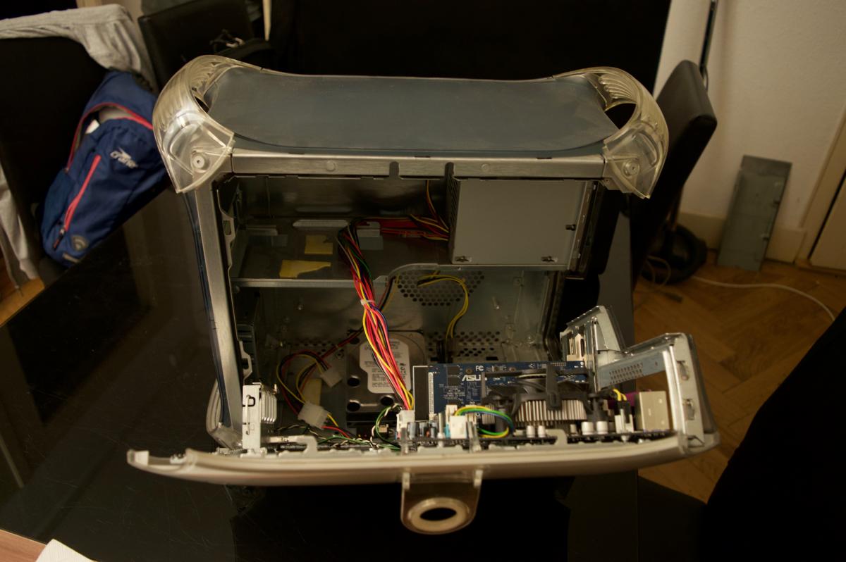

The G4 a little one made just for fun...

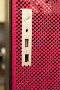

On all 3 i'm using the original power button + reset button on the G4, the USB is used on the silver one and i removed the FireWire 400 on the Blacken to replace it with another USB. on the G5 silver i set up OS X 10.10.x and the G4 and  G5 black + pink runs on 10.11.6 tried 10.12 but 610 GT isn't accepted completely(no acceleration). Wifi is ok with TP-link on the silver, Asus (dont remember model but V2) waiting for Pcie to mini ci-e to put a real airport card on my Blackintosh
I started the silver one 1 and half year ago, my son was so impatient to use it, i didn't finish the back side...

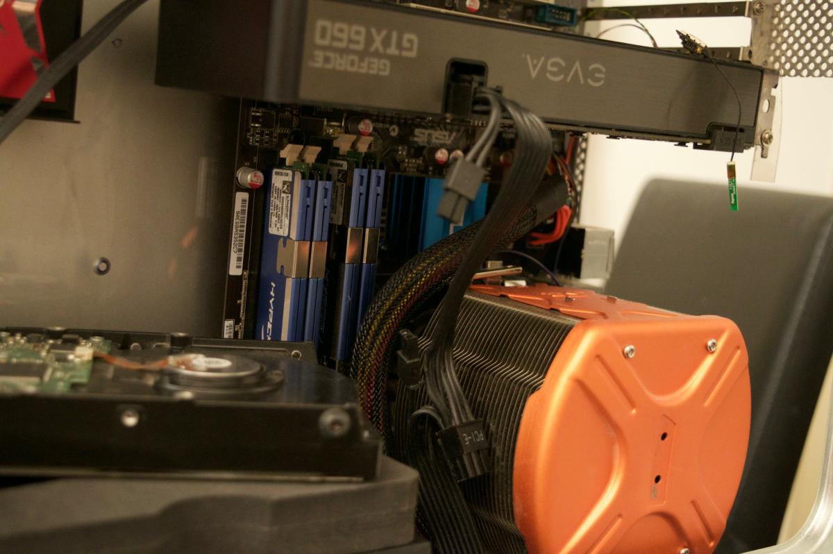

Config:
 - Asus P5QL pro
 - Core 2 duo (dont remember speed)
 - 8GB DDR2 800
 - EVGA GTX660
 - SSD Kingston HyperX 250 Go + Hitachi 1To
 - PSU corsair 750M
The G4 one was given by a friend and i decided to put a little machine that is still working great
Config:
 - Gigabyte G41M ES-2L
 - P4 DualCore 1.6Ghz
 - 4GB DDR2 800
 - 610 GT
 - HDD Hitachi 250Go 2.5"
 - PSU (old one i had around here)
The G5 mat black and diamond pink (Blackintosh) found at the trash what a shame !! lol
Config:
 - Gigabyte GA-Z77 DS3H
 - Core i5-2500 3.3 Ghz
 - Corsair hydro series H60 cooling
 - 16GB DDR3 1600 Corsair vengeance
 - 610 GT
 - mSSD 250Go Samsung + will see what more i'll put
 - Corsaire VS550
