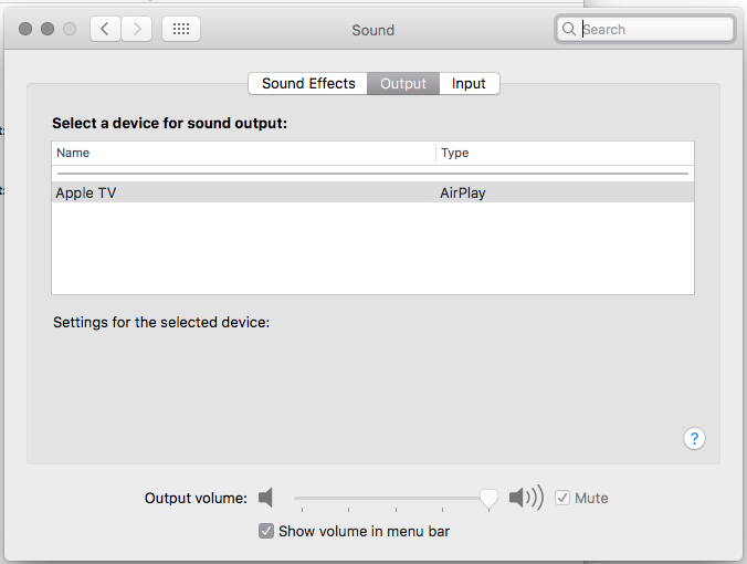

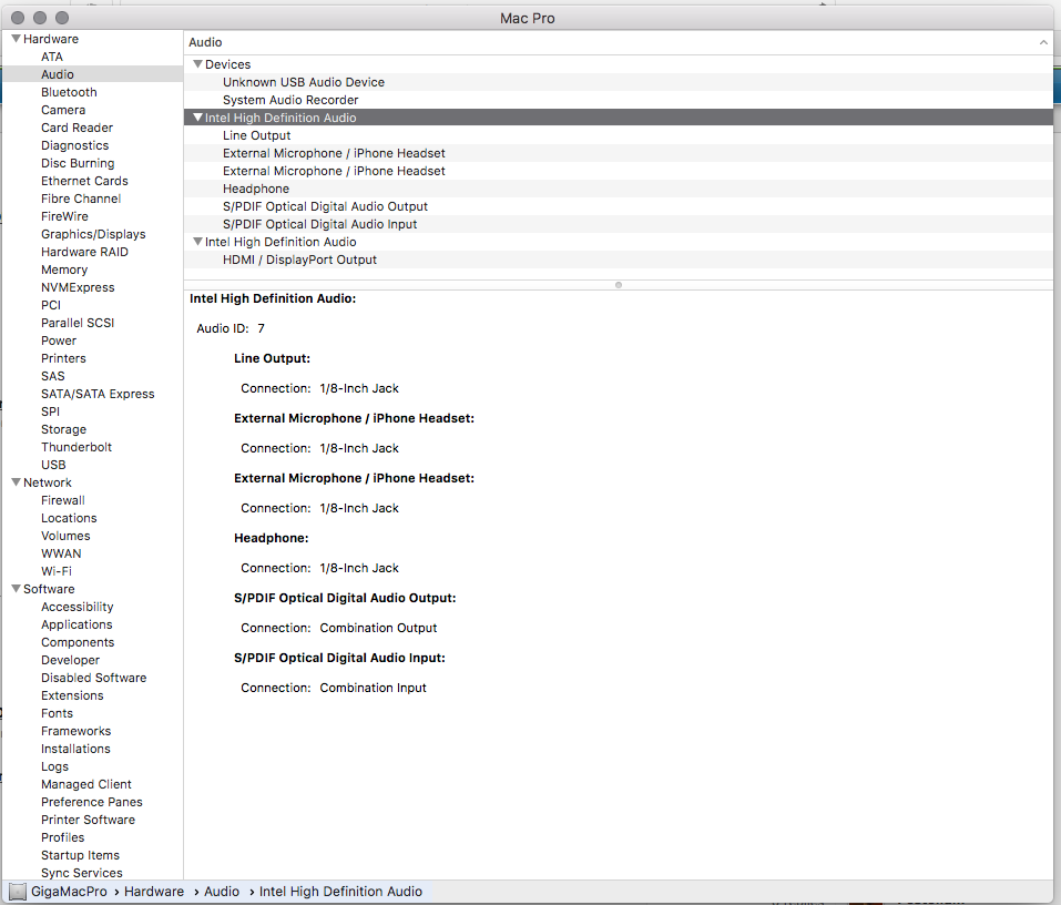

aikidoka25 Posted September 23, 2016 Share Posted September 23, 2016 I upgraded from 10.11 to 10.12 by running the downloaded Install macOS Sierra.app directly. It ran without any issue but one: System Preferences > Sound doesn't show the audio device, but System Information detects it. The sound was good in 10.11 I am using Clover 3763. Smbios is MacPro5,1 I tried the following but none helps: 1. Using AppleHDA.kext that I had from 10.11 2. Patching AppleHDA using AppleHDA Patcher.app, options ALC885 layout 7, placed HDAEnabler, ADummy into SLE. I noticed there is a pop sound if I restarted the computer. Any idea what should I check? Link to comment Share on other sites More sharing options...

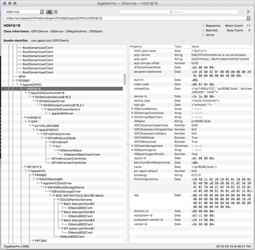

aikidoka25 Posted September 24, 2016 Author Share Posted September 24, 2016 Removed aDummy and HDAEnabler and loaded AppleALC 1.0.16 on CLOVER/Kexts/10.12 (also tried on SLE). Tried with Layout 7 and 1 using DSDT. kextstat -l | grep ALC 23 0 0xffffff7f82c3d000 0xbb000 0xbb000 as.vit9696.AppleALC (1.0.16) A2176A8D-0B84-3DEC-884D-4F94324ABD91 <7 5 4 3 2 1> Still the same issue Link to comment Share on other sites More sharing options...

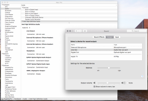

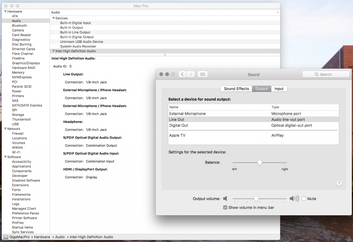

aikidoka25 Posted September 24, 2016 Author Share Posted September 24, 2016 Managed to have sound output. * Clover FixHDA = true * Audio Inject = 0 * AppleALC.kext in CLOVER/kexts + The mic on the Logitech webcam works with Siri, it wasn't working with layout = 1, 5, 7 - Have to switch the stereo jack to the black port. - I don't see the other ports on System Information, now it has less UPDATE: I just realized on System Information the layout id is 0. Weird. Link to comment Share on other sites More sharing options...
aikidoka25 Posted September 24, 2016 Author Share Posted September 24, 2016 So I tested and found out it only works with Layout-ID 0. With 1,5 and 7 the audio does not show in System Preferences. Link to comment Share on other sites More sharing options...

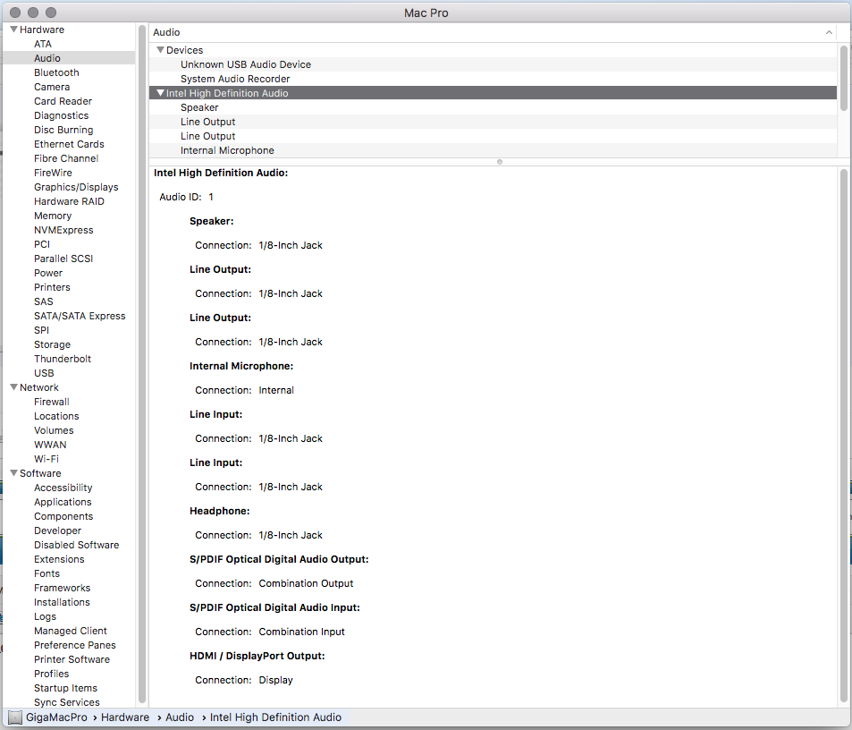

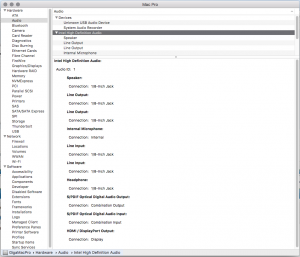

aikidoka25 Posted September 28, 2016 Author Share Posted September 28, 2016 Problem solved by using Toleda's audio_cloverALC-120_v1.0b0.command No more weird layout-id 0. Using layout-id 1 now. Link to comment Share on other sites More sharing options...
