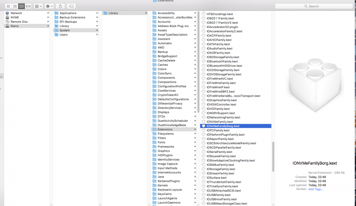

SammlerG Posted September 12, 2016 Share Posted September 12, 2016 Hi, i tested both versions NVMeP_2.3 and NVMeP_2.3B. Installing v2.3B borg.kext in clover/kexts/10.12 results in a KP at boot. (boot with rebuild caches/without caches) Installing v2.3 borg.kext in clover/kexts/10.12 results in nothing. System boots, but NVME drive don´t show up. With I/O reg its shown as Apple NVMe controller, but nothing mounted. Installing both versions, and a v2.3 with arg -a generated kext, installed in /L/E works for me with Sierra GM 16A320. Tested with 2 running installations/disks with latest Clover. I´m using a Samsung SSD 950 Pro 512 GB NVME and a Samsung MZHPS256HDGL AHCI SSD. Now i´m using v2.3 with -a generated kext without any problems. But one problem is still present: i can´t install Sierra direct (or an update from 10.11.6) to the NVME drive. The installer is booting, drive is found and install/update begins, but it always reboots without a kernel panic at the same install position (2 minutes). My workaround for this is always using a AHCI SSD for installation/update and clone it. 1 Link to comment https://www.insanelymac.com/forum/topic/314803-nvmep/page/2/#findComment-2277301 Share on other sites More sharing options...
Micky1979 Posted September 12, 2016 Author Share Posted September 12, 2016 Is your bios capable of boot through nvme? You should have an option for that... otherwise you can't -a use the original apple class code, so the question is: does not work for you w/o give this argument to NVMeP? Thanks Link to comment https://www.insanelymac.com/forum/topic/314803-nvmep/page/2/#findComment-2277325 Share on other sites More sharing options...
SammlerG Posted September 12, 2016 Share Posted September 12, 2016 Since update to GM 16A320 all versions work in /L/E. But with GM 16A319 or PB 7 / DP 8 i´m having trouble. 1 Partition is still PB 7 as Backup. I think this NVMe driver is a diva, a big one! I have no idea what´s going on. At this moment, it works. So let´s see what happens after the next update.... Yes, i can boot from a NVMe drive. 1 Link to comment https://www.insanelymac.com/forum/topic/314803-nvmep/page/2/#findComment-2277330 Share on other sites More sharing options...

magnifico Posted September 20, 2016 Share Posted September 20, 2016 micky, what is the kext for sierra now? HOW DO I generate it EL CAPITAIN? Link to comment https://www.insanelymac.com/forum/topic/314803-nvmep/page/2/#findComment-2280822 Share on other sites More sharing options...
Micky1979 Posted September 20, 2016 Author Share Posted September 20, 2016 easy easy? Download Pandora's Box 3.027 (or update from the existing) Open Hermes.app to create an USB installer. Select the USB pen drive as target Select the Install macOS Sierra.app (Hermes autoselect the first found in /Application, so if it is not the final version, just navigate to find the right app) Do not select "createinstallmedia" Press start. at the end of the process Hermes will ask you if you want to install the bootloader and the FakeSMC. Skip if you don't want (maybe you already have Clover installed on your PC.. and is able to boot sierra). Open Zeus.app from Pandora: select the volume containing the installer just made (Pandora Installer) and go to the "Disks" tab. press "Patch IONVMEFamily.kext into IONVMEFamilyBorg.kext", read the messagge that should be positive and press "Start" select /System/Library/Extensions (should be already enabled) go ahead untill the installation is made and restart and boot into the installer. Link to comment https://www.insanelymac.com/forum/topic/314803-nvmep/page/2/#findComment-2280870 Share on other sites More sharing options...
magnifico Posted September 20, 2016 Share Posted September 20, 2016 but i need a kext inside 10.12 of clover ..understand? Link to comment https://www.insanelymac.com/forum/topic/314803-nvmep/page/2/#findComment-2280885 Share on other sites More sharing options...
Micky1979 Posted September 20, 2016 Author Share Posted September 20, 2016 Carmine the kext is inside the installer, so if you do like I said maybe will work, otherwise I can't tell you much. Extract the kext from BaseSystem.dmg, place it on desktop: mkdir -p $HOME/Desktop/patched cd $HOME/Desktop/patched $HOME/Desktop/NVMeP -k $HOME/Desktop/IONVMEFamily.kext open $HOME/Desktop/patched use NVMeP normal version. good luck 1 Link to comment https://www.insanelymac.com/forum/topic/314803-nvmep/page/2/#findComment-2280889 Share on other sites More sharing options...
