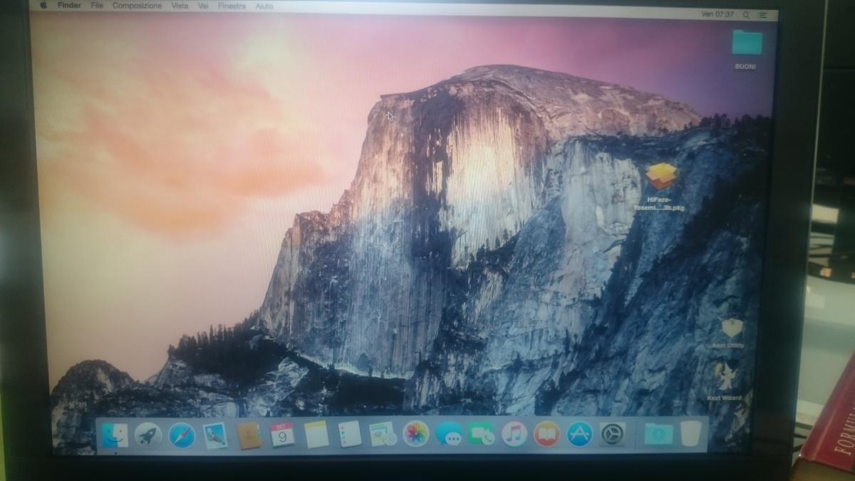

calabuig Posted September 8, 2016 Author Share Posted September 8, 2016 Ok, try these new files dsdt.aml and org.chameleon.boot.plist. Report back i hope now is fixed the last GC issue. See Ya bootfile2.zip It seems it works!!!!!!!!!!!!!!!!!!!!!!!!!! The strange thing is that in the first attempt the system hangs out after the login screen (that I have disabled)... So I tried PCIRootUID=1 npci=0x2000 (no success) and PCIRootUID=1 npci=0x3000...and it works. Then I tried without the above boot flags...and all has mysteriously turned out fine. I only hope it will last... One thing to resolve: is there a way to fix the VAIO bios settings? Every time that I restart the osx, I have to enter in the bios settings to enable the external boot. Link to comment https://www.insanelymac.com/forum/topic/314634-solved-yosemite-installation-on-sony-vaio-vgn-ar41m/page/2/#findComment-2275255 Share on other sites More sharing options...

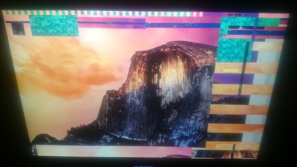

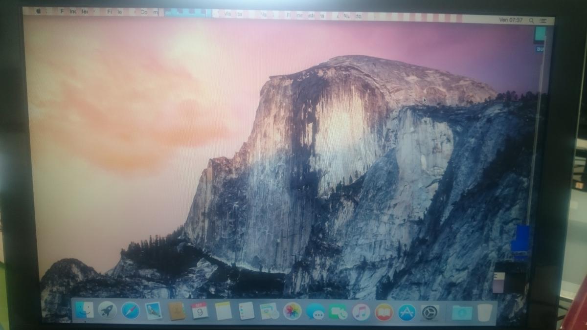

calabuig Posted September 9, 2016 Author Share Posted September 9, 2016 The best you can do is a fresh Yosemite installation (Vanilla). Search here on Forum a tutorial. I don't think that the nVidia web drivers should work better ... So...I made another try with my old USB installer and all is ok, except that... after the disk has finished loading osx, the desktop has graphical errors like those in photo "A" (in one case the system freezes at all)! To solve the problem I have to change resolution and change back to the desidered one (photo "B") Is it normal? Link to comment https://www.insanelymac.com/forum/topic/314634-solved-yosemite-installation-on-sony-vaio-vgn-ar41m/page/2/#findComment-2275764 Share on other sites More sharing options...

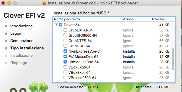

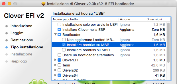

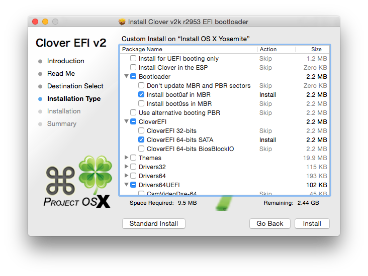

calabuig Posted September 11, 2016 Author Share Posted September 11, 2016 Hello pippox0, I can't solve the problem, even with a fresh installation. I found a guide about EDID Injection with Clover that says: Your graphics framebuffer kext is correctly loaded, but you receive no image after boot messages (aka black screen); Your display seem to work fine only randomly; You have blinking screen or many artifacts. The second and third lines are about my problems. So I tried with Clover, but I can't boot from USB. A message appear: boot6, than a black screen. I follow the in the photo and the USB pen is MBR partition. Where I went wrong? Thanks for your help. Link to comment https://www.insanelymac.com/forum/topic/314634-solved-yosemite-installation-on-sony-vaio-vgn-ar41m/page/2/#findComment-2276916 Share on other sites More sharing options...

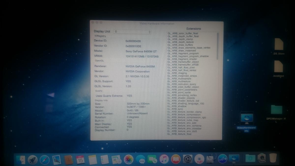

PippoX0 Posted September 15, 2016 Share Posted September 15, 2016 HI, Calabuig, try this new one DSDT. ( i change something) Report if you resolve the issue From the pics you have posted it doesn't seem that QE/CI is enabled. Use VideoHardwareInfo to test it question : The external monitor works fine or not ? Cheers PippoX0 dsdt.aml.zip VideoHardwareInfo.zip Link to comment https://www.insanelymac.com/forum/topic/314634-solved-yosemite-installation-on-sony-vaio-vgn-ar41m/page/2/#findComment-2278599 Share on other sites More sharing options...
calabuig Posted September 15, 2016 Author Share Posted September 15, 2016 Hi, PippoX0, thanks again for your help... I'll try your new DSDT in a few hours. And about external monitor... I try, for desperation, old nVidia enabler and discovered that nVenabler64 works, but only if I connect an external monitor. In that way the system work perfectly. But I can't keep connecting my one and only monitor (that's in other room) to solve my problem. So let me try your new DSDT (and VideoHardwareInfo)...and I'll check if external monitor works or not. Another question: if your DSDT didn't work, I'd like to try Clover beacuse I found a guide about EDID Injection with Clover that says: Your graphics framebuffer kext is correctly loaded, but you receive no image after boot messages (aka black screen); Your display seem to work fine only randomly; You have blinking screen or many artifacts. I used a USB pen formatted with one GUID partition and boot0af on MBR (but even boot0ss on MBR). On reboot a "6" appears and then black screen! Then I tried to make a MBR DOS-FAT32 partition (EFI CLOVER) to install Clover and one HFS+ for the rest of USB. Choose boot0af in the MBR (see options in the attached photos). Reboot and start b1f:init for a few seconds...than appear a "6" and then...black screen!!! Any ideas to start Clover with Vaio? Link to comment https://www.insanelymac.com/forum/topic/314634-solved-yosemite-installation-on-sony-vaio-vgn-ar41m/page/2/#findComment-2278642 Share on other sites More sharing options...
calabuig Posted September 15, 2016 Author Share Posted September 15, 2016 HI, Calabuig, try this new one DSDT. ( i change something) Report if you resolve the issue From the pics you have posted it doesn't seem that QE/CI is enabled. Use VideoHardwareInfo to test it question : The external monitor works fine or not ? Cheers PippoX0 dsdt.aml.zip VideoHardwareInfo.zip Hi PippoX0, look at the attached photo!!! Here we are! Great. It works. Just for my comprehension...what did you change in DSDT? Both monitors work (extended mode) and QE enabled. Network works! To tell the truth, like I said in a previous post, also nVenabler64 works, but only if I connect an external monitor. So...thanks, thanks, thanks!!! Link to comment https://www.insanelymac.com/forum/topic/314634-solved-yosemite-installation-on-sony-vaio-vgn-ar41m/page/2/#findComment-2278816 Share on other sites More sharing options...
PippoX0 Posted September 15, 2016 Share Posted September 15, 2016 Hi, I changed a byte of NVCap .(07->A7) I'm glad that now your Sony Vaio works fine ! ? Did you know that Apple has developed OSX for Intel on a Sony vaio ? Change the title of the topic from Help to Solved !! See Ya Sent from iPhone/iPad Link to comment https://www.insanelymac.com/forum/topic/314634-solved-yosemite-installation-on-sony-vaio-vgn-ar41m/page/2/#findComment-2278837 Share on other sites More sharing options...
calabuig Posted September 15, 2016 Author Share Posted September 15, 2016 Hi, I changed a byte of NVCap .(07->A7) I'm glad that now your Sony Vaio works fine ! Did you know that Apple has developed OSX for Intel on a Sony vaio ? Change the title of the topic from Help to Solved !! See Ya Sent from iPhone/iPad No, I didn't know... Thanks for all!!! Link to comment https://www.insanelymac.com/forum/topic/314634-solved-yosemite-installation-on-sony-vaio-vgn-ar41m/page/2/#findComment-2278843 Share on other sites More sharing options...
