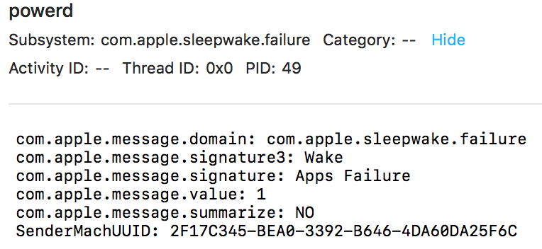

Henk1 Posted August 12, 2016 Share Posted August 12, 2016 The good news is that beta's 1 .. 4 run well including sleep. But the screen does not wake up. The monitor is connected via DisplayPort vs. 1.2 and displays Retina resolution with the nvidia web drivers. The same clover version, 3676, with the same minimal config.plist works fine with Yosemite and El Capitan. No DSDT.When I wake up the pc seconds after the pc sleeps, wake up is fine. Waking up after a longer time, the monitor responds (sometimes) with ‘no signal on DisplayPort’ and ’entering power save mode’. Sometimes I have to pull the monitor wall plug because the monitor hangs. Replugging the DP cable does not help. Booting with HDMI cable results in a black screen. In the system log a powerd entry shows a sleepwake.failure with signature ‘Apps Failure’.MB GA-B75M-D3H, GTX750ti, i3 3225, Dell P2415Q, Clover 3676, syst.def iMac 14,2 update sep 1: beta 5 .. 7: no change Link to comment https://www.insanelymac.com/forum/topic/314170-sleeps-no-wake/ Share on other sites More sharing options...
Henk1 Posted January 14, 2017 Author Share Posted January 14, 2017 finally this was solved by using System Definition MacMini6,2 Link to comment https://www.insanelymac.com/forum/topic/314170-sleeps-no-wake/#findComment-2349032 Share on other sites More sharing options...
