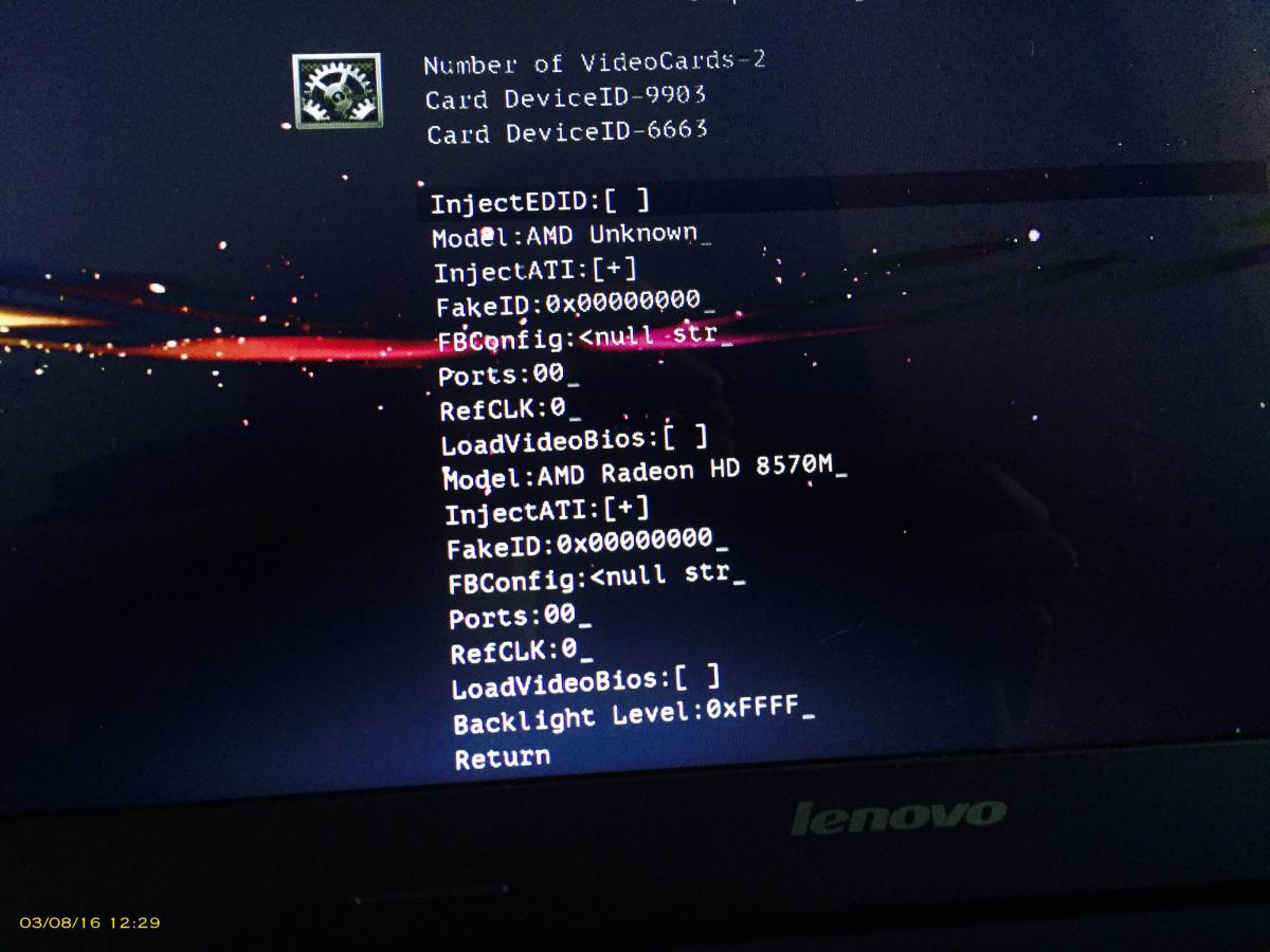

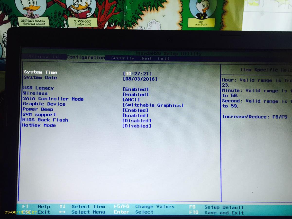

Herzen Posted August 4, 2016 Share Posted August 4, 2016 Hello, after many attempts I managed to Install niresh Yosemite on my Lenovo g505s ( AMD A8 4500m , ATI 7640g , ATI 8570m , 4GB RAM 800mhz and 500 GB HDD 5400 rpm ) .Yosemite recognize me without problems The CPU But Not recognizes the GPU , in fact from 4mb monitor , and does not sound must be it internet , for ' Ethernet so already exists What has the kext I solo install mA for the wi - fi did not know if there has ( AR9485 ) applies ditto for l ' audio . What I hope you can help me because it would give me great satisfaction to be able to use this Hackintosh on the move or for business, thanks in advance to all of you and good evening .Sorry for the english but i'm italian. My config.plist https://drive.google...iew?usp=sharing Link to comment https://www.insanelymac.com/forum/topic/313909-lenovo-g505s/ Share on other sites More sharing options...
carlo_67 Posted August 16, 2016 Share Posted August 16, 2016 try putting inject Edid and load vbios in clover IT prova a mettere la spunta su InjectEdid e loadvbios per l'audio avendo AMD vai di VoodooHDA Link to comment https://www.insanelymac.com/forum/topic/313909-lenovo-g505s/#findComment-2266195 Share on other sites More sharing options...
confrontedmatthew Posted October 9, 2016 Share Posted October 9, 2016 Your wifi card is not supported. Try using a wifi USB Adapter etc APU graphics aren't either. Video playback at 480p is about the max it can take before crash or insane screen tearing. Don't forget to use beamoff for smoother performance Link to comment https://www.insanelymac.com/forum/topic/313909-lenovo-g505s/#findComment-2296210 Share on other sites More sharing options...
