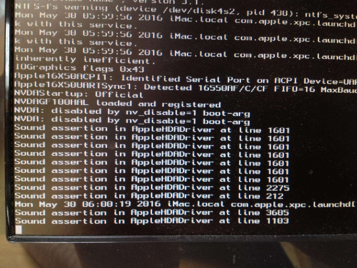

I am really new to the Hackingtosh topic and started to read and do research about it since last week.
Since I do not have a Mac in order to create a bootable USB stick, I setup a VM and followed one of the tutorials.
I used clover as a bootloader using the legacy mode (because my mainboard does not support UEFI).
My configuration looks like the following:
Mainboard: GA-H55M-USB3
Processor: Intel® Core i7 CPU         870  @ 2.93GHz
Graphic Card: GeForce GTX 460
My mainboard does not have any graphic chip. I tried different boot options and the best were:
nv_disable=1 and nvda_drv=1.

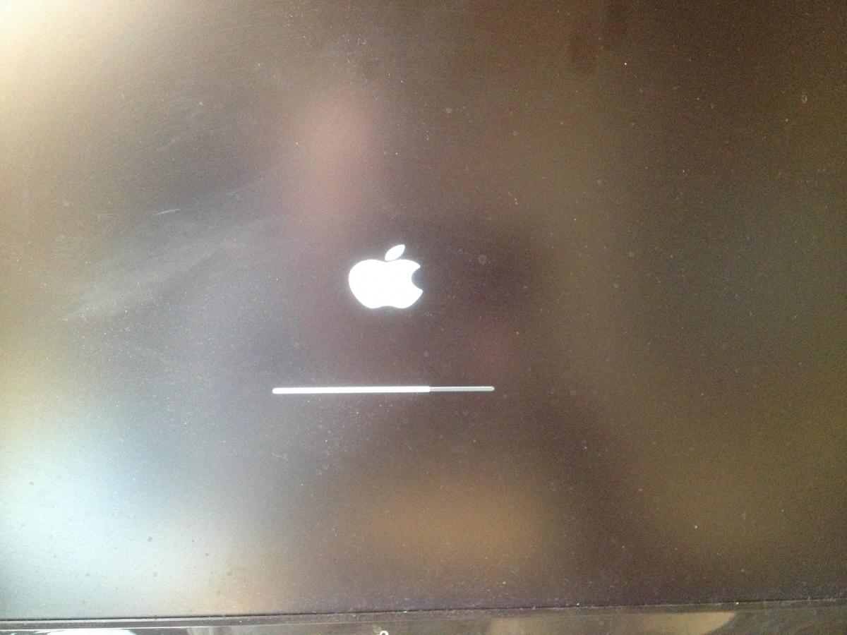

Once I saw the spinning wheel but it did not continue. When I use the verbose mode it is rebooting again after a while. The final log can be seen on the picture.
What else can I try to come to the installation menu?
Thanks in advance,
Julian
I did not change much.
I added FakeSMC, HWInfo and NullCPUPowerManagemnt as Kexts.
Is there any possibility to check if they are loaded correctly?

At first: Read the manual!!! Important to edit  config.plist by corectly.
At second: why you use NullCpuPowerManagement?
And try do edit injection Nvidia Graphics, like this
<key>Inject</key>
<dict>
<key>ATI</key>
<false/>
<key>Intel</key>
<false/>
<key>NVidia</key>
<true/>
</dict>
And put FakeSMC.kext to EFI/Clover/Kext/10.11
AppleHDA was not the problem. It was indeed the graphic card.
thanks to Gen4ig!
I got the OS installed and I installed Clover now to my hard drive. It is booting!
However, only one monitor (connected by DVI-D using a DVI-D to VGA adapter - monitor has only VGA) is working. the other one
connected directly by DVI-D is not working. I tried all ports and all combinations only my VGA monitor works. Only the VGA monitor shows up in the display settings.
This happens when I inject nvidia.
Therefore, I tried to install the nvidia web driver for my el capitan. so whenever I stop to inject nvidia and activate nvda_drv=1 the screen turns black while booting.
I also experimented with the npci option but nothing did work out.
Any idea? Should I try to fix the injected nvidia driver or continue experimenting with the web driver?
