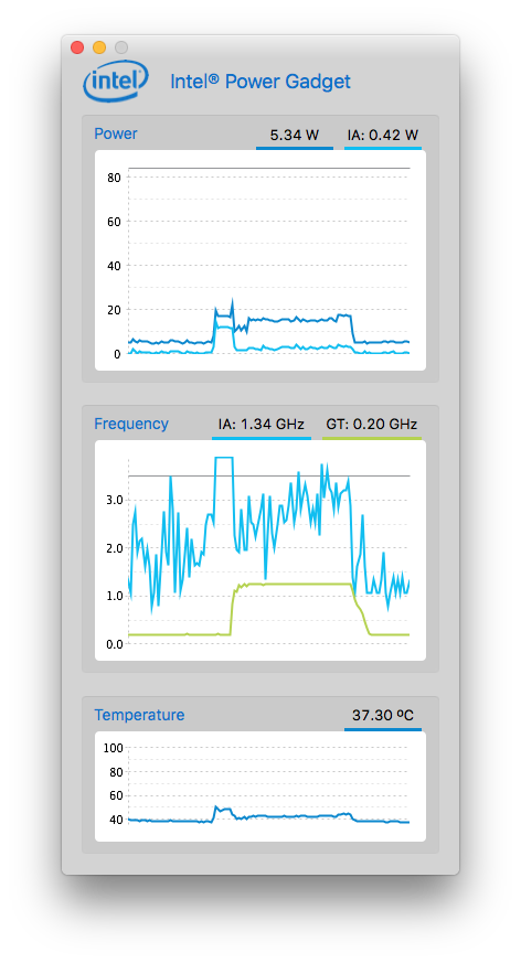

camazza Posted April 26, 2016 Author Share Posted April 26, 2016 Not true; 4770K, every in between state with idle and max turbo. Screen Shot 2015-11-28 at 9.52.44 AM.png I might have to tweak my BIOS settings a little then, It's the only option left. However, I'm under the impression that Power Gadget draws a graph of the average CPU Frequency instead of displaying the current active state. My Power Gadget graph is similar, but the log clearly shows only 800mhz and 3400 to 3900mhz, nothing inbetween. Also, Power Gadget never idles at 800mhz even when completely idle, it always fluctuates Link to comment https://www.insanelymac.com/forum/topic/311963-i7-4770-pm-issues/#findComment-2234591 Share on other sites More sharing options...
toleda Posted April 26, 2016 Share Posted April 26, 2016 under the impression that Power Gadget draws a graph of the average CPU Frequency instead of displaying the current active state. Not true, PG is realtime. Adjust sampling rate in Preferences to confirm. No CPU PM. BIOS: Optimized Defaults, no other CPU settings. Attach http://github.com/Piker-Alpha/AppleIntelInfo output, IOReg and ssdt. Link to comment https://www.insanelymac.com/forum/topic/311963-i7-4770-pm-issues/#findComment-2234624 Share on other sites More sharing options...

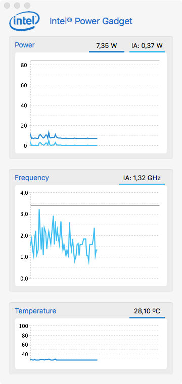

camazza Posted April 26, 2016 Author Share Posted April 26, 2016 Not true, PG is realtime. Adjust sampling rate in Preferences to confirm. No CPU PM. BIOS: Optimized Defaults, no other CPU settings. Attach http://github.com/Piker-Alpha/AppleIntelInfo output, IOReg and ssdt. Here you go. I see plenty of states with AppleIntelInfo, but only ever 8, 34, 35, 36, 37, 38 and 39 are triggered. As you can see, Intel Power Gadget never idles @800mhz. Here the system was completely idle, no open applications. logs.zip Link to comment https://www.insanelymac.com/forum/topic/311963-i7-4770-pm-issues/#findComment-2234727 Share on other sites More sharing options...
toleda Posted April 26, 2016 Share Posted April 26, 2016 Here you go. I see plenty of states with AppleIntelInfo, but only ever 8, 34, 35, 36, 37, 38 and 39 are triggered. As you can see, Intel Power Gadget never idles @800mhz. AppleIntelInfo.dat is not useable, attach a .txt file. PG hits 800, it will never settles at 800. Screenshot shows 1.32 or 13. Link to comment https://www.insanelymac.com/forum/topic/311963-i7-4770-pm-issues/#findComment-2234745 Share on other sites More sharing options...
