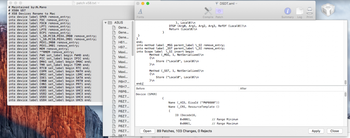

nmano Posted April 24, 2016 Share Posted April 24, 2016 PATCH GA X58A-UD7 X58 UD7 by MaLd0n Modified N.Mano XHCI for USB 3 DTGP HDEF HID/CID EH01 EH02 HPET RTC IRQs RENAMED DEVICES SMBUS SHUTDOWN REMOVED DEVICES LPC FIX WARNINGS Extracting your native/clean DSDT using Clover F4 If you press F4 at the main Clover bootloader screen, Clover will write your native files to EFI/Clover/ACPI/origin. Use File Open to open your unpatched/raw DSDT you extracted earlier Choose patch x58.txt Open MaciASL.app Set ACPI Specification 4.0 Select All from patch x58.txt and copy Click patch button MaciASL.app just paste all then apply once. X58A UD7 DSDT Patch.zip 1 Link to comment https://www.insanelymac.com/forum/topic/311936-x58a-ud7-for-dsdt/ Share on other sites More sharing options...

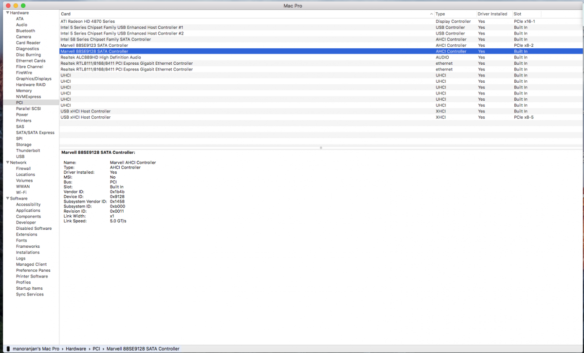

nmano Posted May 7, 2016 Author Share Posted May 7, 2016 I just update with 0 error ACPI Specification 5.1 PATCH GA X58A-UD7 X58 UD7 # Maintained by:N.Mano # Credits: RehabMan,MaLd0n XHCI for USB 3 DTGP HDEF HID/CID EH01 EH02 HPET RTC IRQs RENAMED DEVICES SMBUS SHUTDOWN REMOVED DEVICES LPC FIX WARNINGS sata 3 or SSD(88SE9128) IF enable 88SE9128 PCIe SATA 6 Gb/s RAID controller you have to set bios all IDE mode change to AHCI. Extracting your native/clean DSDT using Clover F4 If you press F4 at the main Clover bootloader screen, Clover will write your native files to EFI/Clover/ACPI/origin. Use File Open to open your unpatched/raw DSDT you extracted earlier Choose patch x58.txt Open MaciASL.app Set ACPI Specification 5.1 Select All from patch x58.txt and copy Click patch button MaciASL.app just paste all then apply once. X58A UD7 DSDT Patch.zip Link to comment https://www.insanelymac.com/forum/topic/311936-x58a-ud7-for-dsdt/#findComment-2236606 Share on other sites More sharing options...
