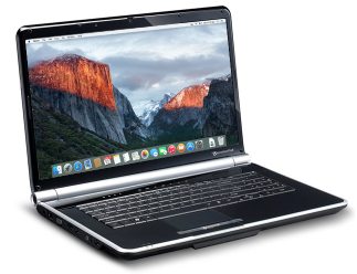

JahStories Posted March 15, 2016 Share Posted March 15, 2016 PackardBell TJ65 Model ms2273 (gtx240m version) This old but still "blazing" PackardBell seems made for El Capitan, everything is working, even sleep. After the installation, it needs Nvidia Web Drivers and only FakeSMC,BCM5722d, VoodooPS2 HDA and battery. To fix sleep I am sharing even the patched DSDT (thx gengik84 for its help!!) (the dsdt is compatible only for the same exact machine [t4400-Gtx240m]) For the installation follow any usual guide. FilesPackage: PackardBell TJ65.zip 2 Link to comment https://www.insanelymac.com/forum/topic/311406-packardbell-tj65-ms2273-1011/ Share on other sites More sharing options...
