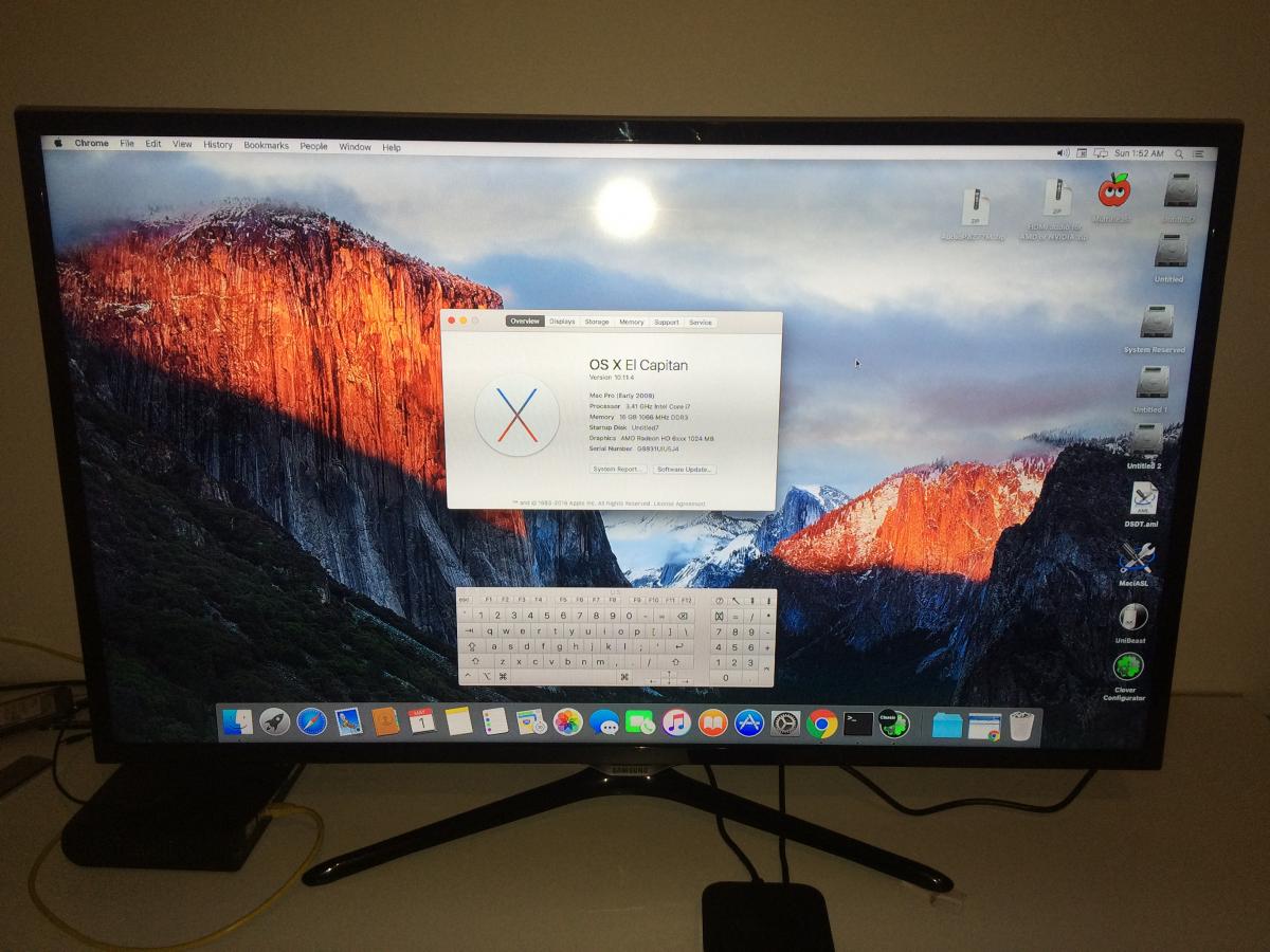

conmac7 Posted February 1, 2016 Share Posted February 1, 2016 Hello, and forgive me for my english. Its not my mother language. My system is this: Mobo: with intel series 7 chipset (Z77), Asus P8Z77-M RAM: 1DIMM Corsair 8GB @1600MHZ, DDR3 CPU: Intel i7-3770 (not 3770K) HDD: SATA, ST3250318AS (Seagate, 250GB) GPU: GF 560SE 1536MB As you can see bellow, OS X sees my pc as an iMac 27" late 2012 1. Some options where changed @BIOS. You can se my BIOS settings to this link: https://www.flickr.com/photos/profound-life_photoshoots/sets/72157661853338693 For the installation i use USB flash drive. I dont have a mac, so i installed osx on vmware workstation. 2. From disk utility format the USB with name "USB" (without ""), format: OS X extended (Jurnaled) and Scheme GUID 3. next download http://sourceforge.net/projects/cloverefiboot/. 4. go to system preferences-->security&privacy-->General. Allow Apps downloaded from: Annyware. 5. Download from appstore el capitan 6. open terminal and write: sudo /Applications/Install\ OS\ X\ El\ Capitan.app/Contents/Resources/createinstallmedia --volume /Volumes/USB --applicationpath /Applications/Install\ OS\ X\ El\ Capitan.app --nointeraction Press enter and enter your password. 7. install clover @ USB drive. Click change location and select your usb that u made @ step 2. 8. Click customize in the clover installer (down left choice) and check the options "install for UEFI boot only", "install clover in the ESP" and from drivers64UEFi select OsxAptioFixDRV-64 (not the OsxAptioFix2DRV-64). Next install the clover 9. Now you need some kexts for the build-in ethernet, SATA because the disks appear as external, and USBFIx because keyboard and mouse dont work inside the installation program. You need: AppleACPIPS2Nub, AHCIPortInjector, AppleACPIPS2Nub, ApplePS2Controller, FakePCIID_XHCIMux, FakePCIID, FakeSMC, NullCPUPowerManagement, and some code inside config.plist. All those you need to copy it at the EFI partition that the clover installer made and you can find it at the OS X desktop. Download this file: https://dl.dropboxusercontent.com/u/20648412/kexts_10113.zip Extract it. Copy the contents (all of them) to the EFI partition/clover/kexts/Other and to EFI partition/clover/kexts/10.11. 10. open the file EFI partition/clover/config.plist with text edit and find <key>Patches</key> (press windows key+f and paste it) It will find <key>#Patches</key>. The difference is this have an "#" before "Patches". Now you need to write this: <key>Patches</key> <array> <dict> <key>Comment</key> <string>change EHC1 to EH01</string> <key>Find</key> <data>RUhDMQ==</data> <key>Replace</key> <data>RUgwMQ==</data> </dict> <dict> <key>Comment</key> <string>change EHC2 to EH02</string> <key>Find</key> <data>RUhDMg==</data> <key>Replace</key> <data>RUgwMg==</data> </dict> Your config.plist now looks like this: <key>ACPI</key> <dict> <key>#DropMCFG</key> <false/> <key>#PatchAPIC</key> <false/> <key>#ResetAddress</key> <string>0x64</string> <key>#ResetValue</key> <string>0xFE</string> <key>#SortedOrder</key> <array> <string>SSDT-3.aml</string> <string>SSDT-1.aml</string> <string>SSDT-2.aml</string> </array> <key>#smartUPS</key> <false/> <key>DSDT</key> <dict> <key>#DropOEM_DSM</key> <dict> <key>ATI</key> <true/> <key>Firewire</key> <true/> <key>HDA</key> <true/> <key>HDMI</key> <true/> <key>IDE</key> <true/> <key>IntelGFX</key> <true/> <key>LAN</key> <true/> <key>LPC</key> <false/> <key>NVidia</key> <true/> <key>SATA</key> <true/> <key>SmBUS</key> <false/> <key>USB</key> <true/> <key>WIFI</key> <true/> </dict> <key>Patches</key> <array> <dict> <key>Comment</key> <string>change EHC1 to EH01</string> <key>Find</key> <data>RUhDMQ==</data> <key>Replace</key> <data>RUgwMQ==</data> </dict> <dict> <key>Comment</key> <string>change EHC2 to EH02</string> <key>Find</key> <data>RUhDMg==</data> <key>Replace</key> <data>RUgwMg==</data> </dict> </array> <key>#Patches</key> <array> <dict> <key>Comment</key> <string>Remove battery device from desktop</string> <key>Find</key> <data> W4IeQkFUMQhfSElEDEHQDAoIX1VJRAEUCF9T VEEApAA= </data> <key>Replace</key> <data> </data> </dict> <dict> <key>Comment</key> <string>Add _SUN property for GIGE</string> <key>Find</key> <data> UFhTWAhfQURSAAhfUFJXEgYC </data> <key>Replace</key> <data> UFhTWAhfQURSAAhfU1VOCgQIX1BSVxIGAg== </data> </dict> <dict> <key>Comment</key> <string>Rename GFX0 to IGPU</string> <key>Find</key> <data> R0ZYMA== </data> <key>Replace</key> <data> SUdQVQ== </data> </dict> <dict> <key>Comment</key> <string>Rename HDEF to AZAL</string> <key>Find</key> <data> SERFRg== </data> <key>Replace</key> <data> QVpBTA== </data> </dict> </array> 11. Now all you need is to start from USB stick. pressing F8 for my mobo, select your EFI USB. at clover just press the first one to start the installer. You dont need any bootflags. At least my pc didnt need any. Maybe if you have different Nvidia card you will need nv_disable=1 but i had no problems. (For more info and bootflags see this link http://www.macbreaker.com/2012/01/list-of-common-hackintosh-boot-flags_29.html) 12. Install OS X as you allready know. 13. Whet it finish, at next reboot again select with F8 the EFI USB and again the first one. It will continue the installation for 10-30 minutes. 14. when it finish, again with F8 select EFI USB but now boot from the internal disk that u installed the OS X. Do your configuration, and when you're at desktop, download again fromnext download http://sourceforge.net/projects/cloverefiboot/the clover installer. 15. go to system preferences-->security&privacy-->General. Allow Apps downloaded from: Annyware. 16. install clover @ USB drive. Click change location and now select your disk that you installed el capitan and no the USB drive. 17. Click customize in the clover installer (down left choice) and check the options "install for UEFI boot only", "install clover in the ESP" and from drivers64UEFi select OsxAptioFixDRV-64 (not the OsxAptioFix2DRV-64). Next install the clover. 18. Again download https://dl.dropboxusercontent.com/u/20648412/kexts_10113.zipand put those files again at the same location /clover/kexts/10.11 and other bun with the difference now at the internals disk EFI. 19. For the sound you will need this: https://dl.dropboxusercontent.com/u/20648412/AudioP8Z77M.zip 20. extract it and copy the realtekALC.kext to EFI/clover/kexts/other and 10.11 21. run from the audio_CloverALC-master folder (the folder is at the unziped file that u make at step 20) audio_cloverALC-110_v1.0o10.command. 22. answer to all yer (y) and when it will ask for Audio ID select (press) 1 and enter. 23. Now u have an full working 10.11.3 OS X at yor pc with no problems. All that i need now is a working Bluetooth adapter. If anyone knows some working adapters with 10.11.3, please post it. That all folks. Link to comment https://www.insanelymac.com/forum/topic/310717-ful-installation-osx-el-capitan10113-p8z77-m-with-no-problems/ Share on other sites More sharing options...
