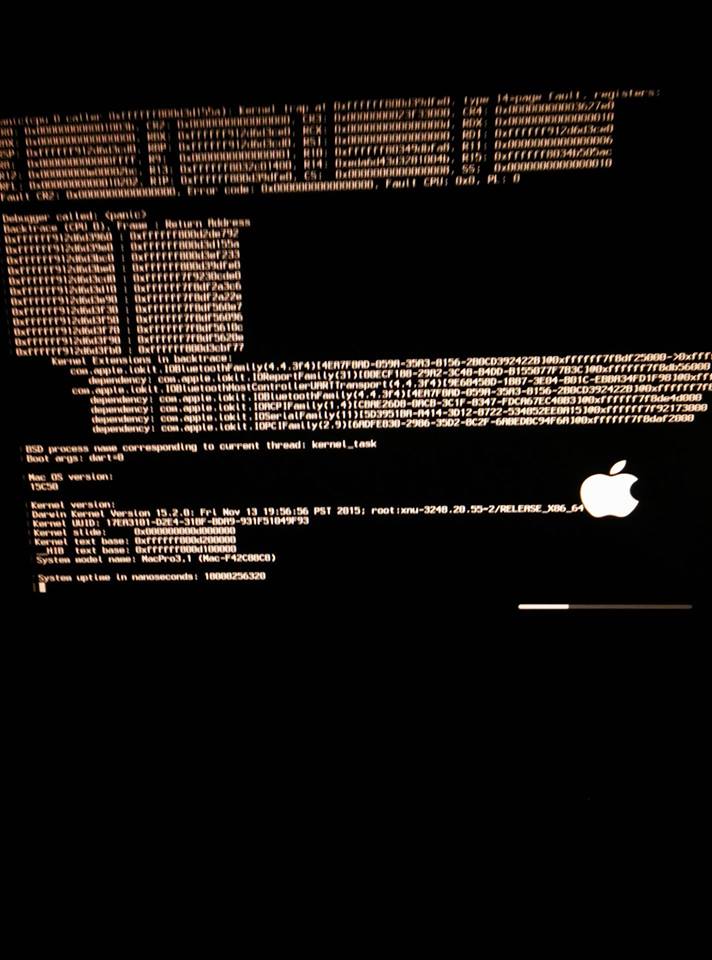

PhoeniXvG Posted January 26, 2016 Share Posted January 26, 2016 Hi everyone !I have a problem with my desktop, when I boot with clover and I start the installation, the logo of apple is here but at a moment, this message arrived and reboot to clover (My first boot option is my USB KEY)Screenshot: My desktop:MSI B150 PC MATEIntel Core i5-65002x4Go DDR4 G-Skill 2133 MhzNvidia GTX970So what is the problem ? Sorry for my bad english, I'm French.Thank You. Link to comment https://www.insanelymac.com/forum/topic/310619-skylake-reboot-at-loading/ Share on other sites More sharing options...
Appler Posted January 28, 2016 Share Posted January 28, 2016 disable serial port at bios that would fix the IOKit..... and add nv_disable=1. if it's still reboot but doesn't have that IOKit.... anymore try remove nvidia card Link to comment https://www.insanelymac.com/forum/topic/310619-skylake-reboot-at-loading/#findComment-2211043 Share on other sites More sharing options...
bergoulle Posted January 28, 2016 Share Posted January 28, 2016 Bluetooth related ? if any remove it or disable it. Link to comment https://www.insanelymac.com/forum/topic/310619-skylake-reboot-at-loading/#findComment-2211057 Share on other sites More sharing options...
