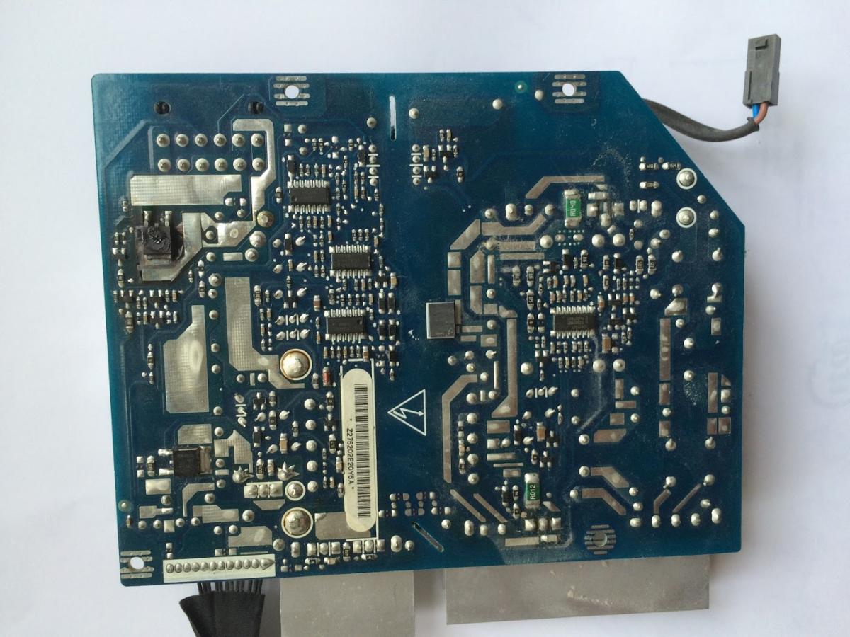

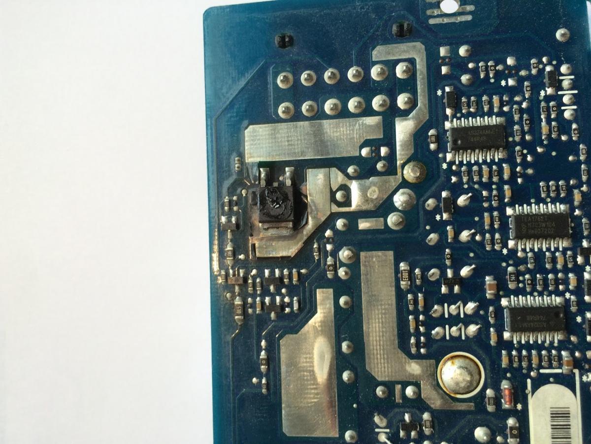

majorsun Posted January 18, 2016 Share Posted January 18, 2016 I have a 2007 24''imac that does not respond to power button pushes (Black screen, no chime, no nothing). From the threads in the forum and online, that usually suggests two possibilities: power, or video card. I took out the power board, and there is a burnt area as shown in the photos. Does it look like normal wear-and-tear, since this is the component that handles lot of heat (which means I will have to continue to find a way to test the video card)? Or, it is surely a dead board. Right now I don't have any replacement on hand to test. So I will need to decide wether to buy a power board (~$100), or a video card (>$150), or just throw the whole thing to ebay? Thanks Qi Link to comment https://www.insanelymac.com/forum/topic/310458-2007-imac-24-power-supply-fried/ Share on other sites More sharing options...
lucaspeed Posted January 18, 2016 Share Posted January 18, 2016 Looks like you had a current spike. Did you have your iMac plugged into a UPS? Or into a current stabilizer? I have an identical iMac with logic board dead but functioning power supply, video card, etc., I can sell you the power supply for less of that sum if you want but I have to arrange the shipping and I don't know how much it will cost. Where in the world are you? Link to comment https://www.insanelymac.com/forum/topic/310458-2007-imac-24-power-supply-fried/#findComment-2207959 Share on other sites More sharing options...
