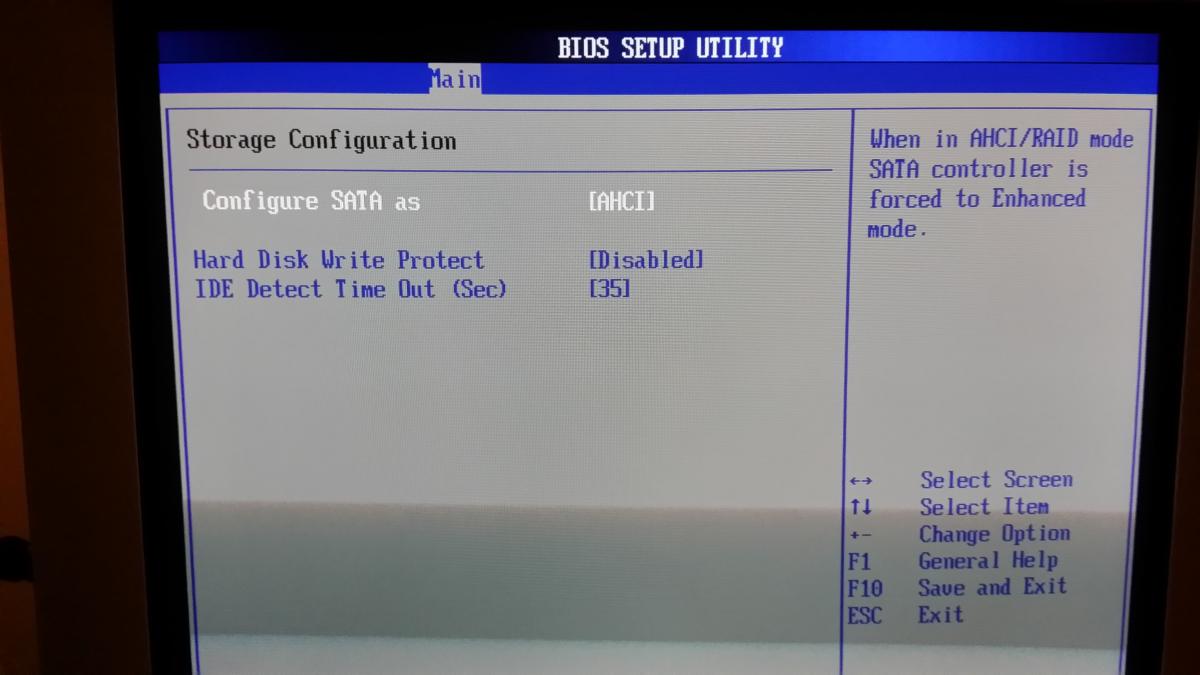

carbo178 Posted January 11, 2016 Share Posted January 11, 2016 Without NullCPUPM you can't boot? Try this: Create a new folder named Extensions into /Extra Copy/paste NullCPUPM into the new folder Delete NullCPUPM from S/L/E Reboot If you have a panic during boot, don't worry; reboot with -v -f Link to comment https://www.insanelymac.com/forum/topic/310273-problems-power-off-and-reboot-asus-rampage-ii-gene/page/2/#findComment-2205610 Share on other sites More sharing options...

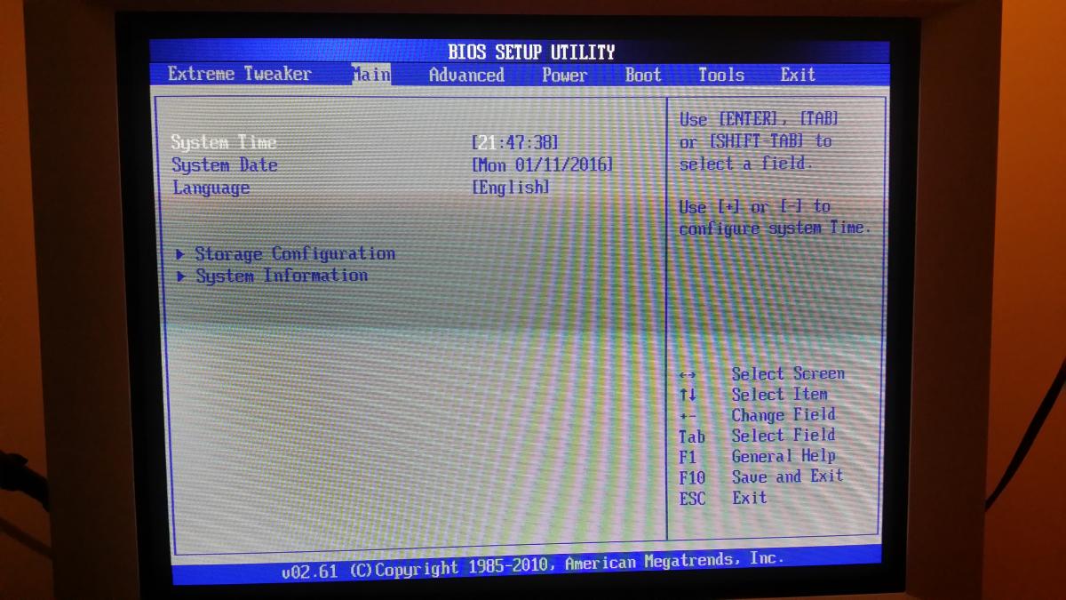

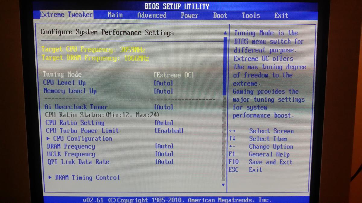

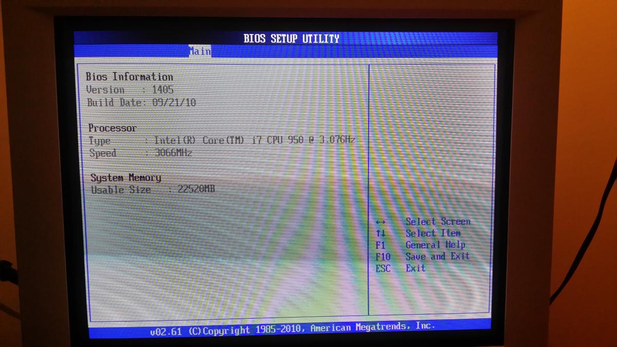

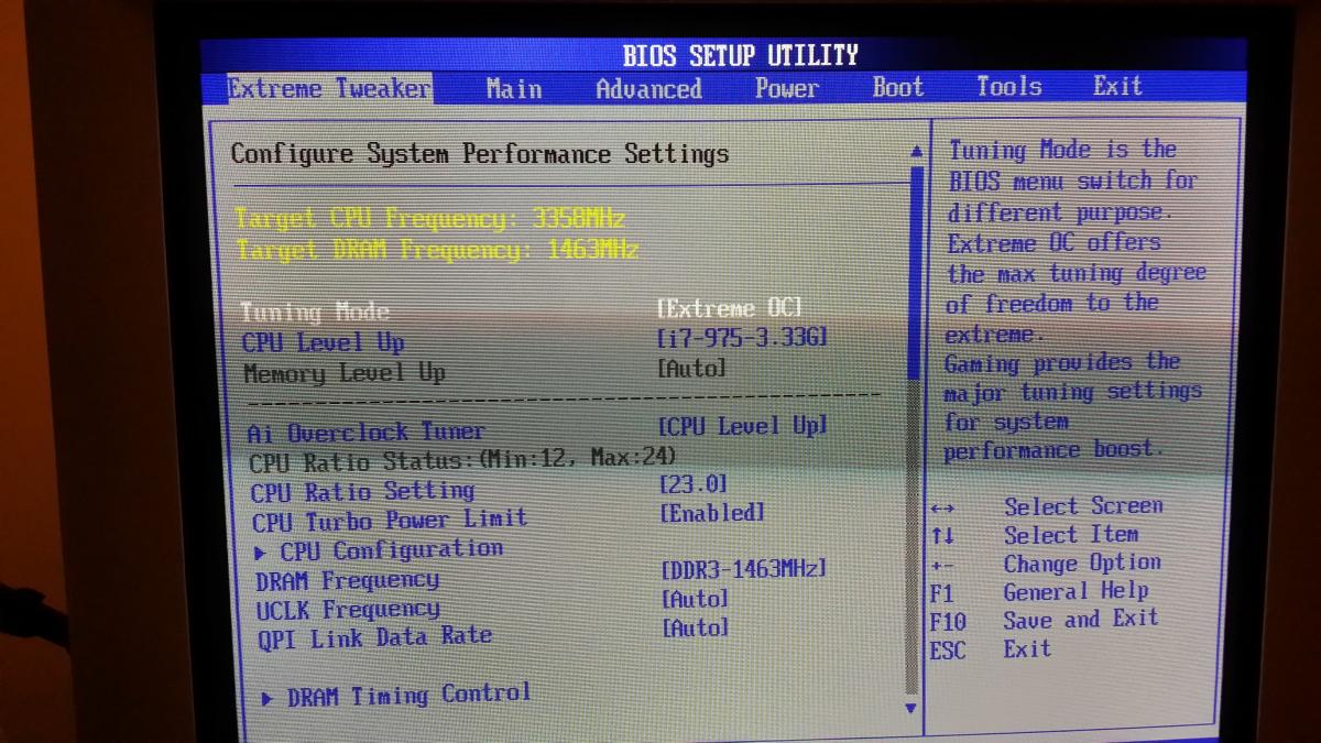

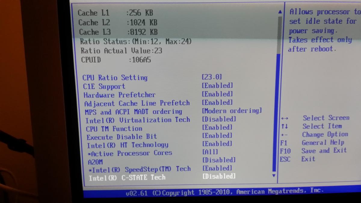

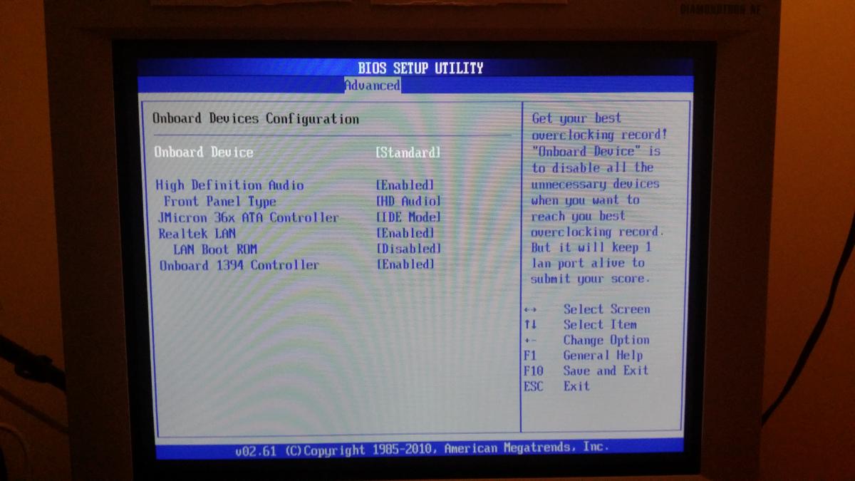

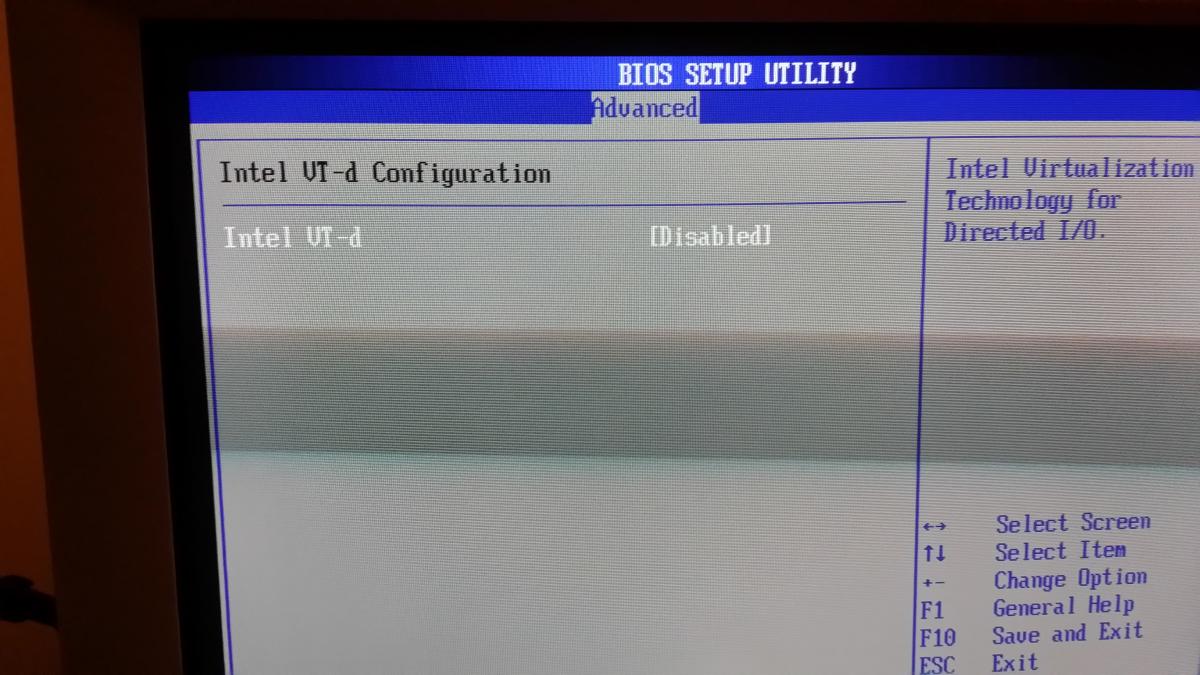

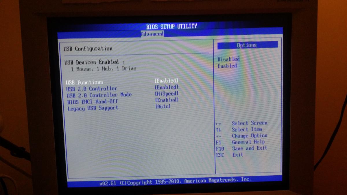

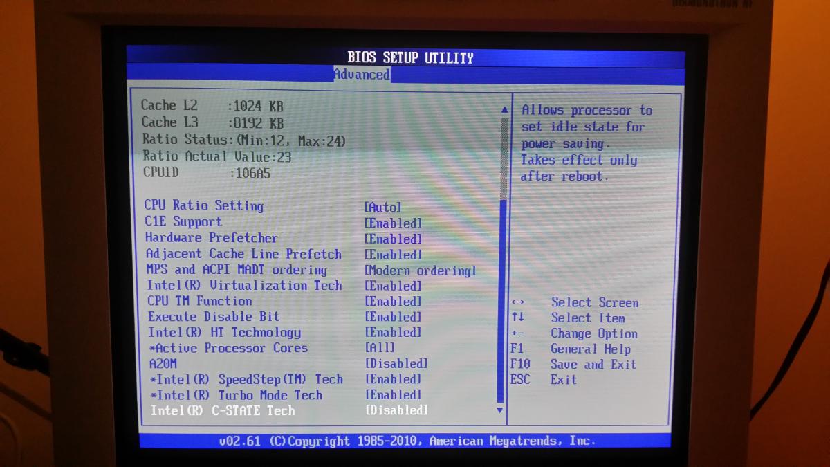

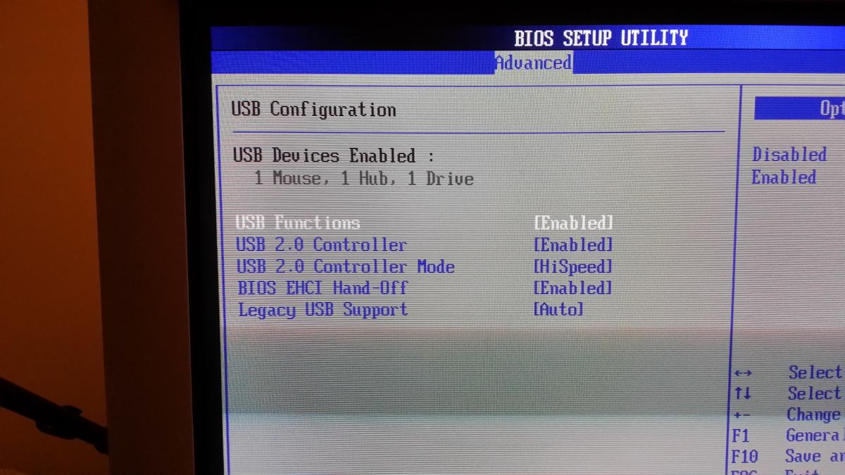

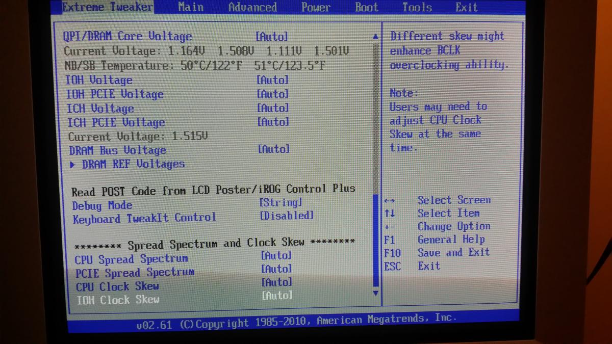

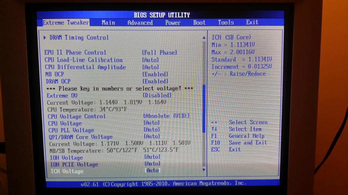

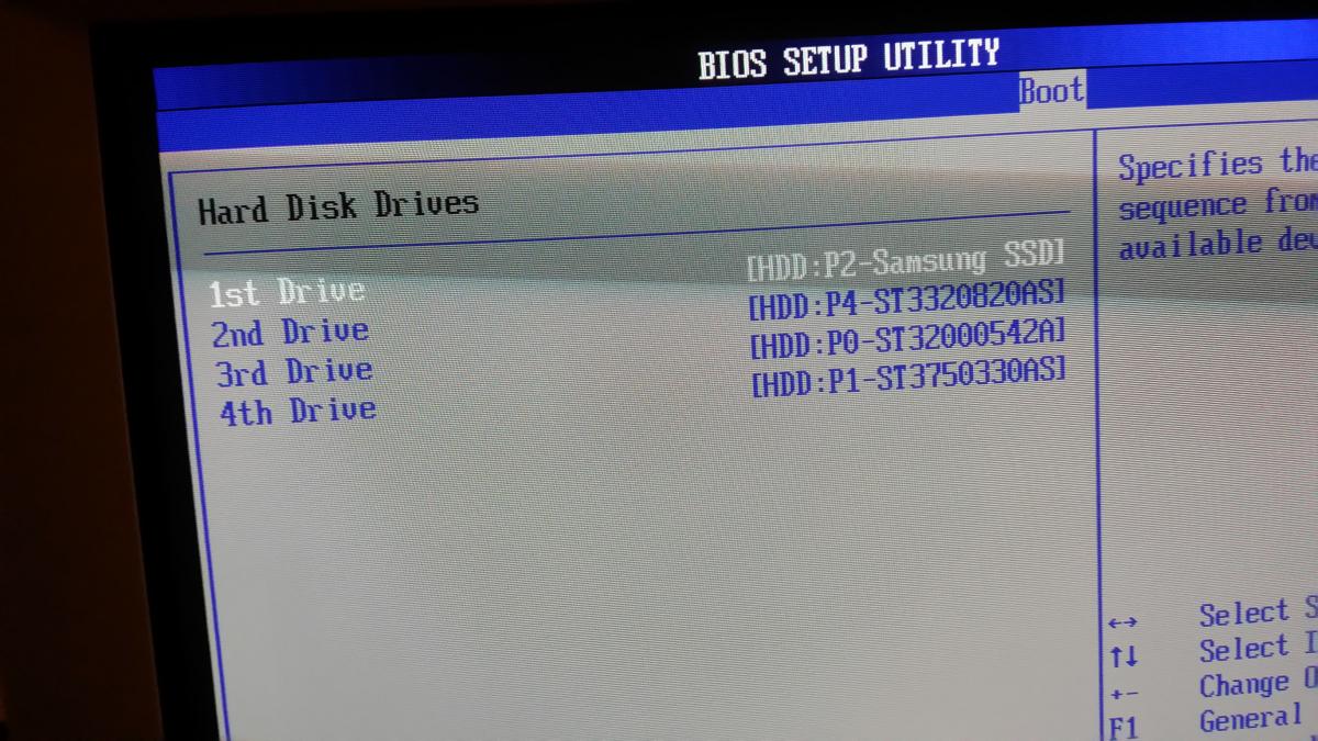

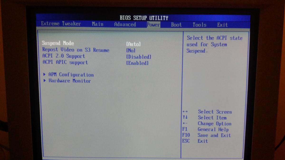

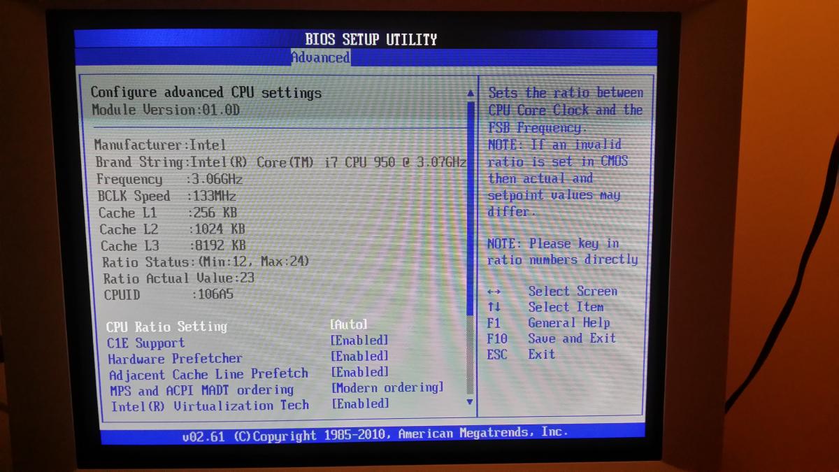

LuisImpreza Posted January 11, 2016 Author Share Posted January 11, 2016 Without NullCPUPM you can't boot? Try this: Create a new folder named Extensions into /Extra Copy/paste NullCPUPM into the new folder Delete NullCPUPM from S/L/E Reboot If you have a panic during boot, don't worry; reboot with -v -f Ok companion, I try new, two minute friend. Thanks thanks thanks!!! I test, not result .. Not error CPU panic. I send for you my configuration bios real Now, not OC CPU and not OC Ram friend Link to comment https://www.insanelymac.com/forum/topic/310273-problems-power-off-and-reboot-asus-rampage-ii-gene/page/2/#findComment-2205615 Share on other sites More sharing options...
carbo178 Posted January 11, 2016 Share Posted January 11, 2016 Last try: Reset bios to default and post the same screenshot Link to comment https://www.insanelymac.com/forum/topic/310273-problems-power-off-and-reboot-asus-rampage-ii-gene/page/2/#findComment-2205631 Share on other sites More sharing options...
LuisImpreza Posted January 11, 2016 Author Share Posted January 11, 2016 Last try: Reset bios to default and post the same screenshot Done, load system, not problems, not reboot and not power off Link to comment https://www.insanelymac.com/forum/topic/310273-problems-power-off-and-reboot-asus-rampage-ii-gene/page/2/#findComment-2205634 Share on other sites More sharing options...

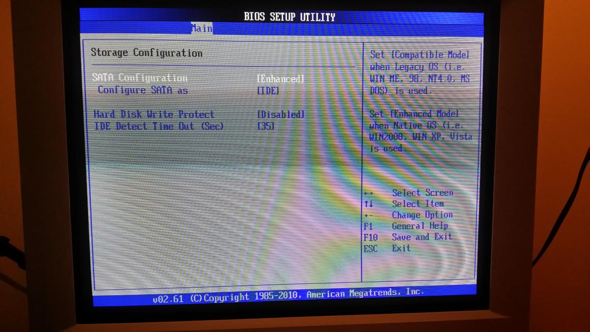

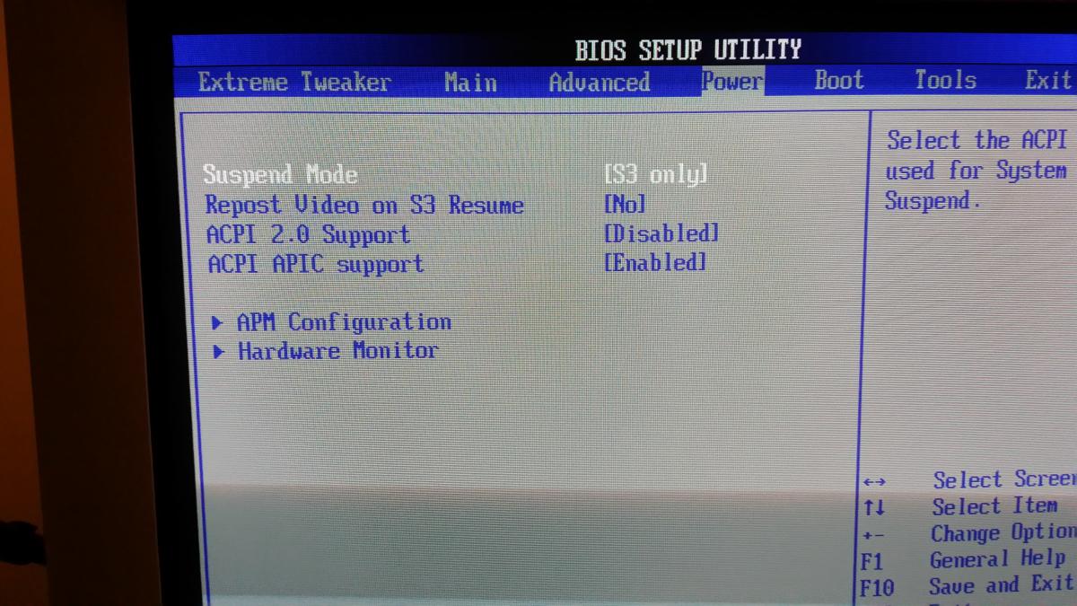

carbo178 Posted January 11, 2016 Share Posted January 11, 2016 Changes in bios: SATA configuration: AHCI Suspend Mode: S3 Only Reboot Link to comment https://www.insanelymac.com/forum/topic/310273-problems-power-off-and-reboot-asus-rampage-ii-gene/page/2/#findComment-2205638 Share on other sites More sharing options...
LuisImpreza Posted January 11, 2016 Author Share Posted January 11, 2016 Changes in bios: SATA configuration: AHCI Suspend Mode: S3 Only Reboot I test now Friend. Two minutes Changes done, same problem, I power off and reboot and forever screen off computer on... Thanks for your time companion Link to comment https://www.insanelymac.com/forum/topic/310273-problems-power-off-and-reboot-asus-rampage-ii-gene/page/2/#findComment-2205664 Share on other sites More sharing options...
