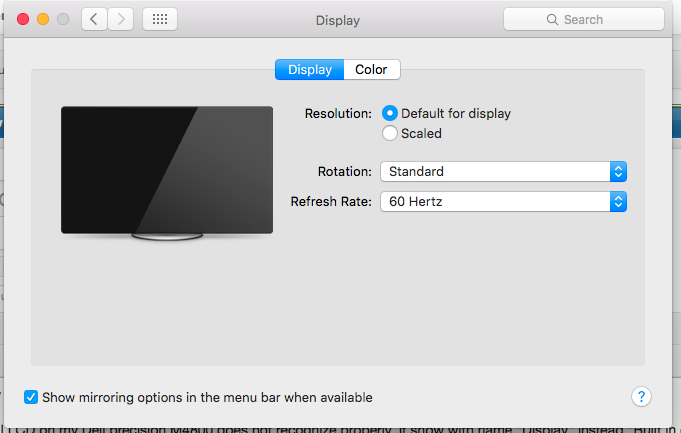

vanquybn Posted January 4, 2016 Share Posted January 4, 2016 Happy new year 2016!The Internal LCD on my Dell precision M4800 does not recognize properly, It show with name "Display" instead "Built in display" I have tried inject Graphic card in DSDT, clover inject, EDID, changed SMBIOS (MBP 11,1/11,2/11,3) ...however none of them effected to LCD.Any suggest/advise will be appreciated! Link to comment https://www.insanelymac.com/forum/topic/310180-internal-lcd-does-not-recognize-properly/ Share on other sites More sharing options...

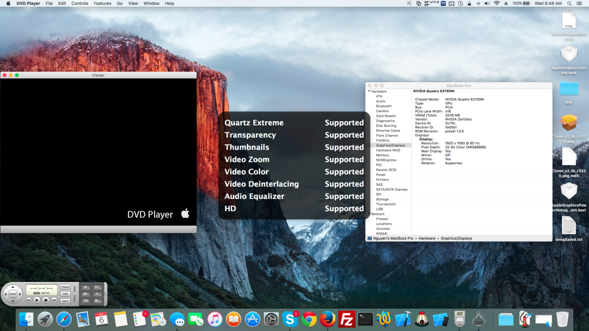

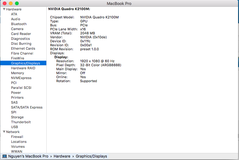

HUSABER Posted January 4, 2016 Share Posted January 4, 2016 Happy new year 2016! The Internal LCD on my Dell precision M4800 does not recognize properly, It show with name "Display" instead "Built in display" Screen Shot 2016-01-04 at 9.46.13 AM.png Screen Shot 2016-01-04 at 9.46.37 AM.png Screen Shot 2016-01-04 at 9.47.35 AM.png I have tried inject Graphic card in DSDT, clover inject, EDID, changed SMBIOS (MBP 11,1/11,2/11,3) ... however none of them effected to LCD. Any suggest/advise will be appreciated! me try this for cinema display http://www.insanelymac.com/forum/topic/208410-fixing-scrambledstretched-or-wrong-resolution-laptop-display-problems/ Link to comment https://www.insanelymac.com/forum/topic/310180-internal-lcd-does-not-recognize-properly/#findComment-2202650 Share on other sites More sharing options...

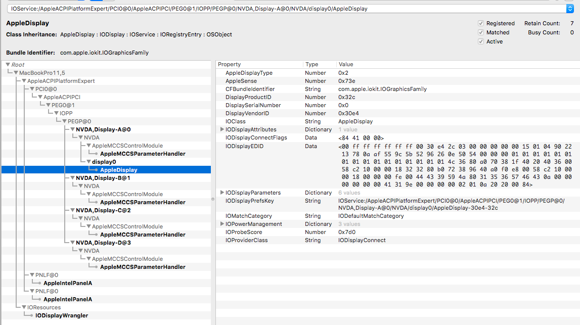

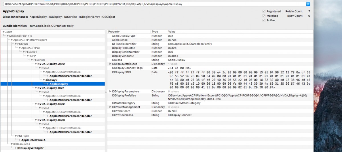

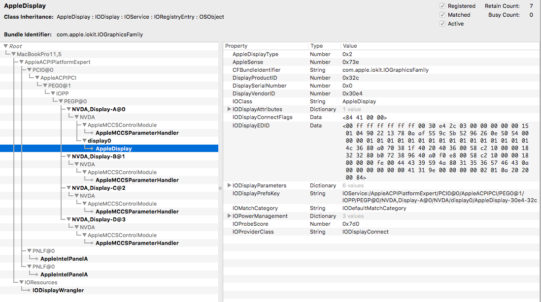

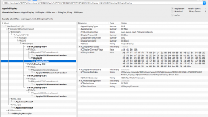

vanquybn Posted January 6, 2016 Author Share Posted January 6, 2016 Other than not being reported as "built-in LCD Display", are there any other problems? The LCD is clearly detected as Apple Display under display0 of the 1st nVidia framebuffer, so that's Ok. Are you getting your resolution Ok? Are you getting full graphics acceleration at all? Can you post a screenshot of the AppleDisplay IOReg content under NVDA,Display-A@0->display0 ? I would expect this to show the detected EDID. Try the attached SMBIOS, but no guarantee it'll work... smbios.plist.zip Thank you for reply: Are you getting your resolution Ok? => Yes, I get full resolution on both internal LCD and external display via HDMI Are you getting full graphics acceleration at all? => Yes, I get full graphics acceleration on both internal LCD and external display via HDMI Can you post a screenshot of the AppleDisplay IOReg content under NVDA,Display-A@0->display0 ? I would expect this to show the detected EDID. => Yes, EDID is detected properly: I have tried your SMBIOS configuration, but there is no different. Link to comment https://www.insanelymac.com/forum/topic/310180-internal-lcd-does-not-recognize-properly/#findComment-2203331 Share on other sites More sharing options...

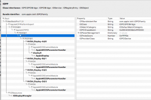

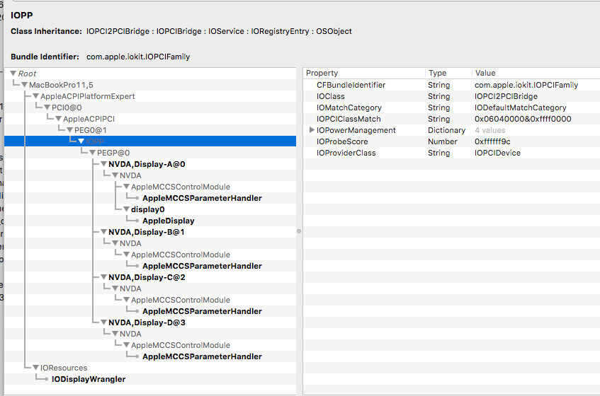

vanquybn Posted January 7, 2016 Author Share Posted January 7, 2016 Attached file is my IOREg and DSDT. It is already patched Device PNLF Please be noted that your NVD graphic cards is real "built in", it's built in your main board. My NVD graphic cards is not built-int, it is "plug and play" with bus "MXM 3.1 Type A". So i think this is cause of problem. Archive.zip Link to comment https://www.insanelymac.com/forum/topic/310180-internal-lcd-does-not-recognize-properly/#findComment-2203720 Share on other sites More sharing options...

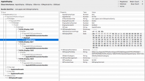

vanquybn Posted January 8, 2016 Author Share Posted January 8, 2016 I have tried the DSDTs, but it still the same: DSDT1: DSDT2: Link to comment https://www.insanelymac.com/forum/topic/310180-internal-lcd-does-not-recognize-properly/#findComment-2204163 Share on other sites More sharing options...
