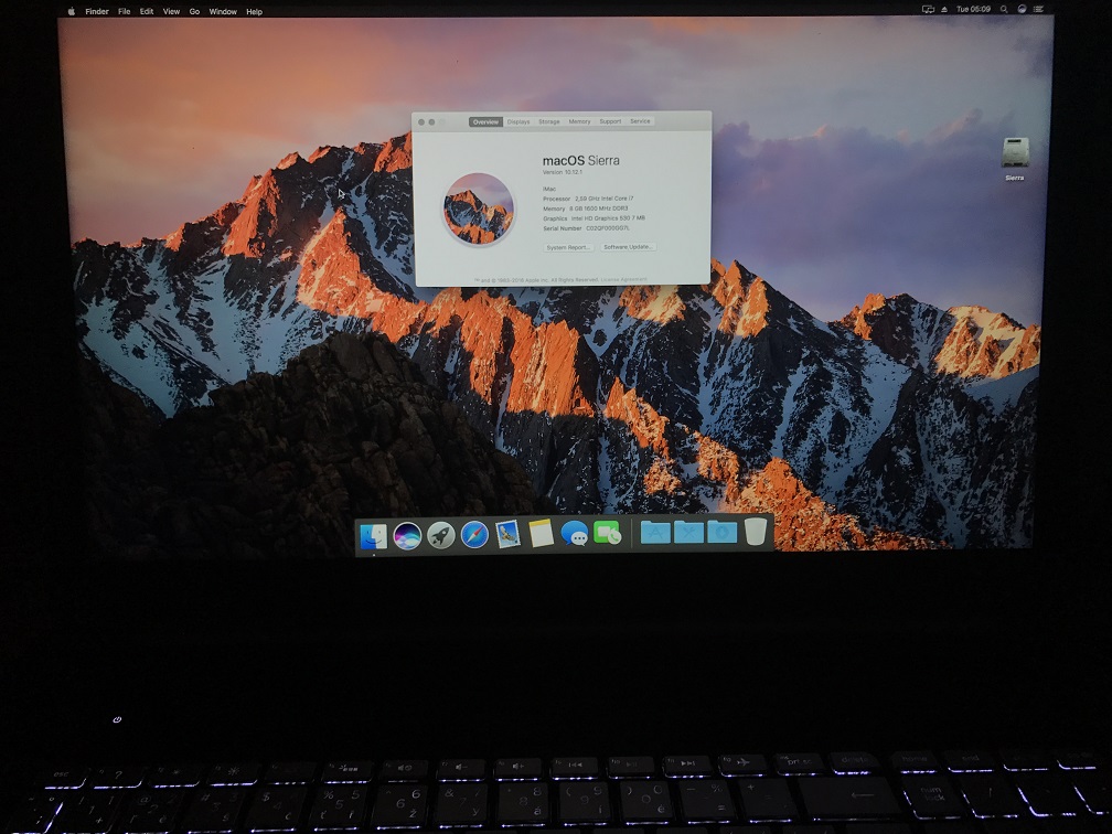

Mikoman Posted December 13, 2016 Author Share Posted December 13, 2016 So i have managed to fix some things. Top left of the screen is a little bit glitchy but if you are not paying attention you wont even notice. Fixed by adding: <key>Device</key> <string>IntelGFX</string> <key>Key</key> <string>AAPL,GfxYTile</string> <key>Value</key> <string>AQAAAA==</string> Thanks to PikeRalpha and guys on forum. Turned out there is no need to patch the SKLbuffer kext. Its working OOB with same plist (fakeid 191b0000) for elcpt. I had issue with SATA, Sierra did not recognised any SATA device just USB. But AHCI Injector fixed the issue (it was not needed in elcpt though). VoodooPS2 was causing kernel panic but the latest version fixed it. Working: full resolution with acceleration, sound, mic, webcam, touchpad, keyboard, BT, LAN, imessage Not working: wifi, nvidia, hdmi, sleep I bought cheap nano USB wifi dongle so this is my current workaround for wifi. The speedstep is working but it can't reach turbo states. So im limited to 2.6GHz for the moment. I will post a tutorial soon. Link to comment https://www.insanelymac.com/forum/topic/310013-hp-envy-17-6700hq-intel-hd-530-partially-working/page/5/#findComment-2333331 Share on other sites More sharing options...

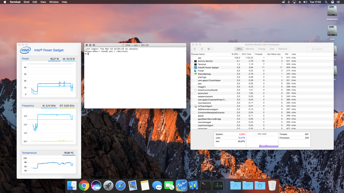

Mikoman Posted December 13, 2016 Author Share Posted December 13, 2016 So by generating ssdt.aml and placing it into /EFI/CLOVER/ACPI/Patched unlocked the turbo states but im still not sure if im getting all the power from it. update: removed all C and P states generation from clover. Left only with ssdt.aml I bit better but im still missing 300MHz somewhere. update: imessage started to work. After few reboots it just works 1 Link to comment https://www.insanelymac.com/forum/topic/310013-hp-envy-17-6700hq-intel-hd-530-partially-working/page/5/#findComment-2333391 Share on other sites More sharing options...
