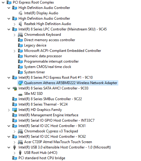

coolstarorg Posted December 11, 2015 Share Posted December 11, 2015 Specs: CPU: Intel Core i3-4005U Chipset: Lynx-Point RAM: 4 GB DDR3 GPU: Intel HD 4400 Graphics (PCI ID 8086:0a16) Audio: Realtek ALC283 WiFi: Atheros AR9462 (although I have a USB Edimax EW-7811un I can use) SSD: 128 GB Keyboard is PS2. Trackpad & Touch Screen are on I2C bus. Changes applied to coreboot BIOS: 1. USB routed to EHCI bus at cold boot and routed to XHCI via ACPI in _OSC. This gets Clover, OS X and Windows 8/10 booting properly from USB 2. The Intel ME device has been re-enabled (PCI ID 8086:9C3A) 3. I2C Controllers were switched from PCI mode to ACPI mode so they work correctly in Windows. 4. DSDT Patches for Battery so battery status works correctly in Windows and OS X Bootloader used: SeaBIOS + Clover EFI I'm trying to run OS X 10.10.5. Kexts Used: 1. VoodooPS2Controller 2. VoodooBattery 3. FakeSMC 4. ACPIBacklight Currently OS X is able to boot to the installer. However, there doesn't appear to be any graphics acceleration as there's noticeable tearing :/ Keyboard is dead, as well as touchpad and touch screen (last 2 expected due to I2C but keyboard is PS2). Haven't verified Audio yet as I haven't installed yet but I'd like to get graphics acceleration and audio working. I have attached a screenshot of device manager on my C720P so you can see I indeed have the MEI device enabled. 1 Link to comment https://www.insanelymac.com/forum/topic/309819-acer-c720p-core-i3-patched-bios-progress/ Share on other sites More sharing options...
