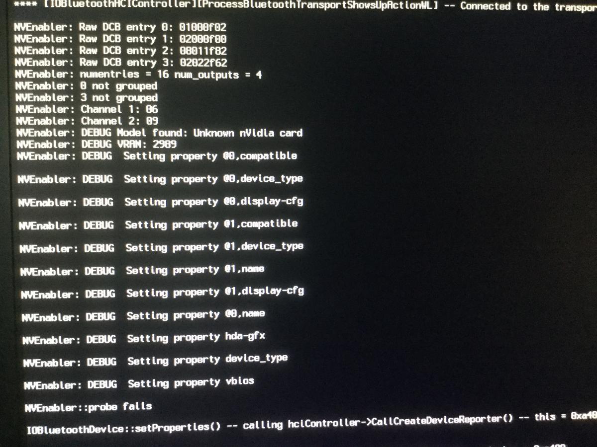

Guest Posted November 30, 2015 Share Posted November 30, 2015 So I'm having issues with this. I have an older HD5000 ATI already installed and working (with some shader issues, but it works well) and wanted to update to a better card Installed the NVidia web drivers, tried a ton of different boot flags. I can get it to work with NV_disable=1 in terms of getting it to the desktop, but it's super laggy. The web driver menu doesn't recognize the card either. Yosemite 10.10.5 EVGA GTX 750TI SC 2gig Gigabyte Z97N-WIFI Attached is the NVenabler message when in -v mode as well as my config.plst Anyone know of anything else i'm missing? Thanks for the help, I really tried to research this before asking. Link to comment https://www.insanelymac.com/forum/topic/309650-evga-gtx-750ti-sc-issues/ Share on other sites More sharing options...
mitch_de Posted December 2, 2015 Share Posted December 2, 2015 I think the Nvenabler didnt know the gpu type of your card. I dont know where is the source code to change that - perhaps ypu ask for NVenabler developers to update (old!) Nvenabler for usage with new gpus. Link to comment https://www.insanelymac.com/forum/topic/309650-evga-gtx-750ti-sc-issues/#findComment-2193594 Share on other sites More sharing options...
