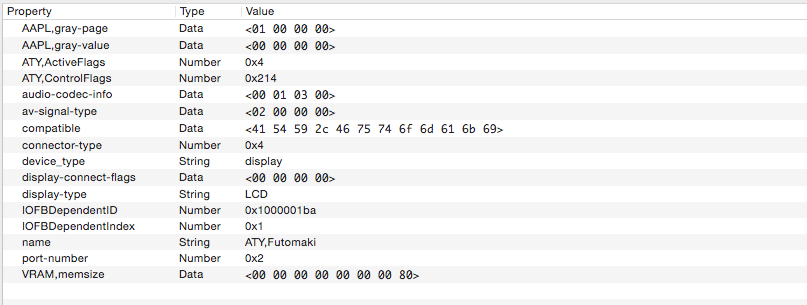

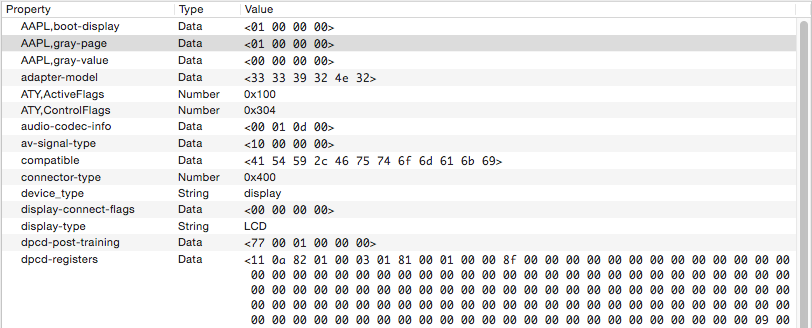

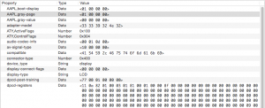

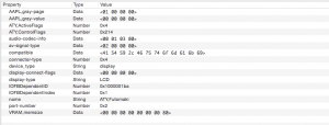

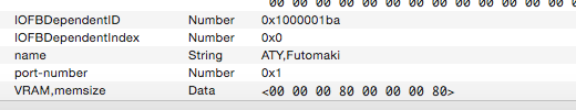

computerlife22 Posted November 28, 2015 Author Share Posted November 28, 2015 OK... it appears that Clover isn't actually patching the kext so I'm gonna just patch it by hex using this guide: http://www.insanelymac.com/forum/topic/249642-editing-custom-personalities-for-ati-radeon-hd45xxx/ Current hex edit: 0000000: 0004 0000 0403 0000 0001 0101 1204 0401 ................ //Displayport, this works already 0000010: 0004 0000 0403 0000 0001 0201 2205 0502 ............"... //Second Displayport, not being used 0000020: 0400 0000 1400 0000 0001 0000 0003 0506 ................// According to IOReg this is the DVI port 0000030: 0008 0000 0402 0000 0001 0400 1102 0103 ................ // hdmi????? I'm using the Futomaki personality base... will post logs shortly OK so I get a system freeze (black screen on all 3 with spinning beach ball) if I try to have all three plugged in, otherwise if I have one monitor it works. I am unsure how to get an ioreg of all three monitors UPDATE: I got two monitors working temporarily by unplugging and plugging in the DisplayPort monitor into port number 1 (second display port). Here are some IO Reg logs from DVI and Displayport2 at the same time: Link to comment https://www.insanelymac.com/forum/topic/309606-xfx-r9-270x-multi-monitor-issues/#findComment-2192511 Share on other sites More sharing options...
