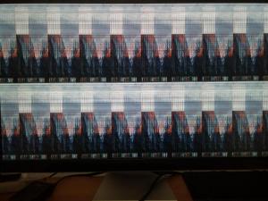

longxk Posted November 8, 2015 Share Posted November 8, 2015 Intel i5-4590 processorAsus H97i-Plus moboGigabyte GTX750Ti with a 4K@60Hz display via DisplayportJust installed El Capitan(10.11.1), my video card is not supported, so I installed nvidia web driver for El Capitan. With argument "nvda_drv=1", boot is ok, but the display is distorted.current bootloader is clover, have tried many boot args with no luck, the display is either distorted or at 1280x1024 resolution. With "nvda_drv=1" and connected with TeamViewer, I see the video card is recognized correctly, it has correct model name and vram. But the resolution is at 1920*1080 with another option:1366*768. so is there any way to force resolution to 4k?please help, thanks. Link to comment https://www.insanelymac.com/forum/topic/309281-el-capitan-with-gtx750ti-on-4k-via-displayport-display-distorted/ Share on other sites More sharing options...
longxk Posted November 10, 2015 Author Share Posted November 10, 2015 OK, finally get this problem solved.Somebody mentioned that the driver may have a pixel clock limit or framebuffer size limit, but most cases I found are Intel HD Graphics.Then I thought the problem may come from the display side, the display is either not recognized or recognized incorrectly. Mine is recognized as a 30.5-inch 1920x1080 display, which is not correct. In this case a EDID path may solve the problem. So I extracted EDID info in Windows, and put it in Clover's custom EDID, but didn't work.I googled for this, found El Capitan's EDID patch may be different, because there is no /System/Library/Displays/Overrides at all. But there is another app called FixEDID which claimes it has support for El Capitan. Open your EDID binary file, choose path only, select "Add/Fix Monitor Ranges" and click Make. Install that generated kext file, the display will be fine now. Link to comment https://www.insanelymac.com/forum/topic/309281-el-capitan-with-gtx750ti-on-4k-via-displayport-display-distorted/#findComment-2187155 Share on other sites More sharing options...
