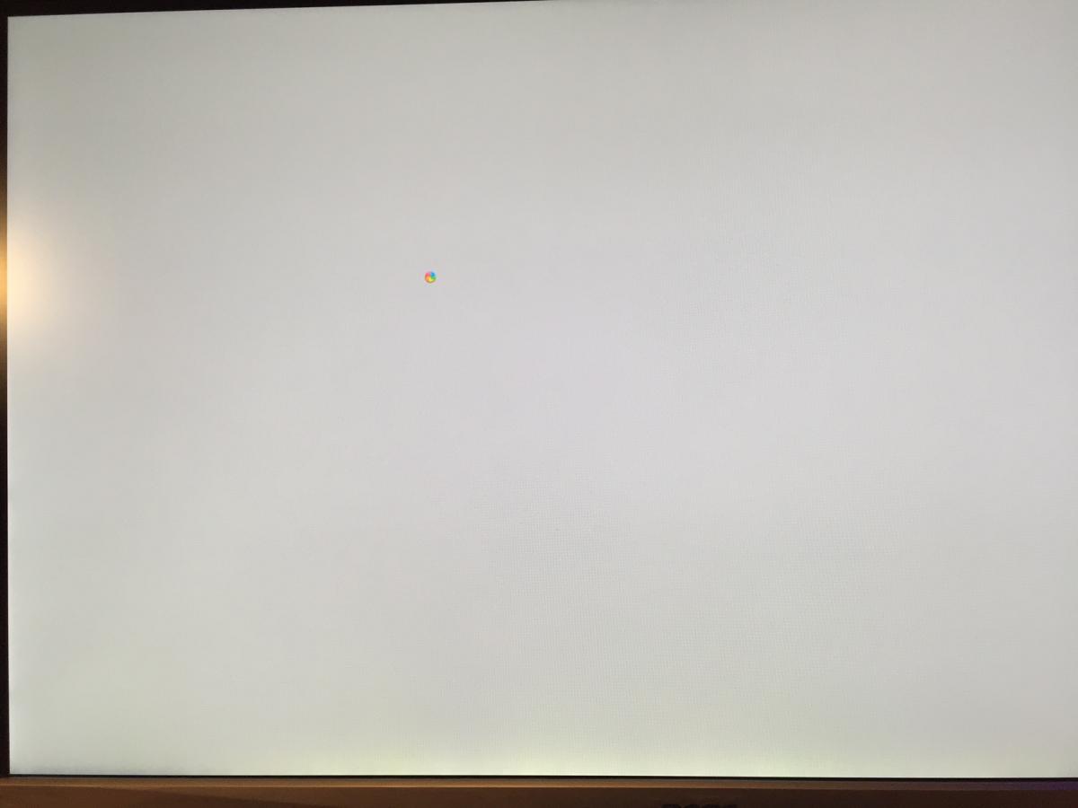

Lordie Posted November 7, 2015 Share Posted November 7, 2015 Been following the other 13 page thread on the current installation status and I keep getting stuck on this screen no matter what I try. My settings are as follows: Hardware: MSI Z170 Gaming M5 Intel i5-6600K Geforce GTX 980Ti 16gig DDR4 RAM BIOS Settings:Vt-d disabled Primary graphics is PCIE-E Sata controller is in XHCI OS mode is windows 8/10 WHQL Serial port disabled UEFI boot mode (I am unable to attach my config.plist and DSDT, so uploaded to google drive). https://drive.google.com/file/d/0B91VziDu2ARVM2owM2Nhb24wOGc/view?usp=sharing https://drive.google.com/file/d/0B91VziDu2ARVSWU2elFIcjNac1E/view?usp=sharing Clover boot loader version 3320 if that helps. I have attached my clover plist and the extracted DSDT.aml. I use no other kexts (other than pike's IOAPIC table overrides). Any ideas on what may be going wrong here? Its stuck in this screen for hours (I tried waiting for 4-5 hours to see if it continues installation). The only other thing I did was remove vboxhfs-64.efi and add hfsplus.efi instead. Cheers! Link to comment https://www.insanelymac.com/forum/topic/309256-stuck-on-white-screen-with-msi-z170-gaming-m5-and-6600k/ Share on other sites More sharing options...

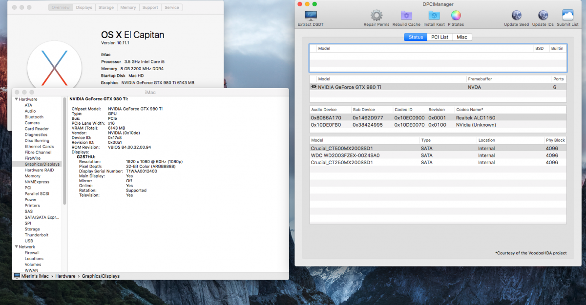

Lordie Posted November 7, 2015 Author Share Posted November 7, 2015 Thanks a lot guys, finally got it up and running yesterday night, with help from all of your configs and everyone else's research! Theres one thing thats bugging me that is the TPLink WDN4800 not being detected at all, going to look into it today. Wondering if anyone else had this problem in their skylake setup? Link to comment https://www.insanelymac.com/forum/topic/309256-stuck-on-white-screen-with-msi-z170-gaming-m5-and-6600k/#findComment-2186346 Share on other sites More sharing options...

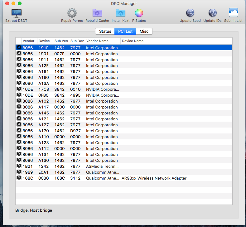

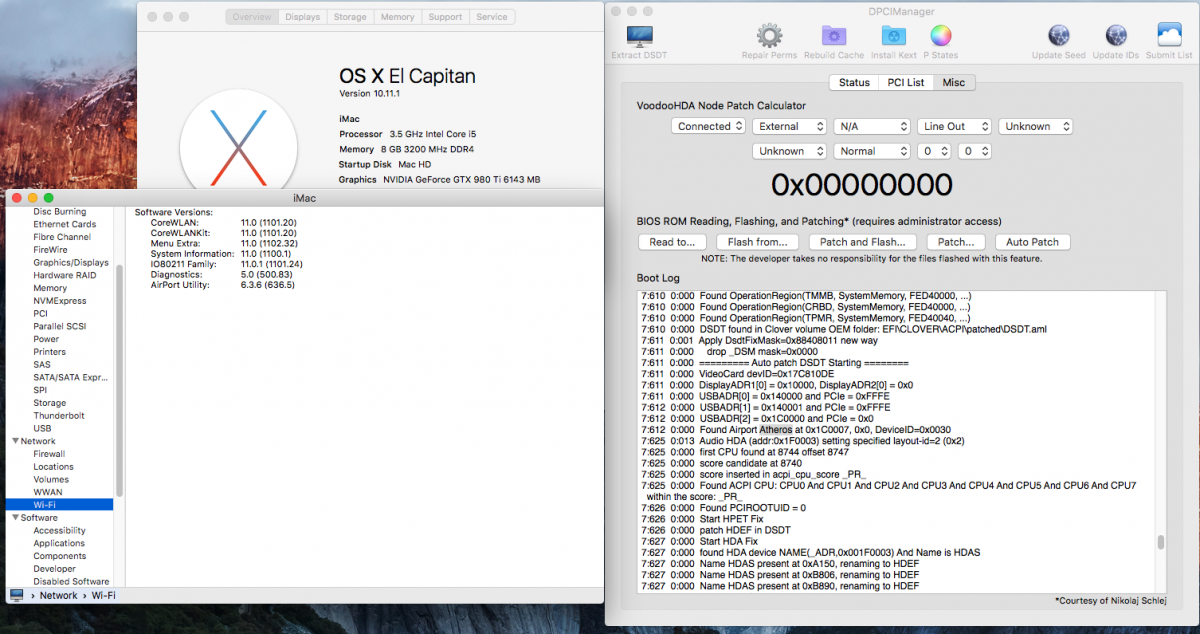

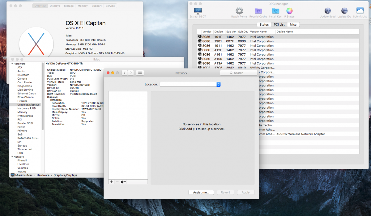

Lordie Posted November 7, 2015 Author Share Posted November 7, 2015 This is what I got so far, got the nvidia drivers to work but nothing else shows up on DPCIManager. Am i doing something wrong with kexts (for TP Link WDN4800?). Not able to figure out whats wrong. Here is my config.plist https://drive.google.com/open?id=0B91VziDu2ARVM2owM2Nhb24wOGc Here is my DSDT https://drive.google.com/open?id=0B91VziDu2ARVSWU2elFIcjNac1E Do let me know if y'all have any ideas on this Cheers DarwinDumper_2.9.9_AMI_X64_3320_Cap_Mierin.zip Link to comment https://www.insanelymac.com/forum/topic/309256-stuck-on-white-screen-with-msi-z170-gaming-m5-and-6600k/#findComment-2186429 Share on other sites More sharing options...
Lordie Posted November 8, 2015 Author Share Posted November 8, 2015 Tried a lot of different solutions but still no WiFi (even though TPlink TLWDN4800 is supposed to work OOB) and the same card works perfectly fine on windows. The interface doesn't show up on the system report at all and the bootlogs from DPCIManager show that the Atheros was found. Still super stumped on what could be wrong here Link to comment https://www.insanelymac.com/forum/topic/309256-stuck-on-white-screen-with-msi-z170-gaming-m5-and-6600k/#findComment-2186813 Share on other sites More sharing options...
bomerr Posted November 9, 2015 Share Posted November 9, 2015 the driver isn't loaded Link to comment https://www.insanelymac.com/forum/topic/309256-stuck-on-white-screen-with-msi-z170-gaming-m5-and-6600k/#findComment-2186859 Share on other sites More sharing options...
Lordie Posted November 9, 2015 Author Share Posted November 9, 2015 the driver isn't loaded Any idea on why it isn't loading? Link to comment https://www.insanelymac.com/forum/topic/309256-stuck-on-white-screen-with-msi-z170-gaming-m5-and-6600k/#findComment-2186871 Share on other sites More sharing options...
Lordie Posted November 10, 2015 Author Share Posted November 10, 2015 From IOReg explorer, the acpi-path for this card is IOACPIPlane:/_SB/PCI0@0/RP08@1c0007/PXSX@0. I thought maybe its a DSDT problem and tried overwriting methods for Device (RP08) from Andres's DSDT, his ACPI path was (IOACPIPlane:/_SB/PCI0@0/RP04@1c0003/PXSX@0) but again nothing has changed, so I don't think its anything related to the DSDT. Will continue exploring! Link to comment https://www.insanelymac.com/forum/topic/309256-stuck-on-white-screen-with-msi-z170-gaming-m5-and-6600k/#findComment-2187130 Share on other sites More sharing options...

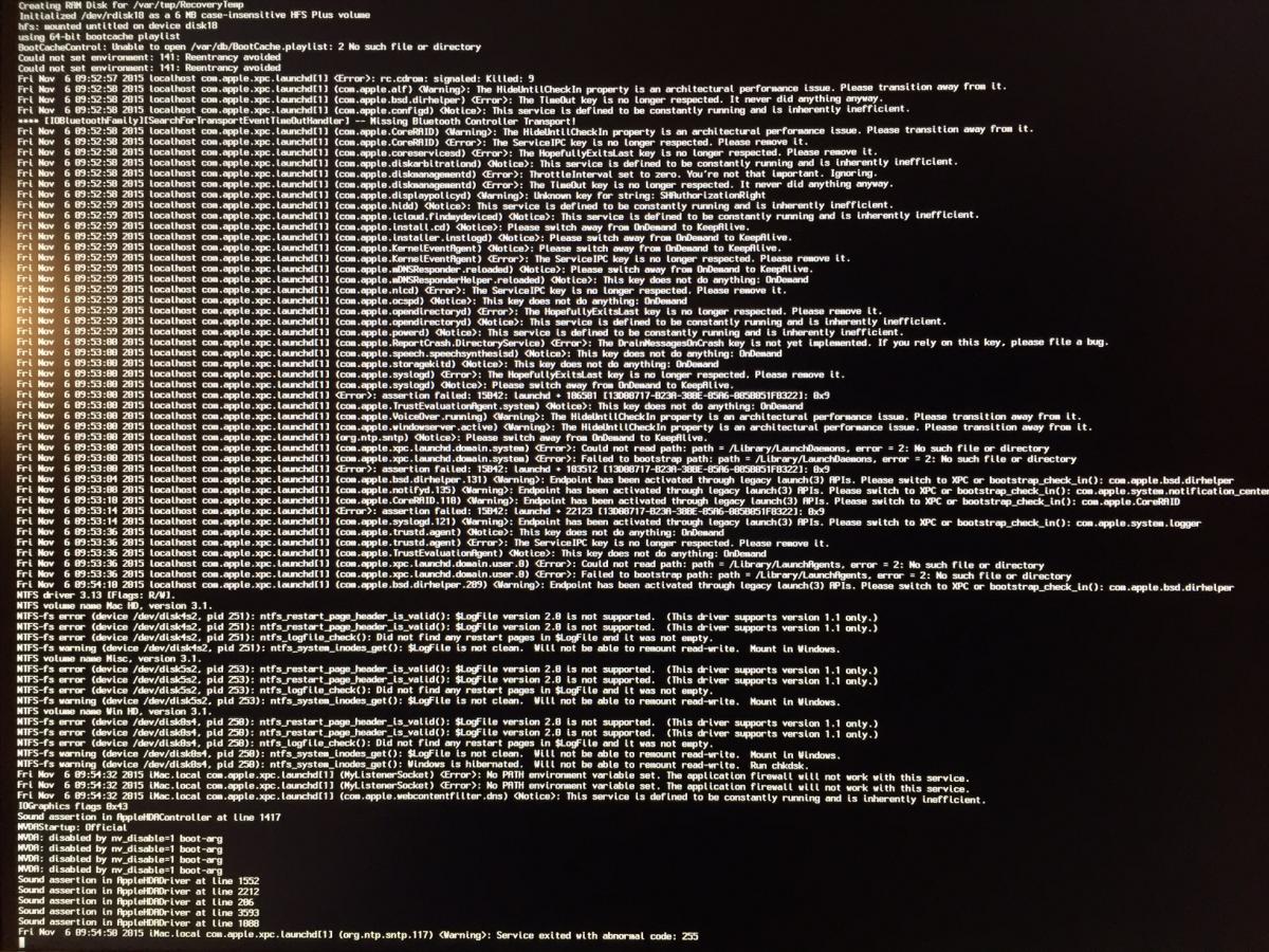

fronskild Posted December 27, 2015 Share Posted December 27, 2015 I have same problem , as post 1# my pc. I use Lorde Plist file. I stuck att service exited with abnormal code 255 Intel Core i5 6600K Skylake – DDR4 Corsair 8 GB (2*4) 2133MHz – SSD Kingston Hyper X Fury 120 GB – MSI nVidia GeForce GTX970 Gaming 4 GB MSI Z170 any idea thanks in advanced Link to comment https://www.insanelymac.com/forum/topic/309256-stuck-on-white-screen-with-msi-z170-gaming-m5-and-6600k/#findComment-2200924 Share on other sites More sharing options...
