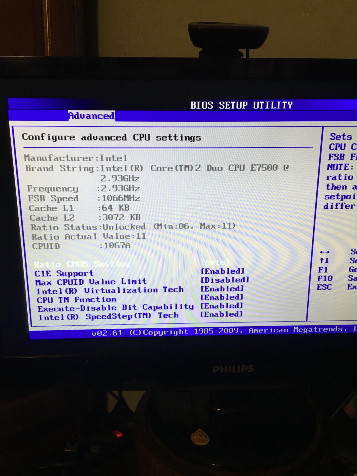

Simox Posted January 14, 2016 Share Posted January 14, 2016 Ok solved, fix the guide: limit CPUID MaxVal= disable or kernel panic at boot Link to comment https://www.insanelymac.com/forum/topic/309035-guide-asus-p5g41t-m-lx-el-capitan-success/#findComment-2206573 Share on other sites More sharing options...

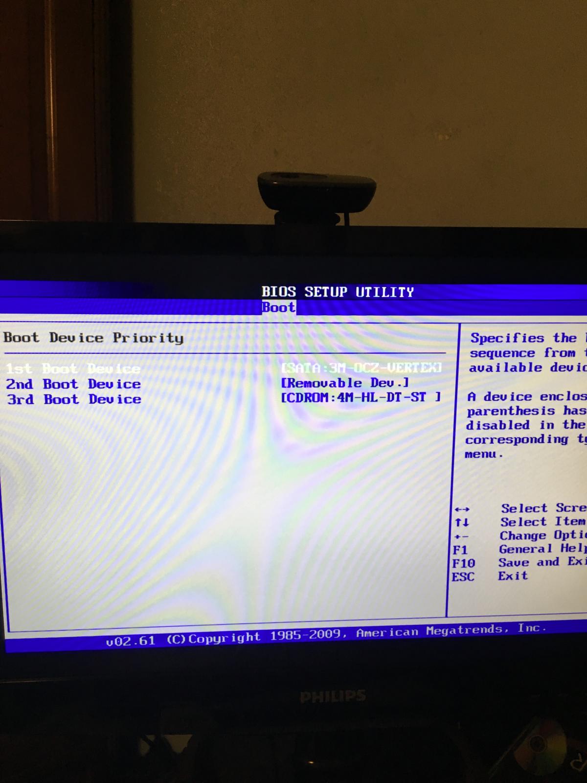

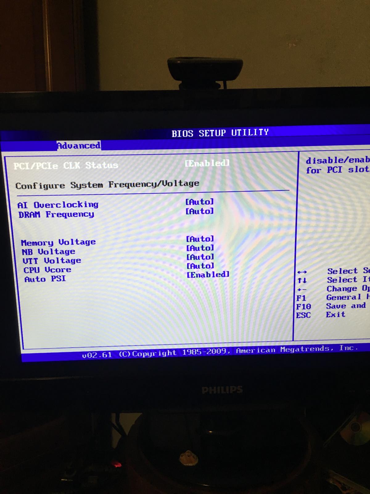

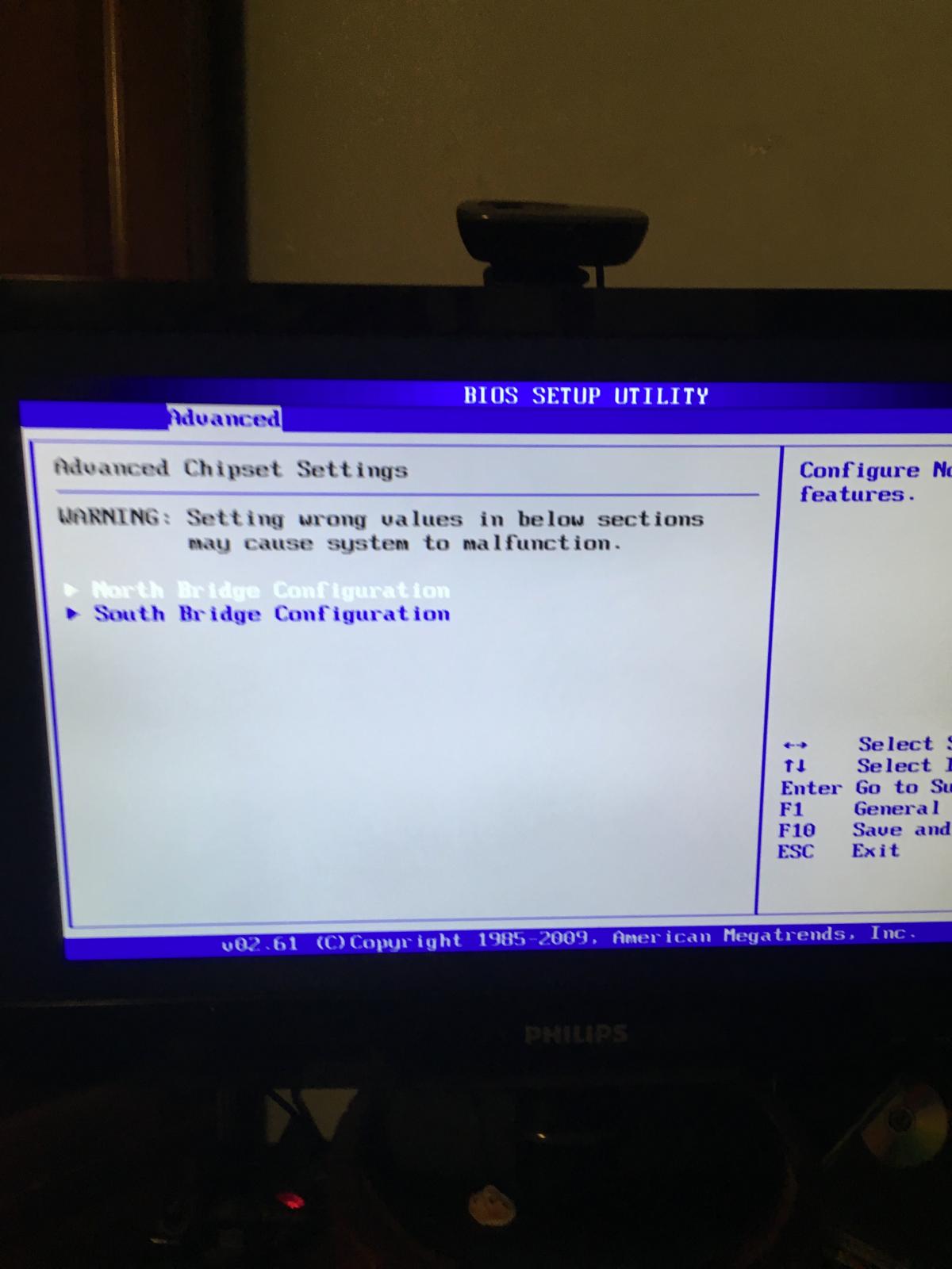

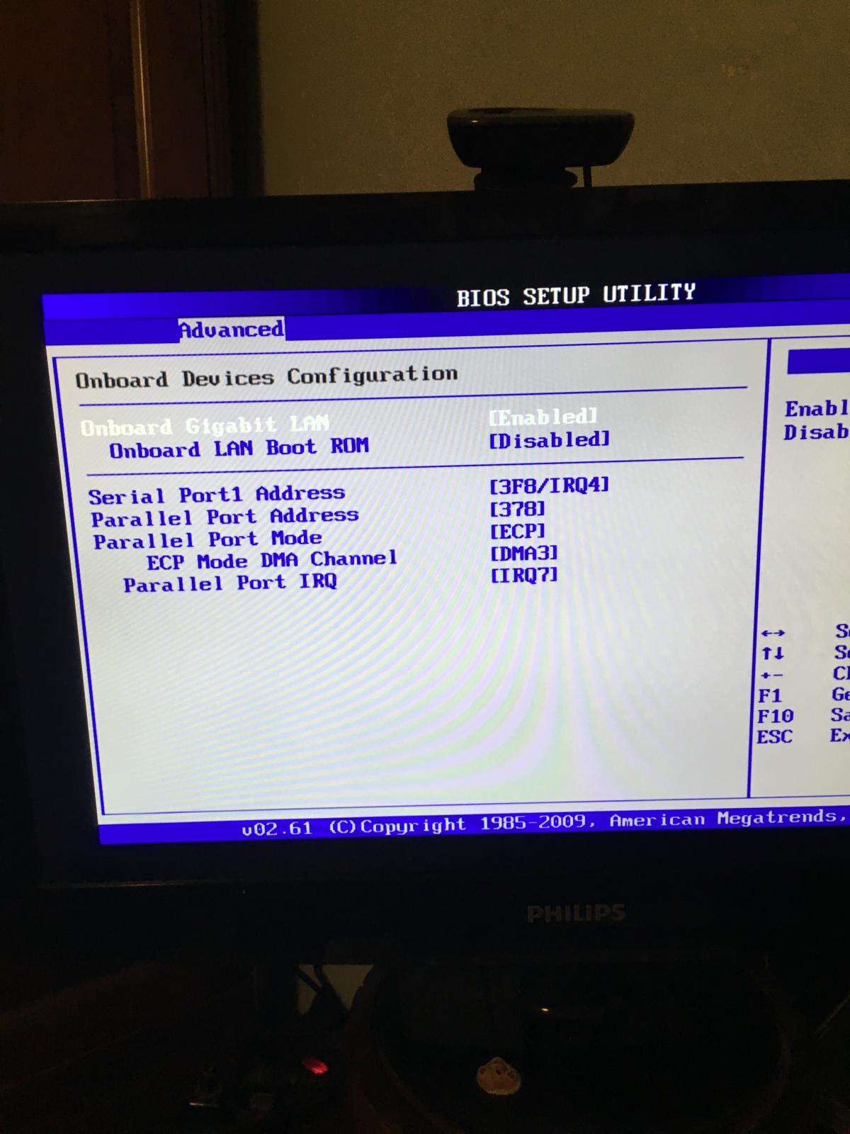

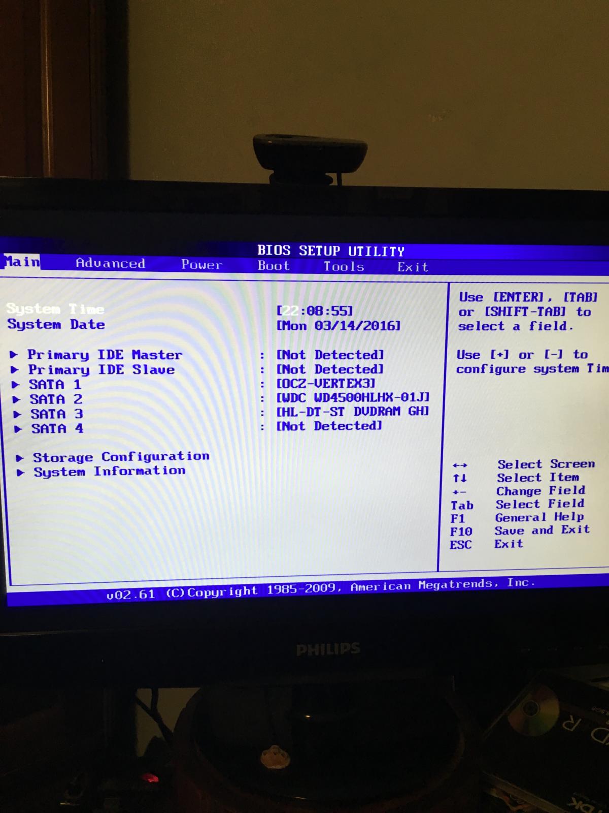

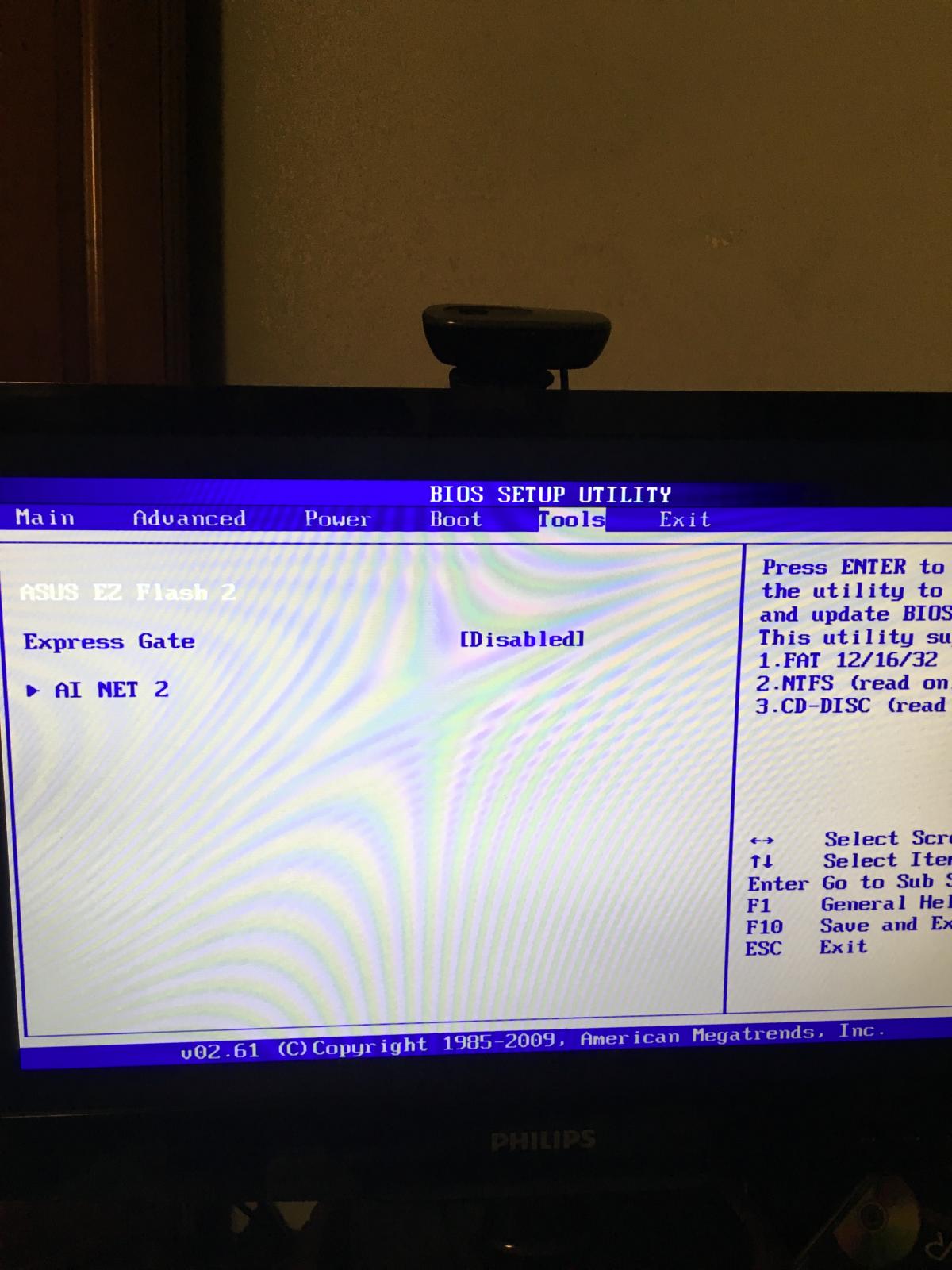

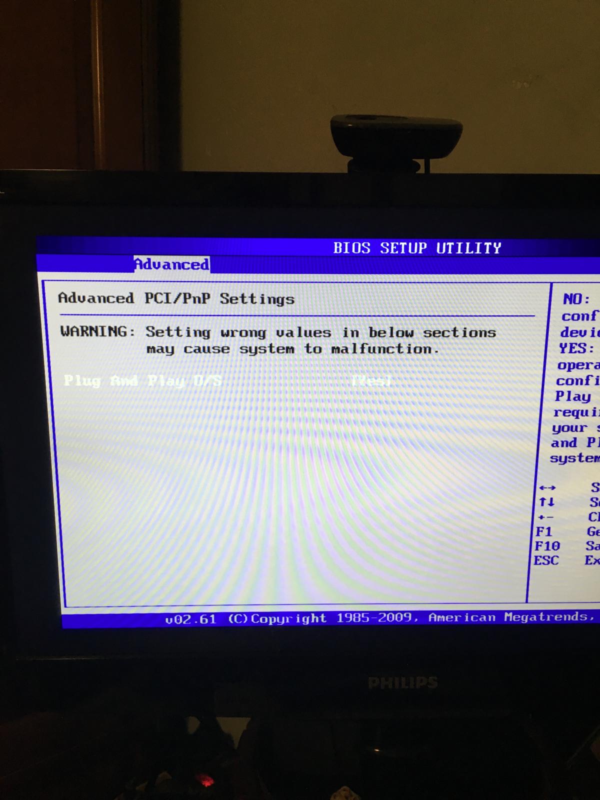

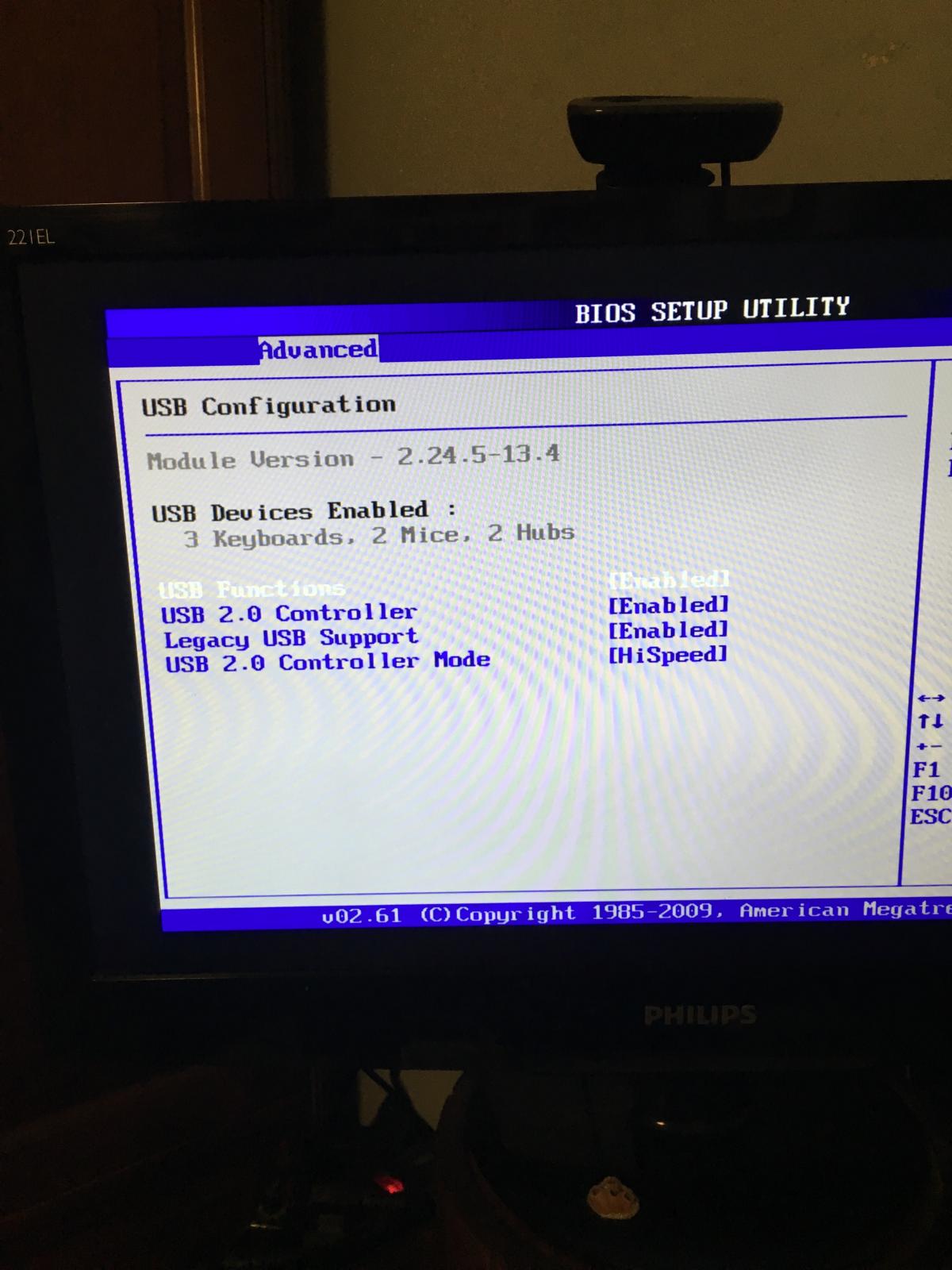

bedu71 Posted March 14, 2016 Share Posted March 14, 2016 these are my bios settingsbut I think you have to format hd in mbr.do not remember! ok hd format in gpt! ok hd format as gpt. Link to comment https://www.insanelymac.com/forum/topic/309035-guide-asus-p5g41t-m-lx-el-capitan-success/#findComment-2223913 Share on other sites More sharing options...
hackintosher Posted March 15, 2016 Share Posted March 15, 2016 Thank you bedu71. i cross checked every setting with these pics. all are the same. but still no luck. i will try formatting hdd as mbar this time. i wonder whats the problem with my laptop. both pc and laptop showing the same error. laptop supports efi. and tried vanilla installation in it. after first reboot clover not detecting laptop's hdd (just like in my pc). so is there any chance , the problem is with my clover? just a doubt. help me please. Link to comment https://www.insanelymac.com/forum/topic/309035-guide-asus-p5g41t-m-lx-el-capitan-success/#findComment-2223988 Share on other sites More sharing options...
