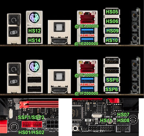

RenegadePC Posted February 1, 2016 Author Share Posted February 1, 2016 I think could be useful a thread where sharing the USB map. It will help the people to fix them! map.jpg Excellent idea. Has anyone started such a thread yet? Asus p8h61m lx2.i5 8gb ddr3 everything working less sleep wake up .. 4 monitors 2 from intel hd+2 from asus geforce210 1gb El capitan 10.11.2 socket 1155 Than you .... Have you attempted to fix sleep? Link to comment https://www.insanelymac.com/forum/topic/309007-el-capitan-workingnon-working-usb-motherboards/#findComment-2212250 Share on other sites More sharing options...
