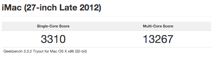

le0nardwashingt0n Posted October 28, 2015 Author Share Posted October 28, 2015 A quick update: So I ended up making the switch and it was pretty seamless. The board did arrive seemingly DOA but I flashed the bios and now it seems to be working without issue. Surprisingly windows 10 booted up immediately with the new board. I just removed and reinstalled the correct device drivers and that seems good. OS X was a little more difficult and as I don't have another mac it was a challenge to update the clover efi partition. Fortunately windows 10 recognized the clover efi I had on a usb drive (yay for keeping extras of those around!) and I was able to make some edits to the config.plist and update the .efi drivers and kext folders. Once that was done it was smooth sailing. I did end up flashing the bios with uefipatch for windows. I couldn't figure it out on os x and I couldn't find any documentation on how to use the software. With some searching I found a few comments in the forums but that was really about it. I got speedstep working very quickly after that PJALM has lots of DSDT patches for this and other ASUS boards. I found that USB doesn't work as well with 13,2 without DSDT edits and I had to switch to 14,2 for a bit. After renaming the USB devices in DSDT all of the USB ports again works in 13,2 but there's about a 5 second delay when booting (at the log in screen) until they work. So far I'm pretty happy with my mistake 1) Geekbench score is now 13267 and 2) Better fan control so it's much much quieter. I know this board is a little old at this point and well documented but if anyone has questions feel free to ask. I'd be glad to help out as much as I can. Does this board not have working NVRAM? I've had to install emuvariableuefi-64.efi and the rc scripts. Does anyone know if that is correct or am I missing something? I couldn't find much about that in some searches. Link to comment https://www.insanelymac.com/forum/topic/308951-ga-q77m-d2h-bios-dead-switching-to-asus-p8z77-m/#findComment-2183150 Share on other sites More sharing options...
