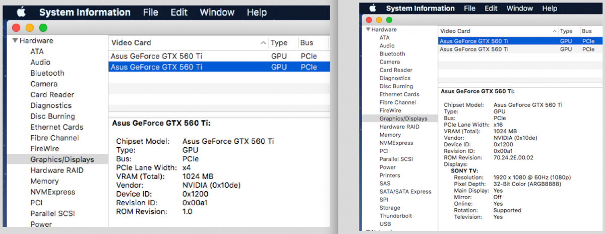

Freaky Chokra Posted November 1, 2015 Author Share Posted November 1, 2015 As I had said, here is my config.plist. Also included is my DSDT. BREAKING NEWS UPDATE!: Moreover, I got another Asus Direct CUII Nvidia 560Ti 1GB and am now using both in SLI mode and IT WORKS FLAWLESSLY!!! BOTH the cards are enabled and work without any problems. Regards, Freaky Chokra config_N_dsdt.zip Link to comment https://www.insanelymac.com/forum/topic/308347-asus-nvidia-560ti-1gb-black-blank-screen-after-installing-osx-1011-el-capitan/#findComment-2184332 Share on other sites More sharing options...
