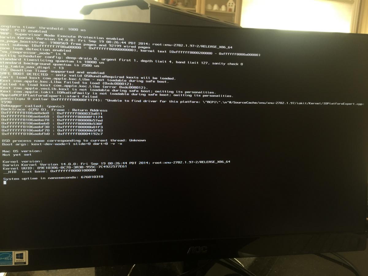

moomanjohnny Posted September 26, 2015 Share Posted September 26, 2015 Hey guys, recently I built a new computer rig. Everything is working great under windows on another hard drive, but when my Samsung EVO 850 came in I quickly got started on trying to get Yosemite on it. So I made a Clover install USB and plugged it into my computer. But when I try to boot the installer I get a kernel panic. Here's the specs of the computer: CPU: Intel Core i5 4690k (no overlock yet, running at stock speeds.) GPU: MSI Gaming 4G GTX 970 (removed for installation, read it on reddit somewhere) Motherboard: Gigabyte GA-Z97M-D3H RAM: Crucial 8gbx2 (Only one ram stick in for installation, again, read it on reddit somewhere) I have tried every single boot arg I could think of, and I need this up and running really quick because I am creating a video for my science teacher and I only have the Adobe suite for mac, so any help would be appreciated. Thanks, Johnny Link to comment https://www.insanelymac.com/forum/topic/308219-new-computer-build-kernel-panics-when-trying-to-boot-install-usb/ Share on other sites More sharing options...

Hangten Posted September 27, 2015 Share Posted September 27, 2015 <key>Arguments</key> <string>npci=0x2000 nvda_drv=1 kext-dev-mode=1</string> Try using this in your config.plist Did you, put the appropriate kext's in your Clover boot loader? What Mac model are you using in your simbios? Link to comment https://www.insanelymac.com/forum/topic/308219-new-computer-build-kernel-panics-when-trying-to-boot-install-usb/#findComment-2170595 Share on other sites More sharing options...
