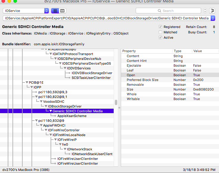

teolotec Posted March 18, 2018 Share Posted March 18, 2018 I have 2 laptop dv9700, dv2700. Both are same sd card reader RicohR5C822(1180,0822) and run Yosemite. Installed kext above dv9700 working perfectly however dv2700 not working. When I inserted the card its not showing. I've check the kext load in IORegistryExplorer though. Anyone know how to fix? Thanks Link to comment https://www.insanelymac.com/forum/topic/308169-workaround-for-ricoh-card-readers-on-yosemite-pci-laptop/#findComment-2604026 Share on other sites More sharing options...
