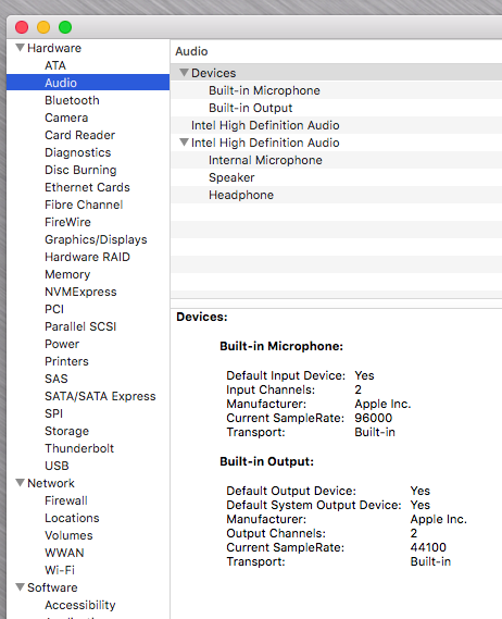

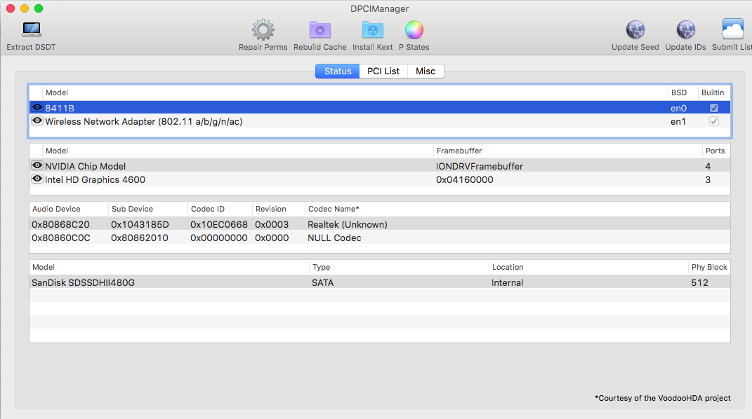

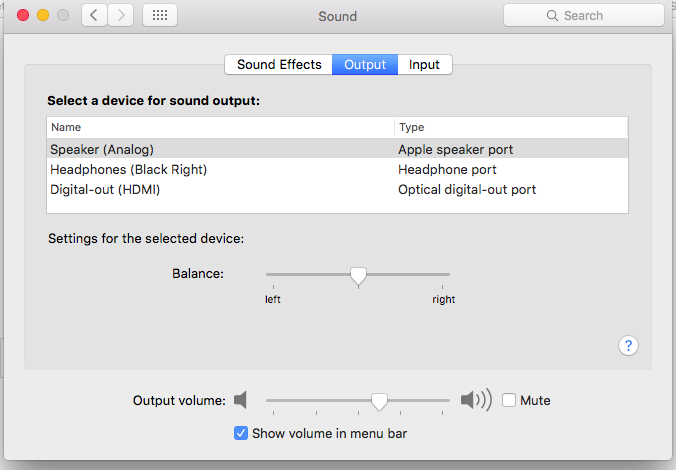

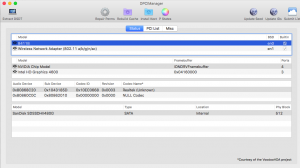

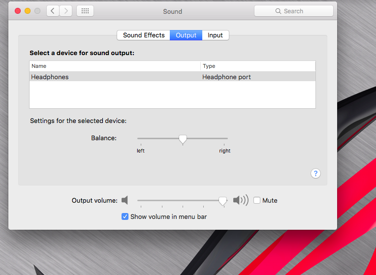

gulios Posted September 16, 2015 Share Posted September 16, 2015 Hi, This is my first post so welcome everybody. I have a problem with audio internal speakers sound in laptop ASUS G551JX-CN088H. As i read it needs ALC668 codec(DPCIManager doesn't show me this;(), so i've downloaded and installed AppleHDA-272.18.1-ALC668 and HDAEnabler3.kext from http://www.insanelymac.com/forum/topic/298663-applehda-for-yosemite/ After that sound is working only with headphones. When i pull out headphones's jack, audio changes to "internal speakers" and all controlrs works fine but no sound from speakers ;( This is dual boot installation(El Capitan GM candidate + WIN10 on the same SSD disk) and audio works fine in WIN10(so it's not hardware problem). I've checked Yosemite 10.10.5 and the same problem only with internal speakers, so it's not a problem with El Capitano beta version. Can you help my with this ? I've tried many other codecs and Voodoo solution without success. Link to comment https://www.insanelymac.com/forum/topic/308083-asus-g551jx-cn088h-internal-speakers-sound-problem/ Share on other sites More sharing options...

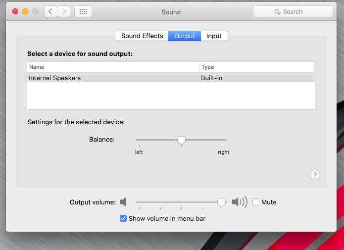

gulios Posted September 16, 2015 Author Share Posted September 16, 2015 Ok, i've tried VoodooHDA-v2.8.4.pkg and sound works fine(speakers + headpones). Weird thing is that when i reboot to WIN10 and next back to El Capitan audio speakers not work until i sleep OS X and wake it ;( Link to comment https://www.insanelymac.com/forum/topic/308083-asus-g551jx-cn088h-internal-speakers-sound-problem/#findComment-2168294 Share on other sites More sharing options...
