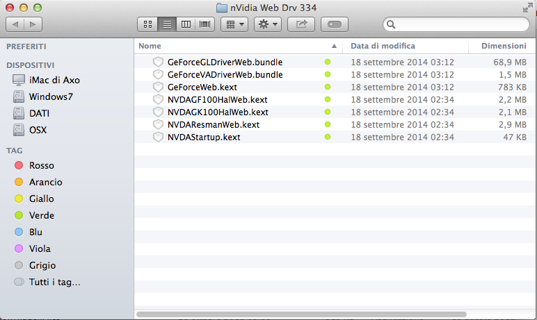

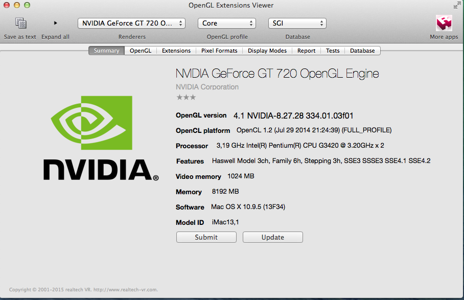

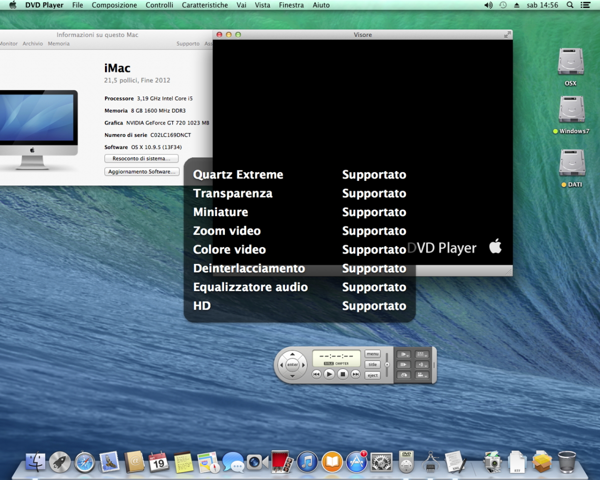

PippoX0 Posted September 19, 2015 Author Share Posted September 19, 2015 Eureka !! I got Qe/Ci with my nVidia Geforce GT 720 1 Gb , Here how to : 1) I have downloaded nVidia Web Driver for Mavericks 10.9.5 WebDriver-334.01.03f01.pkg from nVidia Website. 2) I have downloaded last release of Pacifist ( because pkg don't would install on my Pc) 3) I have extracted (Kexts and Bundles ) 7 files (only the ones needed) and i have installed with Kext wizard. 4) I have set Kernel boot flags nvda_drv=1 and have removed nv_disable=1 5) reboot and Enjoy Full Accelerated GPU See Ya PippoX0 P.s. I'm using a VGA monitor so i have injected in DSDT the EDID for proper working ... Link to comment https://www.insanelymac.com/forum/topic/307916-ga-h81m-hd3-and-intel-g3420/#findComment-2169026 Share on other sites More sharing options...
