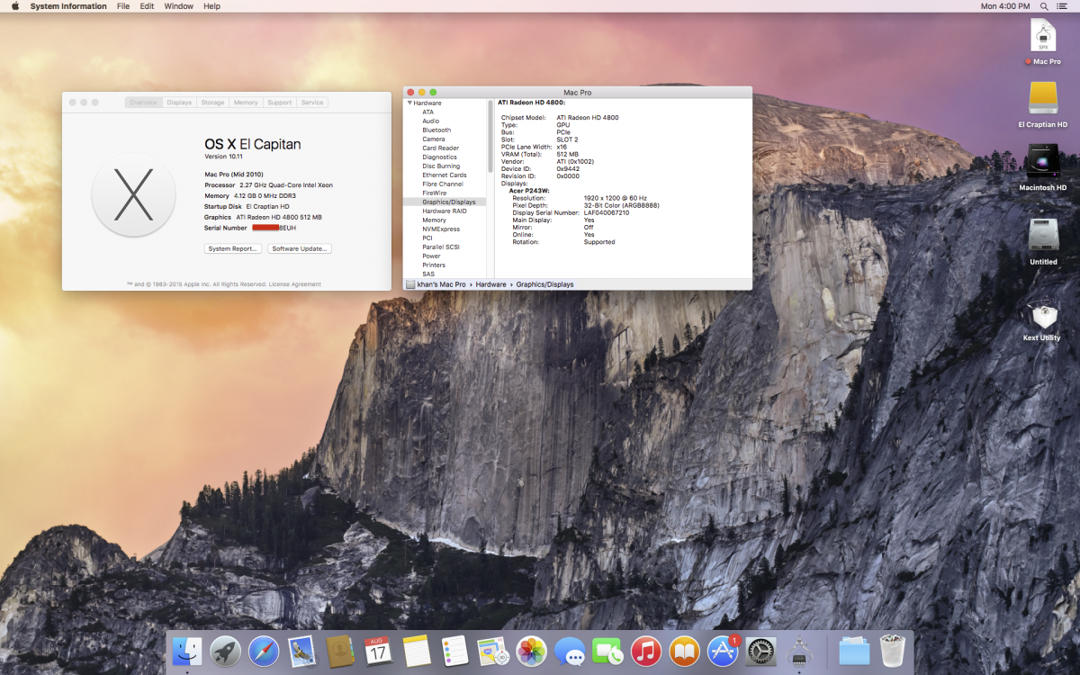

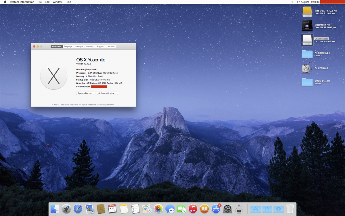

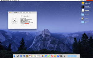

Rocky12 Posted August 21, 2015 Author Share Posted August 21, 2015 Hi Guys Sorry for my late reply Chris 1111 u are the best and i did it again successfully installed El Capitan and Yosemite with all of your help im Really thankful to u and ur help This is the final Result El Capitan on HP Z800 Yosemite on HP Z800 Thanks Chris1111 for your Best Installer Thanks Voodoo Team for the Best Bootloader Thanks ErmaC for your hard work 1 Link to comment https://www.insanelymac.com/forum/topic/307480-osx-1011-el-capitan-dp1-kernel-panic/#findComment-2162316 Share on other sites More sharing options...
chris1111 Posted August 21, 2015 Share Posted August 21, 2015 Hi Guys Sorry for my late reply Chris 1111 u are the best and i did it again successfully installed El Capitan and Yosemite with all of your help im Really thankful to u and ur help This is the final Result El Capitan on HP Z800 Yosemite on HP Z800 Thanks Chris1111 for your Best Installer Thanks Voodoo Team for the Best Bootloader Thanks ErmaC for your hard work WOW You did the great job Congrats I am really happy for you 1 Link to comment https://www.insanelymac.com/forum/topic/307480-osx-1011-el-capitan-dp1-kernel-panic/#findComment-2162319 Share on other sites More sharing options...

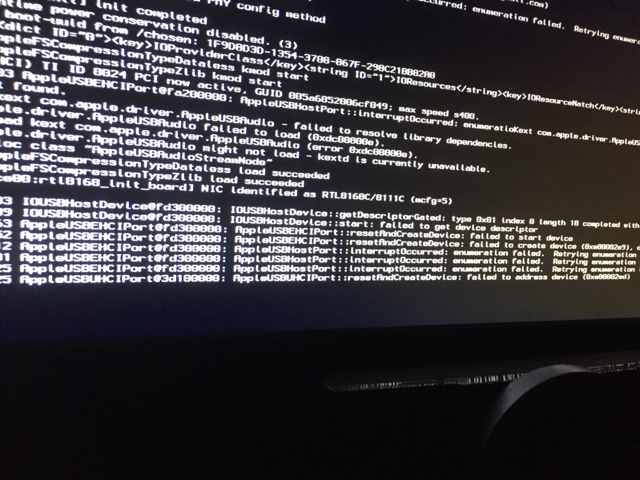

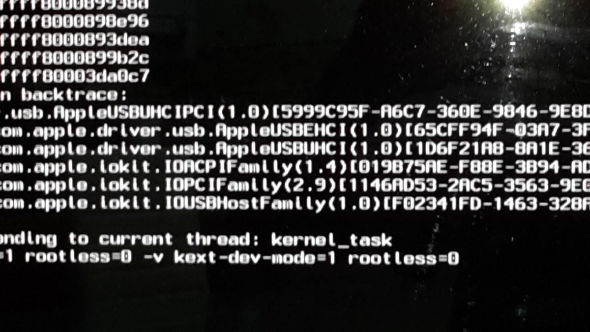

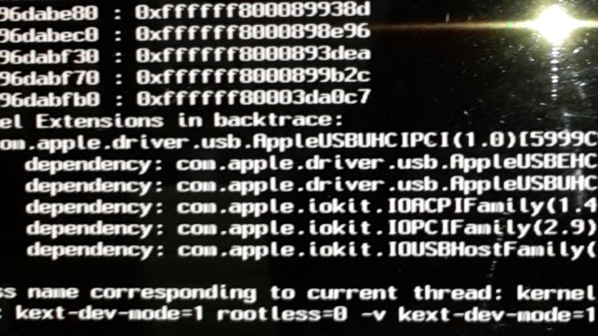

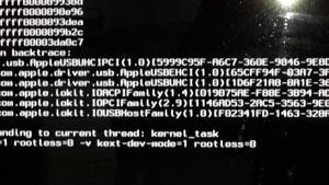

iceage2609 Posted August 28, 2015 Share Posted August 28, 2015 Hi Chris1111, i followed your great tutorial and chameleon package for el capitan. Thank you. I manage to boot from the usb stick with -f , install el capitan to my hard drive , reboot and run the script again to install chameleon to my new partition but after the reboot i can't boot in :-( Flags -v rootless=0 ( i think it includes kext-dev-mode flag) It hangs on this message, any clue? Link to comment https://www.insanelymac.com/forum/topic/307480-osx-1011-el-capitan-dp1-kernel-panic/#findComment-2164011 Share on other sites More sharing options...
chris1111 Posted August 28, 2015 Share Posted August 28, 2015 Hi Chris1111, i followed your great tutorial and chameleon package for el capitan. Thank you. I manage to boot from the usb stick with -f , install el capitan to my hard drive , reboot and run the script again to install chameleon to my new partition but after the reboot i can't boot in :-( Flags -v rootless=0 ( i think it includes kext-dev-mode flag) It hangs on this message, any clue? ImageUploadedByTapatalk1440772574.257871.jpg What is your complete Specs ? Link to comment https://www.insanelymac.com/forum/topic/307480-osx-1011-el-capitan-dp1-kernel-panic/#findComment-2164017 Share on other sites More sharing options...
iceage2609 Posted August 28, 2015 Share Posted August 28, 2015 What is your complete Specs ?Intel i7 920 LGA1366Ga x58 ud3r Corsair 10GB (2+2+2+4) Crucial SSD M500 ( yosemite installed there ) WD 750 GB caviar ( Maverics installed) And a usb 160 GB external for test installations like capitan. When everything is stable i will install it in Crucial. Nvidia GTX 285 1GB gainward Apple trackpad bluetooth connected Microsoft mouse Link to comment https://www.insanelymac.com/forum/topic/307480-osx-1011-el-capitan-dp1-kernel-panic/#findComment-2164023 Share on other sites More sharing options...
chris1111 Posted August 28, 2015 Share Posted August 28, 2015 Did you Flag GraphicsEnabler=Yes Link to comment https://www.insanelymac.com/forum/topic/307480-osx-1011-el-capitan-dp1-kernel-panic/#findComment-2164028 Share on other sites More sharing options...
iceage2609 Posted August 28, 2015 Share Posted August 28, 2015 Did you Flag GraphicsEnabler=Yes Yes, without that i get black screen.I am using DSDT.aml as well, from my experience,my Hackintosh doesn't boot without that. I post that image in case this is a known issue or a common chameleon bug.I assume it's not. Pitty i can't boot because i really get the feeling that its a small detail that holding me back from getting there. I will check if i can remove a kext or find a way around. The image error has something to do with a kext , maybe with a hardware part or is it just a random error? Link to comment https://www.insanelymac.com/forum/topic/307480-osx-1011-el-capitan-dp1-kernel-panic/#findComment-2164058 Share on other sites More sharing options...
chris1111 Posted August 28, 2015 Share Posted August 28, 2015 Try whitout dsdt Link to comment https://www.insanelymac.com/forum/topic/307480-osx-1011-el-capitan-dp1-kernel-panic/#findComment-2164070 Share on other sites More sharing options...
iceage2609 Posted August 28, 2015 Share Posted August 28, 2015 Try whitout dsdtSuccess, as I said before without the dsdt it doesn't boot, so that didin't work out. Then I tried the flag USBBusfix=Yes and another usb port, not in the front panel of my pc but in the back and.... I am in !! Thanks a million for the guide and everything Chris P.S : not know what the issue was or if it will come up again but happy that am in for now :-) 1 Link to comment https://www.insanelymac.com/forum/topic/307480-osx-1011-el-capitan-dp1-kernel-panic/#findComment-2164092 Share on other sites More sharing options...
