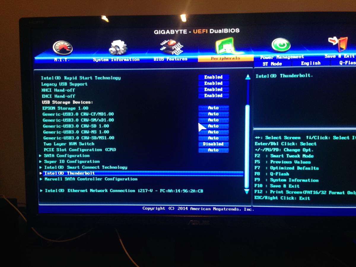

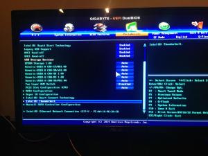

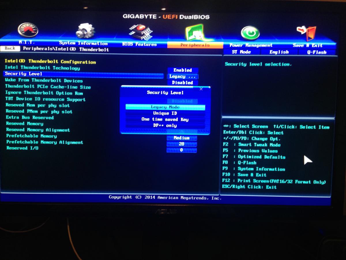

blackswan22 Posted August 29, 2015 Author Share Posted August 29, 2015 In a follow up I was finally able to get Thunderbolt to work. No windows system or drivers are needed, you just need to go into the setup and under the Peripherals> Thunderbolt> options switch the Thunderbolt security level to Legacy mode. You also have to have the Thunderbolt drive plugged in before bootup, as that is the only way it will recognize the drive. I also disabled the wake from Thunderbolt devices option. Perhaps this talk of installing windows and the windows drivers on a dual boot system would also make them hot-swappable, but accessing the TB ports this way is totally fine with me. This was the last component I needed to get working, so as of now everything in my system is fully functioning! Link to comment https://www.insanelymac.com/forum/topic/307320-stuck-on-yosemite-1010-install/page/3/#findComment-2164148 Share on other sites More sharing options...

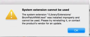

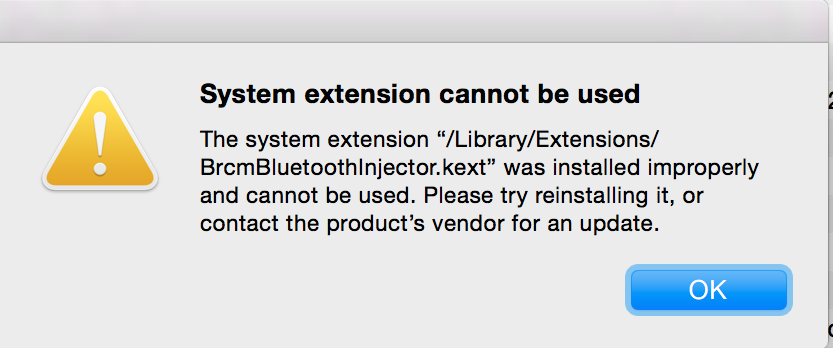

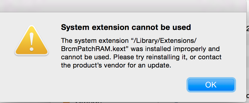

blackswan22 Posted September 19, 2015 Author Share Posted September 19, 2015 Ok just did that. When I did that it mentioned that the two bluetooth patch kexts were installed improperly. Do I need to remove those? Link to comment https://www.insanelymac.com/forum/topic/307320-stuck-on-yosemite-1010-install/page/3/#findComment-2168933 Share on other sites More sharing options...
TheRacerMaster Posted September 19, 2015 Share Posted September 19, 2015 Can you post full output of the command? Link to comment https://www.insanelymac.com/forum/topic/307320-stuck-on-yosemite-1010-install/page/3/#findComment-2168935 Share on other sites More sharing options...
blackswan22 Posted September 19, 2015 Author Share Posted September 19, 2015 Here is what came up. Link to comment https://www.insanelymac.com/forum/topic/307320-stuck-on-yosemite-1010-install/page/3/#findComment-2168941 Share on other sites More sharing options...

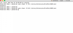

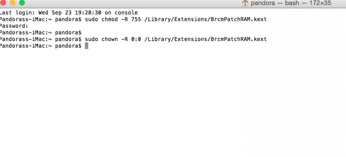

TheRacerMaster Posted September 19, 2015 Share Posted September 19, 2015 Here is what came up. Since you're still on Yosemite, remove BrcmBluetoothInjector, it won't do anything useful (BrcmPatchRAM works fine). You need to fix the permissions of BrcmPatchRAM as well, which you can do like this: $ sudo chmod -R 755 /Library/Extensions/BrcmPatchRAM.kext $ sudo chown -R 0:0 /Library/Extensions/BrcmPatchRAM.kext 1 Link to comment https://www.insanelymac.com/forum/topic/307320-stuck-on-yosemite-1010-install/page/3/#findComment-2169059 Share on other sites More sharing options...
blackswan22 Posted September 19, 2015 Author Share Posted September 19, 2015 Ok thanks. I threw out the bluetooth injector file. Hmmm... The first command I enter prompts me to type in my password but then nothing else in terminal happens after that. The second one I don't think did anything (at least didn't show anything happened in terminal), it just went to a fresh command line. Startup is still slow, so I'm not sure if the patch took effect. Link to comment https://www.insanelymac.com/forum/topic/307320-stuck-on-yosemite-1010-install/page/3/#findComment-2169123 Share on other sites More sharing options...

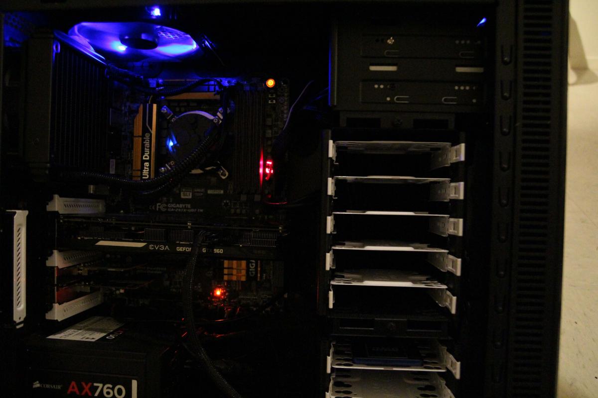

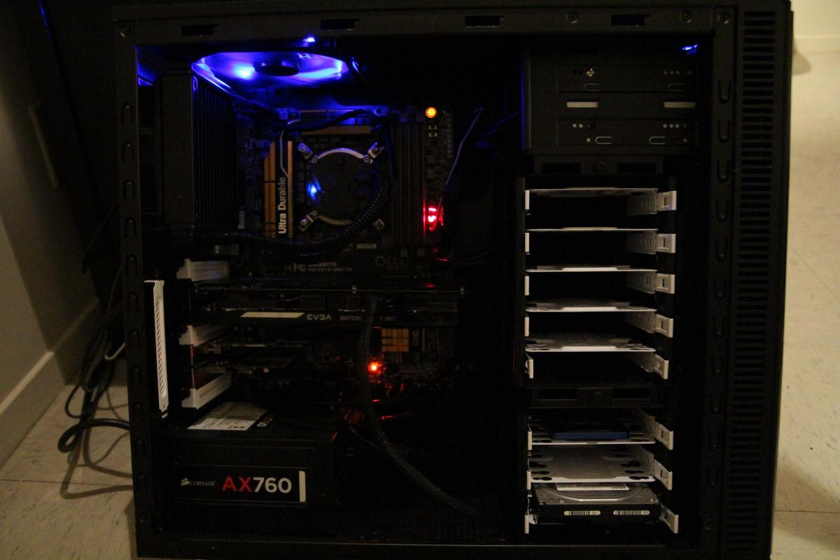

blackswan22 Posted July 12, 2016 Author Share Posted July 12, 2016 Here are some pics of my final build. Sorry it took so long to post these. Thanks to all who helped troubleshoot the process!! Fractal Design R4 Case Gigabyte GA-Z97X-UD7 TH LGA 1150 Z97 Dual Thunderbolt 2 ATX Motherboard (Bios Version F4) Intel i7 4.4 4790K Quadcore Processor Cooler Master Seidon 120M Crucial Ballistix Tactical 32GB (8GBx4) DDR3-1600 PC3-12800 UDIMM RAM EVGA GeForce GTX 960 SSC ACX 2.0+ Corsair AX760 Professional Series Power Supply TP-LINK TL-WDN4800 Dual Band Wireless N900 PCI Express Adapter System HD: OWC Extreme Pro SSD 240GB Storage HD: Hitachi Deskstar 4TB 7200RPM Monitor: Philips BDM4065UC 40" Class 4K Monitor UHD 3840 x2160 The Alesis audio monitors and Avid Fast Track Duo box I already had from my prior system. The Fractal R4 is a huge case, but eventually I am going to install a RAID with the extra HD bays. Link to comment https://www.insanelymac.com/forum/topic/307320-stuck-on-yosemite-1010-install/page/3/#findComment-2251485 Share on other sites More sharing options...
