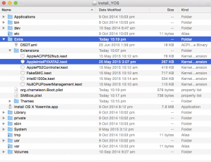

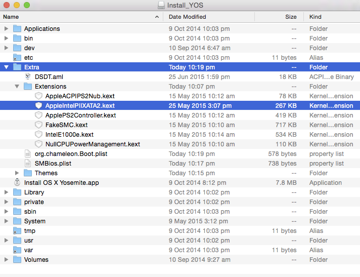

fusion71au Posted July 8, 2015 Share Posted July 8, 2015 @lizbeth, IMHO, the best way to learn hackintosh is to manually create your own installer using the Vanilla Install Guide. Too many noobs use automated installers before they learn the basics and hence run into problems since these installers use generic configurations that won't work for all machines. If you google "Dell Optiplex 755 Yosemite", you'll find a few useful guides on how to overcome the incompatible AHCI problem in Yosemite: After you have created your Yosemite USB installer, 1. Replace the /Extra folder on the installer with the attached /Extra folder from the Optiplex 755 Chameleon bootpack from OSX Latitude (contains AppleIntelPIIXATA2 in /Extra/Extensions). 2. Set the SATA operation in your BIOS to RAID on ATA or Legacy (not AHCI in this case). 3. Boot your computer with the USB installer in verbose mode without caches (-v -f) and install OSX on the hard drive. 4. Install Chameleon on your hard drive and copy the /Extra folder from your USB installer to the root of your Yosemite installation. 5. Post Install: Transfer kexts from /Extra/Extensions and install in /System/Library/Extensions with Kext Wizard or Kext Utility. You need to patch AppleRTC.kext to prevent the BIOS/CMOS resets you were having in post#11- see guide here. Good Luck! Extra_Optiplex 755.zip 3 Link to comment https://www.insanelymac.com/forum/topic/306991-yosemite-installer-not-recognizing-internal-sata-drive/#findComment-2151692 Share on other sites More sharing options...
owbp Posted July 8, 2015 Share Posted July 8, 2015 will mountain lion upgrade to yosemite? Don't do that, clean install is always better. I'm just mentioning ML because you only need FakeSMC.kext for the installation. AppleIntelE1000e for LAN and AppleRTC for CMOS reset afterwards, but thats minimum amount of kext for any installation (i'm using usb sound card). With Mavericks and Yosemite you have SATA trouble and more kext = less vanilla installation. Just follow Fusion71au's guide above. Don't use DSDT and delete it from chameleon.boot.plist, and there is no need for NullCPUPowerManagement with Optiplex 755. 2 Link to comment https://www.insanelymac.com/forum/topic/306991-yosemite-installer-not-recognizing-internal-sata-drive/#findComment-2151774 Share on other sites More sharing options...
