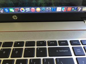

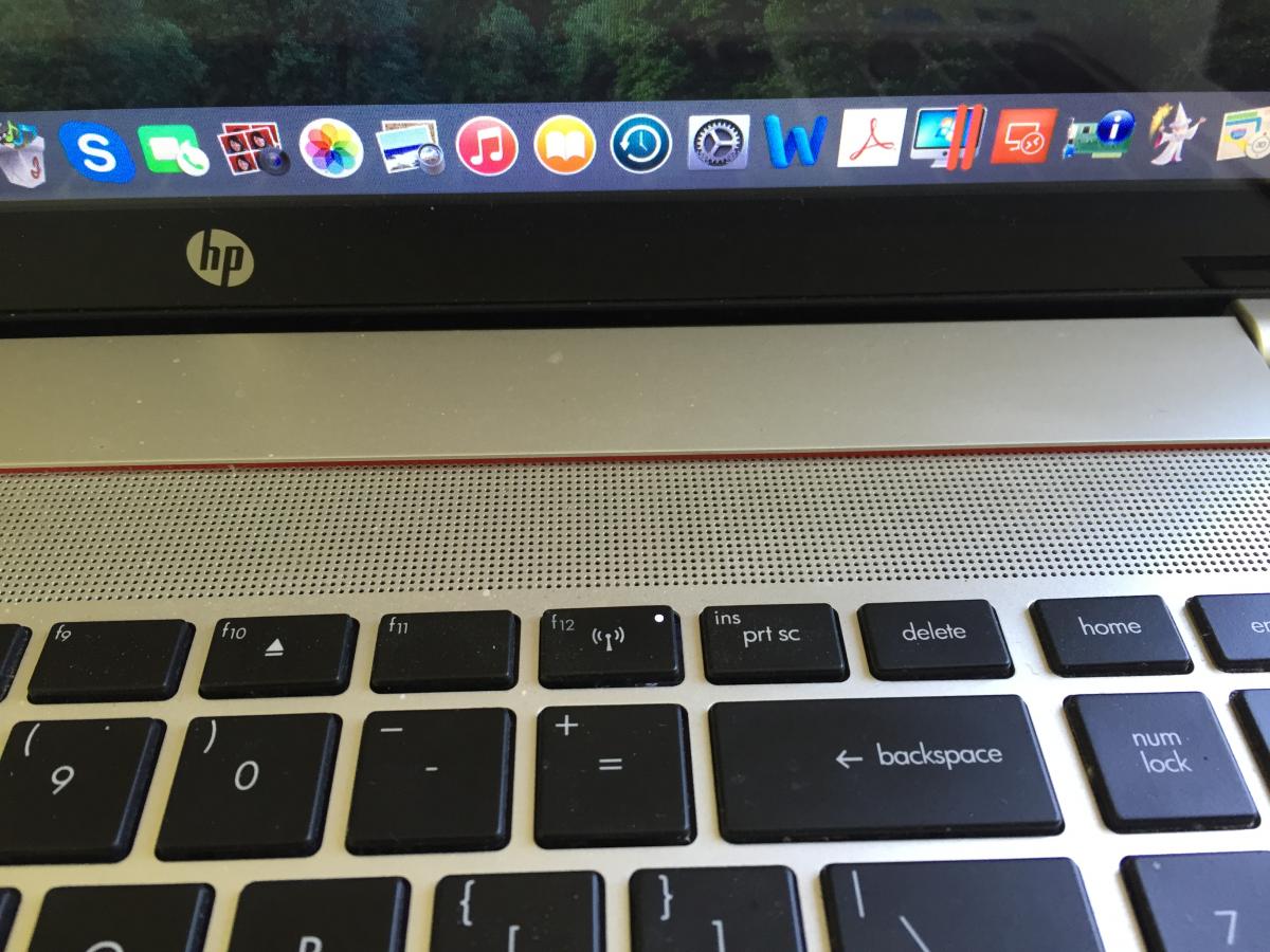

I just replaced my wifi card with the Azurewave AW-CE123H wifi/bt combo card.  My laptop has separate slots for wifi and BT.  For the first time, I saw 2 BT devices in my system info. I figured I only needed/wanted one so I took out the BT card from its own separate slot.  Upon rebooting, I still had wifi and BT from the new combo card and I also had a surprise -- the LED indicator for wifi changed from amber to white, as it is supposed to do.
