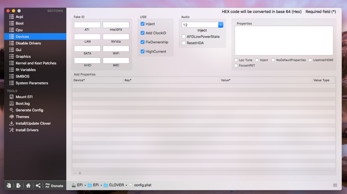

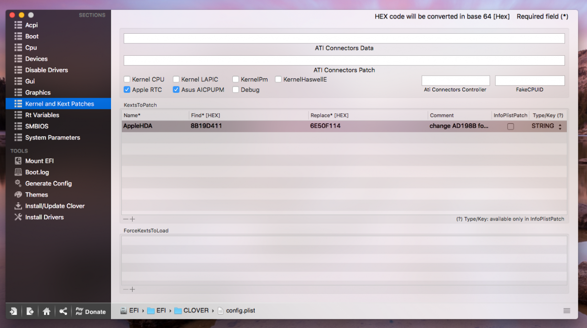

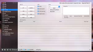

This is my current DSDT & clover settings as of now. HDMI works now but no audio. Might be related but onboard audio works intermittently across reboots.
AppleHDA is patched on the fly with Clover EFI and an "injector kext" with the layout XML's.
Also, just tried injecting audio via DSDT layout-id 0xC in HDEF instead of clover EFI injection and it's still intermittent.
